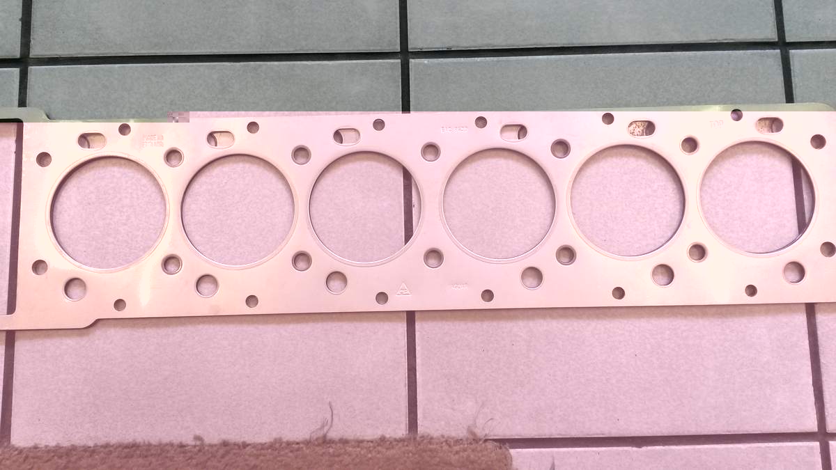

Regardless of the above, I found that when driving the car for extended periods of time (on hot days), the temp would still climb to L and above.
Somewhat embarrassing to admit this but it turns out that I installed HE head gaskets into this pre-HE engine. To my defense, it never occurred to me that the gasket set, correctly ordered from SNG as for pre-HE might contain the wrong gaskets, and thus I never thought to check.
The position of coolant ports on the pre-HE heads differ from the HE heads and fitting the HE gaskets to pre-HE heads result in the coolant ports on the outside of each head being partially obstructed by the HE gaskets. This leads to reduced coolant flow and hence higher temperatures.
In the picture below you can see the HE gasket on top of the pre-HE gasket and how the coolant ports:
Best Regards
