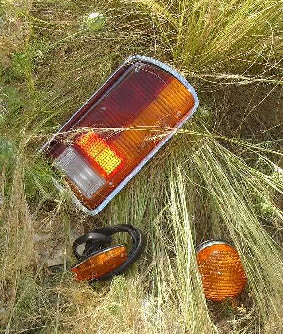

mgcjag wrote:Hi Peter.......Interested in you Rear light info but never seen the Lotus light conversion (do you have a photo?) also what are Clam shells? thanks Steve
The Lotus Elan used parts from various production cars (the front indicators and sidelights are off an Aston Martin DB5, for example) and the rear light cluster's were from the S2 E-Type parts bin, used up side down.
Lotus modified them slightly to include the reversing lights so using a pair allows you to tidy up the rear of the S2 by dumping the separate ones. This allows a rectangular number plate to be fitted and S1 resonators. The 'clam shells' are the chrome finishers which wrap around the light clusters which you can also leave off along with the stainless flat panel.
Clam shells are the chrome finishers on each side blending the lamp cluster to the body. They aren't a bad item but they stick out and make the back end look wider by drawing some attention to the lamps.
Odd that we can't post pics here - you'll have to PM me.
The Lotus lamps are different and rather than being a raid on Jag's bin I think they were just a variation on a theme. The Jag is the raider if anything, because the Jag bases have provision for the reversing lights which is not drilled for the bulbholder and reflector, so it is a cheap imitation of the Lotus rather than vice versa IMHO. The lenses are the same except Lotus specified a clear insert in one of the slots where Jag asked for a reflector. Technically you could try putting a clear ribbed lens in there and knocking out some kind of bulb holder of your own design.

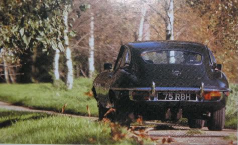

Nick wrote:There must have been a US lighting requirement that forced Jaguar to go with the separate reversing lights. Surely they wouldn't have made another tailpipe variant and lived with the rather messy (IMHO) rear detailing if they could have avoided it by putting the reversing lights in the lamp clusters.
Nick L.
Who knows? The rot set in with bumper requirements AFAIK. The height was specified and I think they had to be continuous, or Jag thought it made sense in the land of 'touch parking'. From the repositioned bumper issue sprang the numberplate space restriction, requiring a two-row square plate. When I went to single0row I had to get a special one made with slightly closer character spacing to fit the space. The numberplate format is what dictated the splayed pipes so once you go single-row you can revert to Series 1 resonators. I was thinking of using a Series 1 reversing light instead of the twin Lotus ones but the boot floor doesn't have the dent you need to accommodate the S1 light unit.

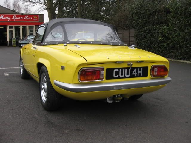

You will find it very difficult to source the original Lotus rear light sets. Unlike E-Type's the Lotus Elan is not well served by repro parts suppliers. You could try Paul Matty Sportscars http://www.paulmattysportscars.co.uk/Parts.aspx or Susan Miller http://www.mickmillerlotus.com/parts-lighting.html who may be able to help.
Part numbers are MRLA050BR and MRLA050BL and cost about ?150 each. You may be able to buy just the lenses for less.

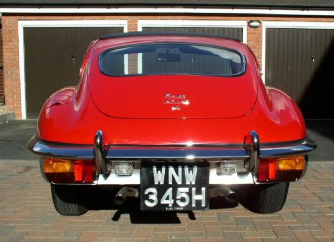

Post by Heuer » Fri Dec 31, 2010 12:46 pm
Pete posted this picture of his car on Jag-Lovers so I thought I would snag a copy and link it here to complete the thread. The modification looks really good IMHO:
Any more pictures Mr Crespin?
