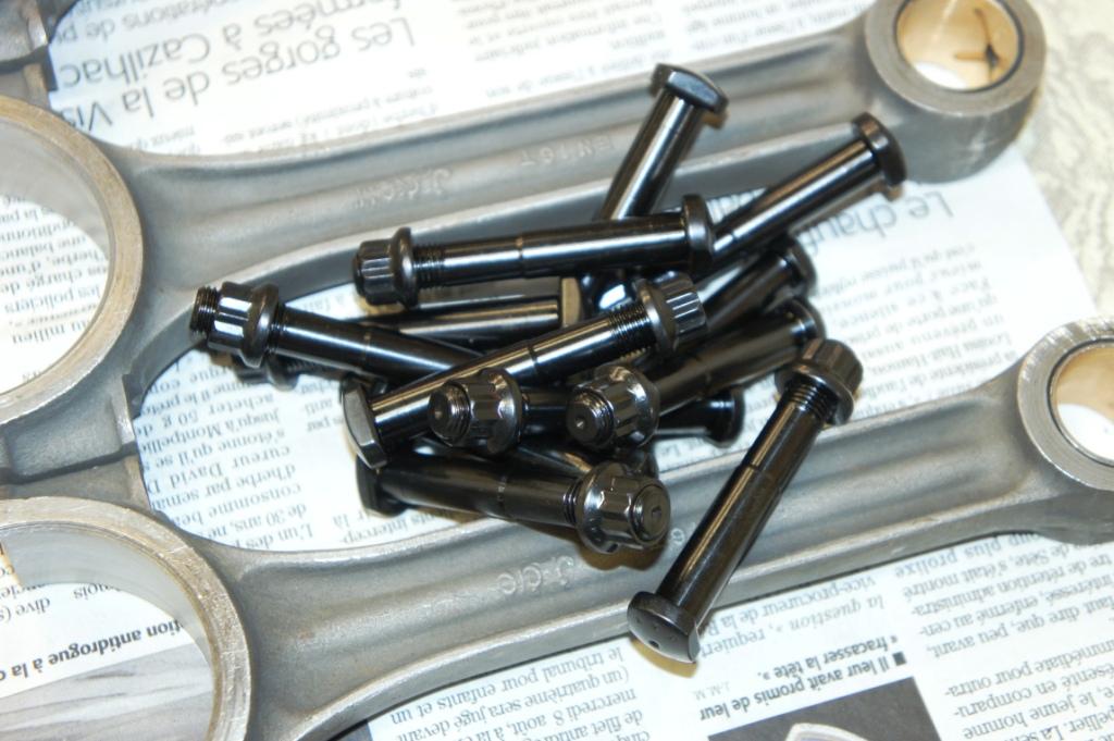

Indeed, yes, this is what my "missing" new set of bolts looks like now it has turned up.
No apology or regrets.

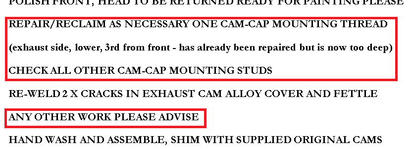

This was the written brief I gave them.
This was the relevant section of the invoice :

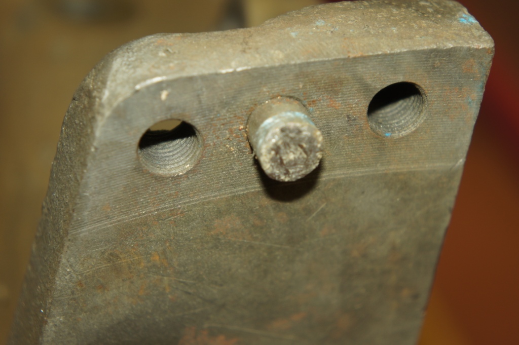

The cam-cover would not sit over the studs correctly, as one of the studs sat too high, so the 5/16" shoulder was stopping the cover from seating.
So, having paid £450 plus VAT for the assembly of a head that was "ready-to-fit", it was time to strip the caps off and get the cams out.
(I used to do this for a living, and have the kit and the know-how - but how does the disappointed enthusiast in his lock-up, and with his Halfords tool-kit, cope ?)

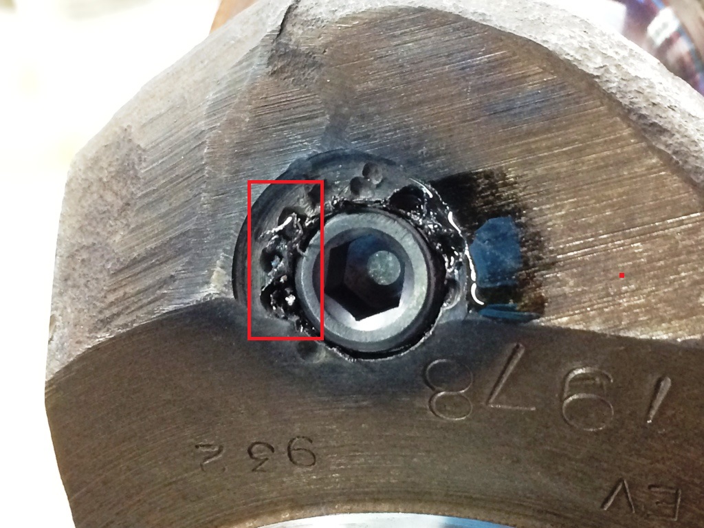

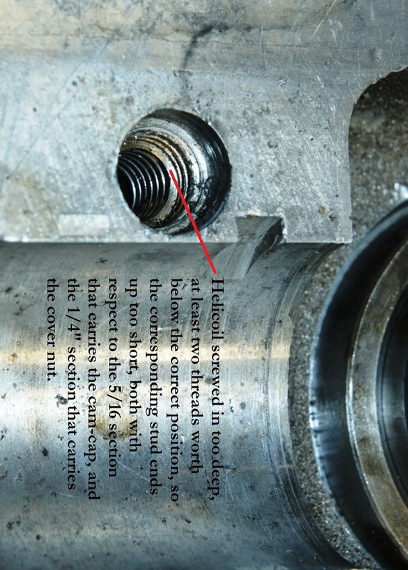

It turns out that one of the cam-post Helicoils is not threaded deep enough into the head, so the stud is effectively too long.
This is what a correct-depth Helicoil should look like.
Then I noticed that the very Helicoil I had specifically mentioned on the job-sheet as being too deep, and needing replacement, had not been touched at all ................

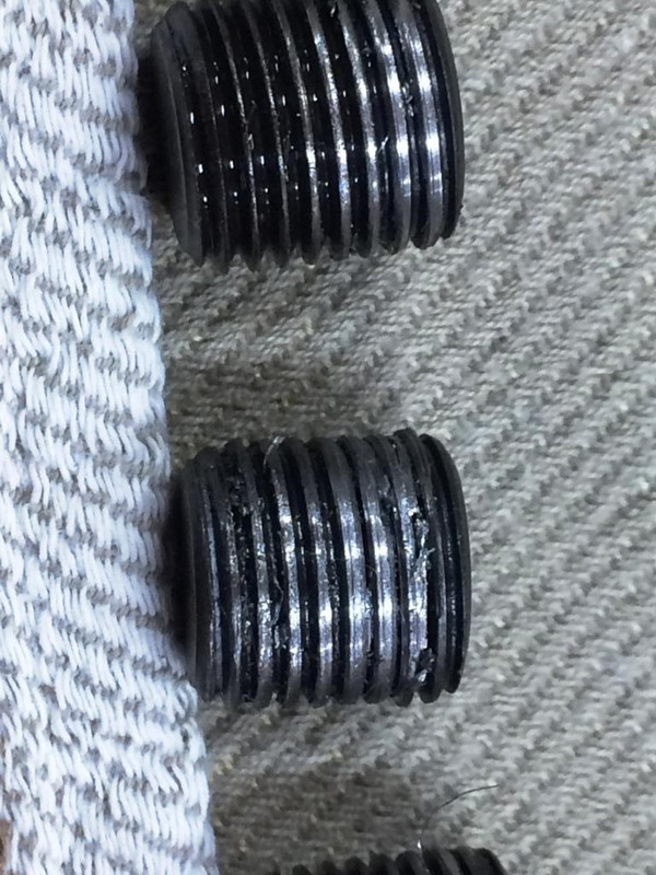

Examination of the parts I'd removed threw up this gem - several of the studs were actually quite bent :
Remember this ?
CHECK ALL CAM-CAP MOUNTING STUDS ? ANY OTHER WORK PLEASE ADVISE ?
Words fail me.

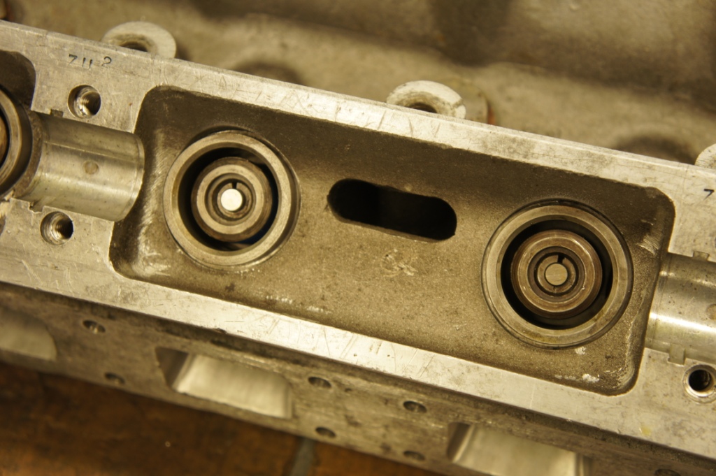

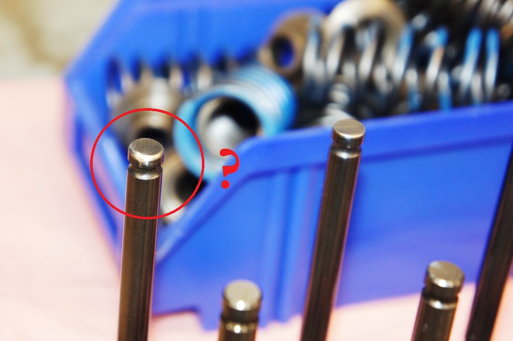

Not a single drop of oil apparent anywhere on the buckets, under the buckets, on the shims, on the valve-heads - zilch ; this "ready to fit" cylinder head was going to do all its start-up with zero lubrication around the bucket-shim-valve interface because some idiot was too lazy to use an oil-can.
Remember, you think you're dealing here with an industry-reference blue-chip machining and engine-building company in the heart of the Midlands, whom when I visited had engines, including many XK's, Astons, Ferraris, with names on from all the big-name car-restorers in the UK.
Valve clearances ? Set at 10 thou exhaust, 8 thou inlet - yet Guy Broad, who in fact supplied them the cams, specifies 10 thou for both.
Valve shims ? These cost, retail, £5 a pop with VAT.
So for the engine builder, twelve new ones will actually cost him less than £40 - on a job that cost me around £10.000 - and using twelve good used ones might be judged to add £20 ?
Wouldn't it be reasonable, then, to expect something else than this ?

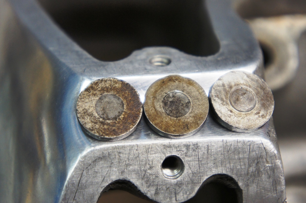

Rusty and worn - I don't mean used, I mean worn - shims ?
The right-hand one here has even actually been re-ground at some time.
Oh, and whilst we're at it let's check for valve seating ?
Funny that, eleven of the twelve withold thinners no problem, one of the exhaust valves leaks ........
Valve out - hang on, never seen that before ; NOT A DROP OF OIL PRESENT ON THE STEM OR THE GUIDE.
Graphogen engine-building compound ? Forget it.
Of all the engine-builders' I've ever assisted, none would ever have assembled an un-oiled valve in a guide.
Just how awful can these people be ? Read on, it gets worse ...........
(The leak ? - no sweat, just a bit of swarf trapped on the seat face - quick re-grind and all is OK).

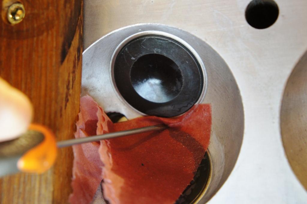

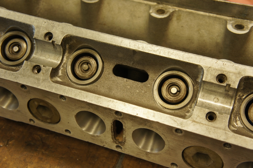

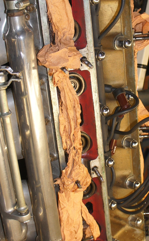

Whilst working on the head, I noticed that both cam-cover seating areas on the head were quite rough, with sharp-feeling scratches, which suggests they were very recent - as 1) I would have noticed them when cleaning off old gaskets, when doing the shimming, in the past, and 2) they would have no longer been sharp-edged if I'd scraped off and scotch-brited the gasket surfaces, in the past.
The pattern and type of scratching is similar on both inlet and exhaust sides.
It so happens I have a picture of the inlet-side of the head surfaces from the last time I had the cam covers off - and there is not a mark on them.
Here you have the head "before" confiding it to our famous blue-chip engine specialist :
And here you have it "after" : it's quite difficult to focus, but of you blow the shot up you'll get the drift - these are deep scratches.
And to prove that they are at least systematically - and symmetrically - cack-handed, here is the exhaust side "after" :
My conviction is that this damage was done either by dragging the head across some supporting structure either on a milling machine when working on the valve-seat housings, or whilst working on the ports during inlet-manifold matching.
So a head that has survived Lord-knows how many rebuilds in the last 56 years, including at least one in the hands of VSE in Wales, whose work was openly sneered at by our friends who worked on my engine this time, has finally met its match with a bit of couldn't-give-a-damn treatment.
I wonder if it was the same idiot that dragged the block across a concrete floor, and damaged the four dowels on the back face ?

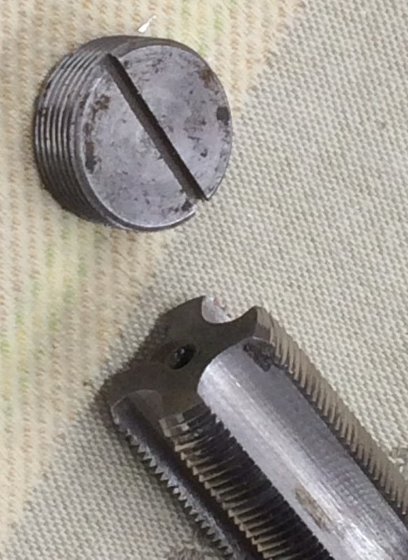

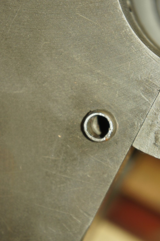

The same feckless guy that couldn't be bothered to take out the last core plug from the block when getting it ready for acid-dipping ?

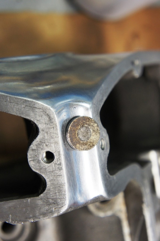

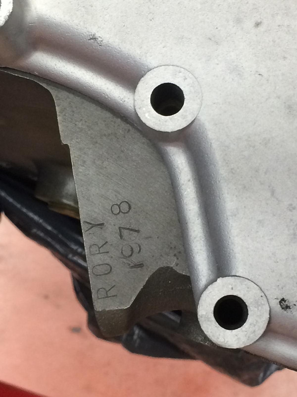

I thought this might be the crowning glory.

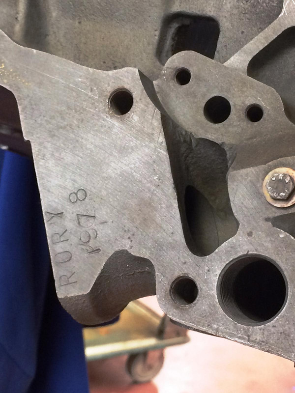

My block - like yours, probably - already has an identifying number, generally referred to as the engine number, and it's unique.
The famous firm thinks that's not enough, and how better to make it even more unique by stamping a new number - including my name and the job-reference - on the outside of the timing chest, on a flat machined surface that is always visible, for perpetuity.
Clever eh ?
What would the rest of you do in my situation ? This is where we're up to today :

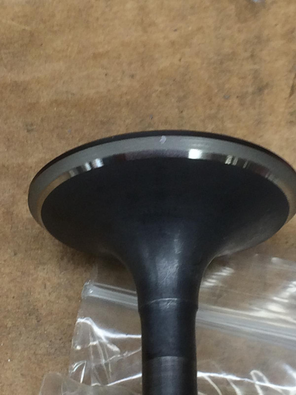

The discussion for today might be whether it is considered good pratice to shorten valves by hand on a bench-grinder, leave a nasty chamfer, and with an end that is not square ?
Sorry, I just can't fathom how it is possible to execute such botchery.

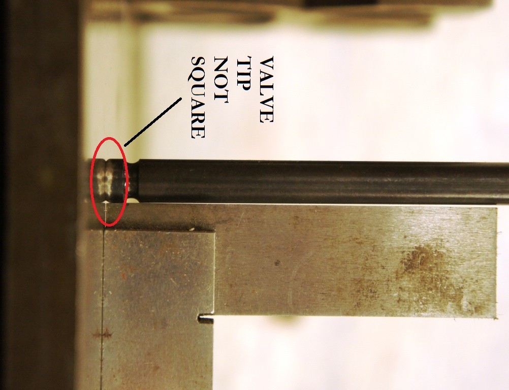

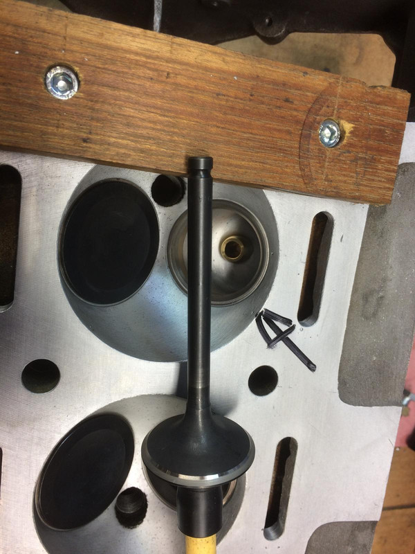

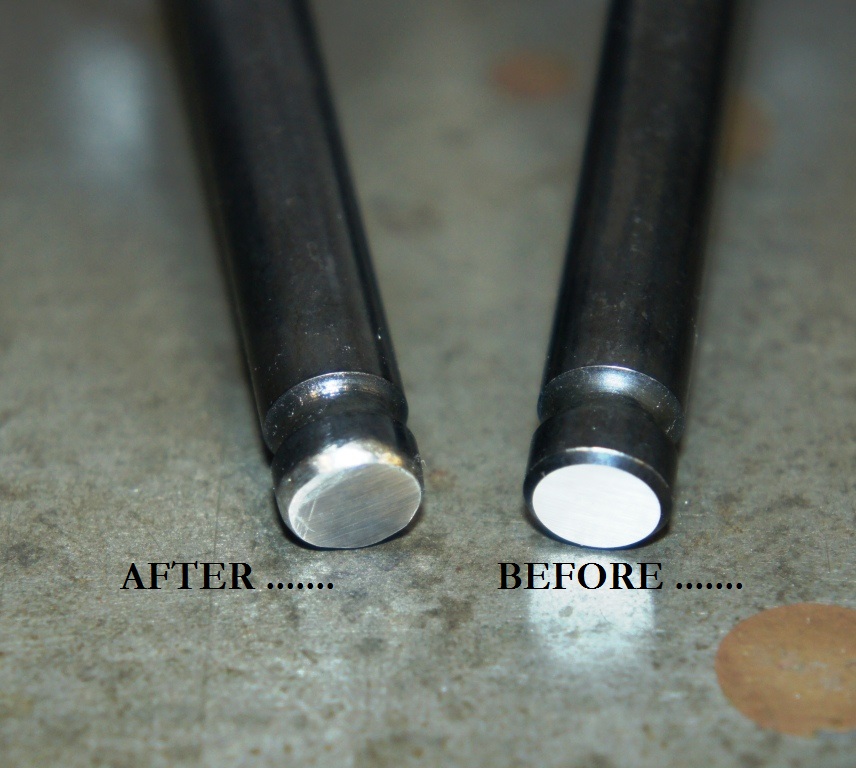

Once I stripped out the inlet valves (ostensibly just to oil the valve stems, remember) I could see that one tip had been absolutely butchered.
Seen with a set-square on the surface plate.

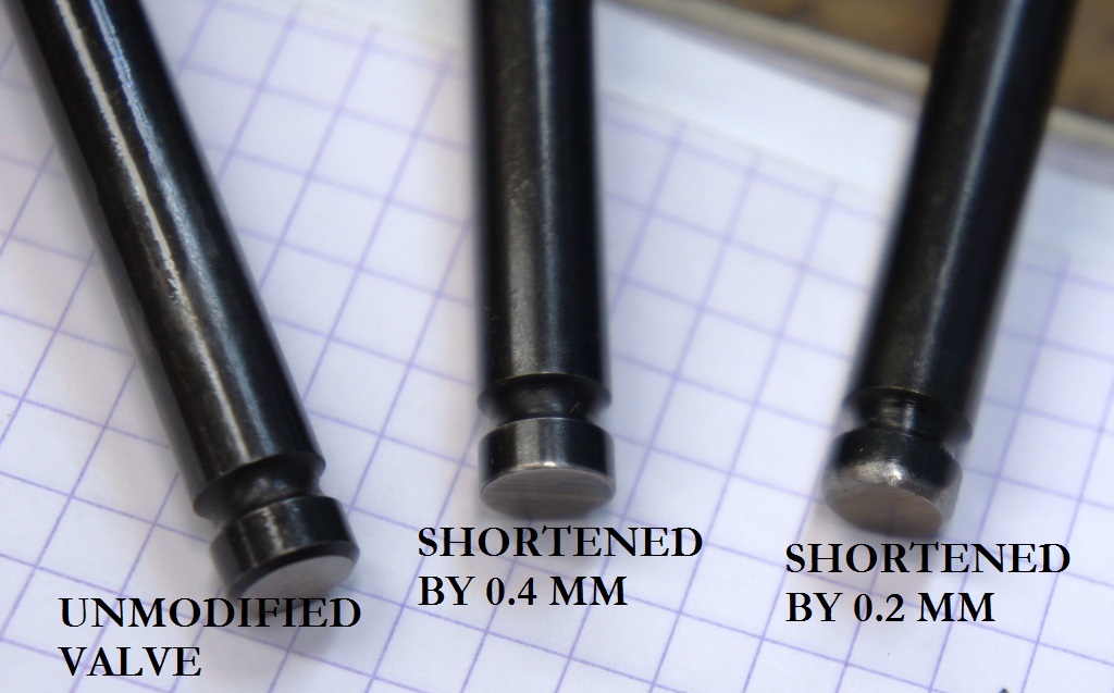

Measuring them showed that 0.2mm had been taken off the butchered one, and 0.4mm - more neatly - off a second.

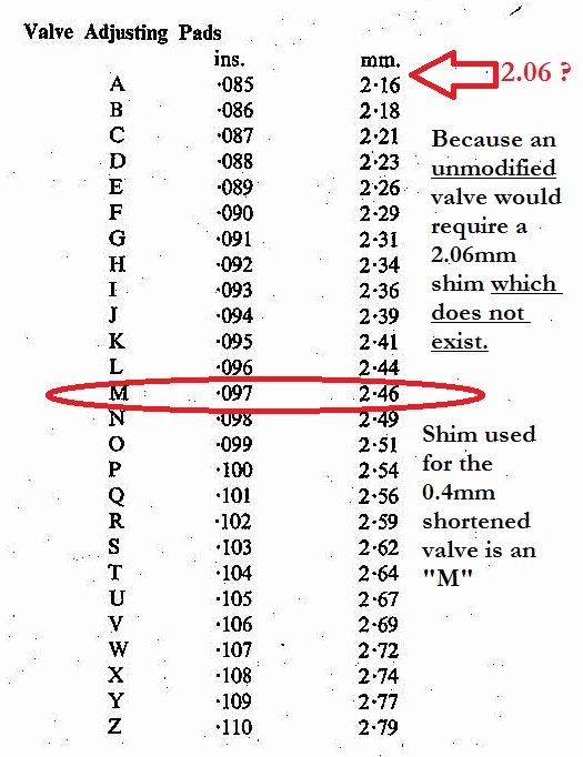

Now, I had already been surprised to see that the shimming used essentially shims from the mid-range of those available - sizes M-N-R - which with NEW seats is a surprising choice, as wear on seats and valves tends to drive one towards thinner shims .............. and yet half of the available range has already been used up by seating the valves a little deep.
Shoddy workmanship, sir ? Follow me.
It gets worse.
Here's the reason.
The 0.4-short one had been shimmed with an "M" shim, 2.46 ; so if the valve had been left at standard length, it would have required a 2.06 (2.46 - 0.40 = 2.06) shim which does not exist as it's outside the range.

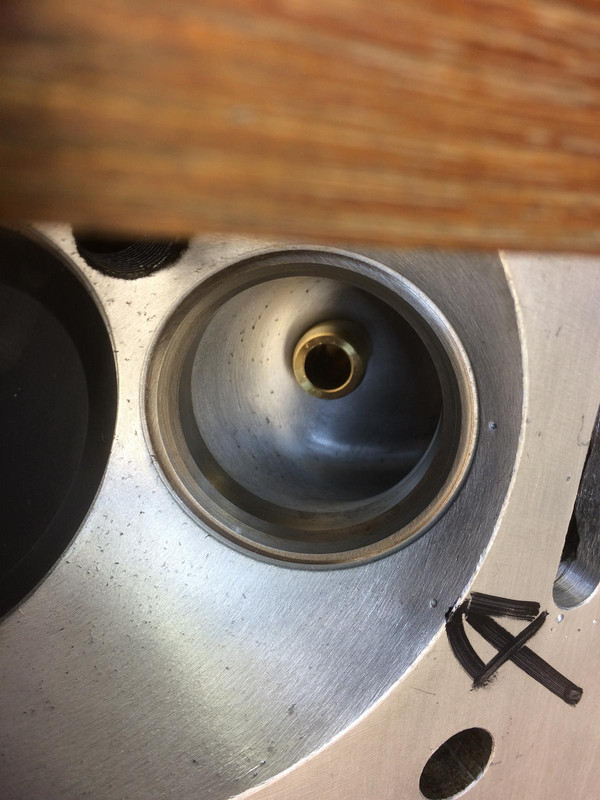

All this because the seat has been cut too deep.
And the one that had been shortened by 0.2mm used a "Q" shim, instead of the "I" that would have been required, which would have used up two-thirds of the range of shims before the engine had ever been fired up.
Unbelievable, no ?

Block-Stamping
The reply regarding the block-stamping came back :
Stamping of the block, yes this is the norm. This has been done by most of the UK restorers for decades, not just machine shops. I won’t name drop others who also do the same to support my case.
Personally I have been met with incredulity by all the machine-shops and restorers that I've floated the idea past, both in the UK, the US, and Australia.

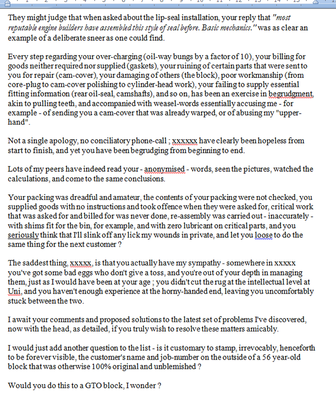

At close of play this evening the latest exchange reads :
Dear Xxxxx,
I am pleased to see that your father is getting involved ; he is hopefully beyond the age of insulting customers (quote : At least I know now the sort of man I never wish to be in my 60s) who have genuine grievances.
He might like to get up to speed by following this.
http://forum.etypeuk.com/viewtopic.php? ... 69#p108569
With the inlet gaps set to the correct 0.010", the shims required will be even further down towards the thin-end of the range (O-K-L-K-P-K) which is unacceptable.
I am therefore waiting for a detailed answer to my enquiry dated 29th October, to wit :
Before I confide this cylinder head to your company again, I should like you to confirm exactly what remedial work you are proposing to do, including with regards to the damage to the seating surfaces.
Upon removal of the inlet valves it is apparent that two have been shortened, one butchered in the process, apparently in an attempt to remain within the shim range.
One by 0.4mm to pull the shimming back from below-minimum to an M, the other by 0.2mm to pull an I back to a Q
It appears that the seats have been cut too deep. Pictures attached.

rfs1957
Posts: 1594
Location: Languedoc - France
#39 Re: Dishonest, Incompetent, Feckless ? You choose.
Post by rfs1957 » Mon Nov 19, 2018 2:26 pm
Many thanks for the various helpful suggestions.
I'm working towards a YouTube video detailing everything that was cocked up by these people, thus pulling into one place the kind of questions that any putative customer should be discussing with an engine-builder or a machine-shop.
I had no idea that firms as poor and hopeless as the one I dealt with existed, and would have been far more careful if I had believed that when I bothered to write a job-sheet as detailed as this, for example, they would essentially not read it :
Their invoice seemed to suggest that they had understood what I was asking
but essentially they have no system in place to track a customer's requirements, and are visibly not interested in the slightest in the detail quality of the work they do.
Yet this is PRECISION ENGINEERING FOR PERFORMANCE, you'll note.
A nice little cameo here - in paying £156 for crank-balancing, £156 for grinding to suit a lip-seal, £66 to have the crank crack-tested, £276 to have the crank re-ground, and £96 to have the 6 oil-way bungs removed, I had imagined that this might include cleaning up the 1/2" UNF bung threads in the crank (deformed by centre-punching in the past), dressing up the burrs on the key-way slots as I had requested, and changing the mainshaft bush.
None of this had been done, witness the damage done to the oil-way bungs upon installation for balancing the crank last week - note the swarf coming out upon assembly.
An HSS tap for doing that costs £9, and it would take less than 20 minutes to do the job properly.
When I was doing exactly the same operation on Ducati bevel-cranks, for decades, that is exactly what I would have thought was just normal - in fact here's the very tap (probably ten times the price) and one of the bungs :
And as regards crank-balancing, whilst the oil-way bungs are all identical, from my experiences last week it DOES matter that they should be fitted before balancing as 1) who knows how consistent the positions of those six cross-drillings are ? and 2) since those cross-drillings are at an angle, sloping towards the crank centre, and essentially tapered, with tapered bungs, nobody knows what their installed position is going to be.
Balancing a crank that hasn't got them fitted is basically just lazy workmanship.
And whilst I don't know what the "balancing" I had paid for involved, balancing it the Montpellier way on Escuret's machine required a couple of hours work and quite a lot of drilling.
