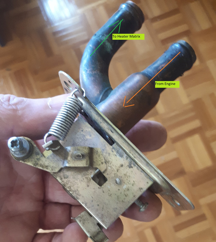

#31 Re: Heating and ventilation *** Updated
Yep, yr marked up pic is correct for my car, which is in pieces atm so 2 pics:rossco_j wrote:Tue Jul 21, 2020 8:49 amHello Colin / lowact,
Can you help me by clarifying your post please. I've added a marked up copy of your photo to ensure that I understand your explanation of the valve operation.
My recently re-commissioned series 3 seems to always have warm air flowing into the cabin. Not an ideal situation in Queensland...
If I'm understanding correctly, the flap in the heater box should be vertical & the valve arm towards the front of the car. I've also adjusted the philips head screw fully in.
I'm trying to achieve mostly cool air in the cabin.
Do you have a photo of your heater hose configuration please.
Thanks for your time
The 1st shows the engine, the upright spigot with the tape on it is for the water from the engine to the heater. The pipe with the horizontal end is for the water return, from the heater back to the engine (water pump inlet).
The 2nd photo shows the heater hoses, the centre hose pointing downwards is the heater inlet. The horizontal pipe at the bottom of the pic is the heater outlet.
However, it should not make any difference how the hoses, from the engine and to the heater matrix, connect to the valve. All the valve does is throttle the flow from the engine to the heater, it does this irrespective of the direction of the flow through the valve.
When the heater control lever (with the spring on it) is all the way forward there should be no water flow through the heater, irrespective of the position of the separate little adjusting screw at the back of the valve. You can check this by trying to blow through the valve …
The little adjusting screw, if you screw this right in, there should be no water flow through the heater, irrespective of the position of the control lever. I adjust the little screw by: starting with it initially wound out and the control lever held forward; winding the little screw in just enough to stop me blowing through the valve, this gives the largest heater operating range.
The flap in the heater diverts the air from the fan. When it is vertical this air is dumped into the engine bay, there is no air flow (hot or cold) from the heater. When it is horizontal (closed) the air from the fan flows through the heater.
