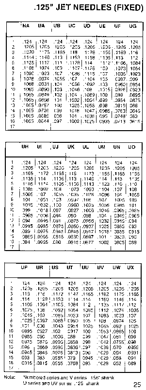

Besides that, where can I find a needle reference for an U1 needle ? All I found is that Rover P2000 reference, but thats it. I think it is not U01. Its just U1.

The various needle specifications for HD8 are given here
As you will see UI is slightly richer throughout than UM, but not by a huge amount , and UE and UO are much richer. Note that the degree of richness is not related in percentage terms to the diameter of the various needles , but is related to the variation in cross sectional area of the annulus between the needle and the 0.125 inch jet
The formula for the cross section of the annulus at each station is 0.0122734375 minus 3.142 X the square of the radius of the needle

The needle is not UI. It is U1. I‘ll take better pictures. And I‘ll compare the U1

This question of the needle is getting confusing as a result of some kind of misprint in the SU catalogue. The needles for the Rover 2000TC 1966 only, is indeed given as AUD 1521 U 1 ( and indeed if you search Burlen's site they come up with a U1 needle out of stock ). When one looks at the cross reference of needles, however, AUD1521 shows up as UI which is indeed a needle for an HD8 as opposed to the HS8 fitted to later Rover 2000TCs.( The difference being , I think, that the HS8 have spring loaded bias needles, whereas the HD8 have fixed needles ) . I will telephone Burlen tomorrow to see if I can clarify the poistion for you , but for the moment I think you can take it that the dimensions given for UI are the ones of the needles you have, as there is no U 1 shown in the list of .125 inch needles, the only numbered U series needles being U70 and UV1 . It might be that Joe Curto's invoice shows the AUD part number as well as the needle designation

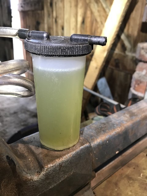

I swapped the needles for an old set of UM I found in a small plastic container (someone must have given me those I don‘t recall, because I also found my old set), I put the springs back, checked everything another 5 times.
Then I pumped out the old fuel via a short hose behind the fuel filter. Then emptied out the float bowls, and the fuel inside was green. See picture.
It must be the copper in the brass floats together with the Ethanol. I then went out and bought 10 ltrs of Esso supreme, which is E5 (I have to check if any of the 100 octane fuels is E0, I guess none will be, maybe Shell VPower). Then fingers crossed.
First trial was nothing, then I decided to loosen the dome caps / dampers, and try again, and after a second or two she ran. And smooth and quiet, surprisingly (to me), I mean I completely overhauled this thing.
