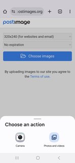

You seem to be nearly there, I select the size at the top and then select Choose Images. On next page at bottom RH corner, I select Photos & Videos from the Choose an Action section. Find your photo and add. I hope this helps.
