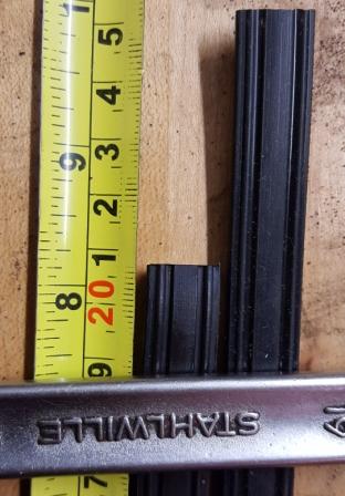

So I contacted the UK supplier and they have replied to say that I do indeed need to cut it down to fit? ( I guess this is an after market seal then and not advertised as such!). I have ordered an OEM seal to compare and fit, all being well.
Thanks for the advice Peter, I wasn't sure if the twin ribs sat in the sump or up against the journal/carrier but you have answered my query (twin ribs - upper most). Strangely the seal naturally curves with the thicker twin grooves - bottom most. The photo was for length reference but good spot!
Would you recommend a smear of sealant along the twin grooves prior to fitment, or let it do its thing??

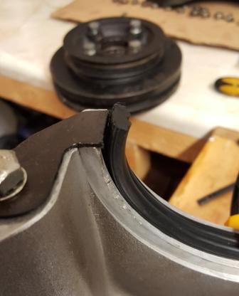

The front main seal was dry so I'm leaving it be for the minute, a smear of sealant will go on when sump is re-fitted. So new rear OEM seal arrived this morning, the OEM seal fits perfect....
Q. Referring to the picture below....The sump gaskets (both sides) sit over the rear seal channel, pushing the seal out. I can clearly see that the opposite end of the sump gasket has a cut-out to fit around front main seal nicely. Any advice? Both the original sump gaskets and replacement are identical.

Post by tim wood » Thu Sep 24, 2020 12:22 pm
From what I recall my sump gasket had a cut out around the seal for the front end but not for the rear neoprene seal and overlapped the seal edge.
I think I stuck it to the crankcase using a sealer recommend by Andrew Bowie who posts on this forum.
Used a bit of wynns gasket maker to “glue” the seal into the sump recess and left it to set overnight. Then up it went.
I’ve used wynns gasket maker on other seals and it is so efficient that getting them separate again is almost impossible which is why I didn’t use it on the sump.
Others may chime in.

All the time in the world at the moment as weather is turning cooler up north. It also gives me chance to replace the odd bolt and washer(s).
I have Wynns sealer and I plan to fix long gaskets to block face first. The sump will then go up and the rear seal will mate directly onto them (ends) with more sealer.
I've added photo of seals for others to compare when also in this situation.

Congratulations on pursuing the solution Steve. Based on that OEM seal you were dead right. Good reason to get OEM whenever possible. Just went through a similar result on a turn signal switch repair.
