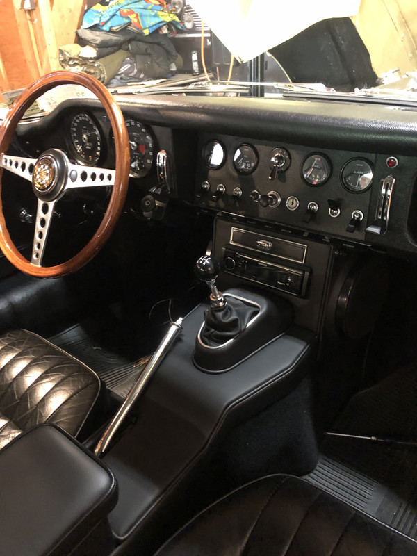

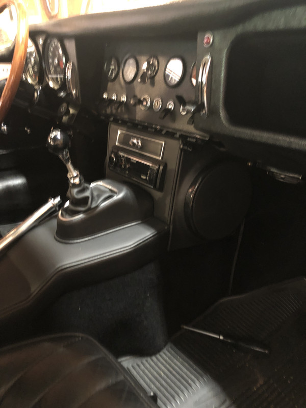

The microphone came in!
All done except for the last little speaker on the drivers side
Sure looks pretty and everything fits!
I finish the interior today and tomorrow

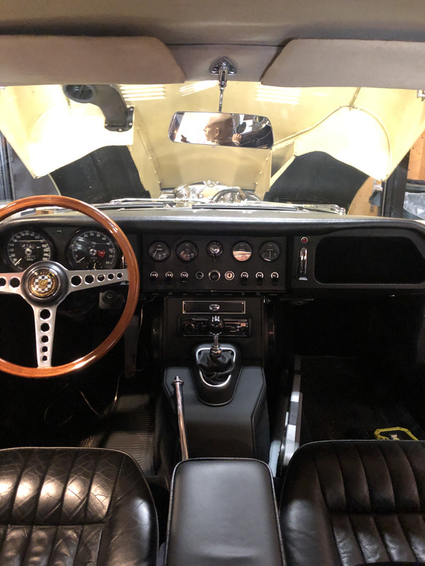

Joey....you photos above look to me that the car is at normal ride height.......not lowered 2inches....so for clarity are we talking 2in lower than spec ride height......Steve
gtjoey
Posts: 604
#512 Re: The 5 Speed is here……..

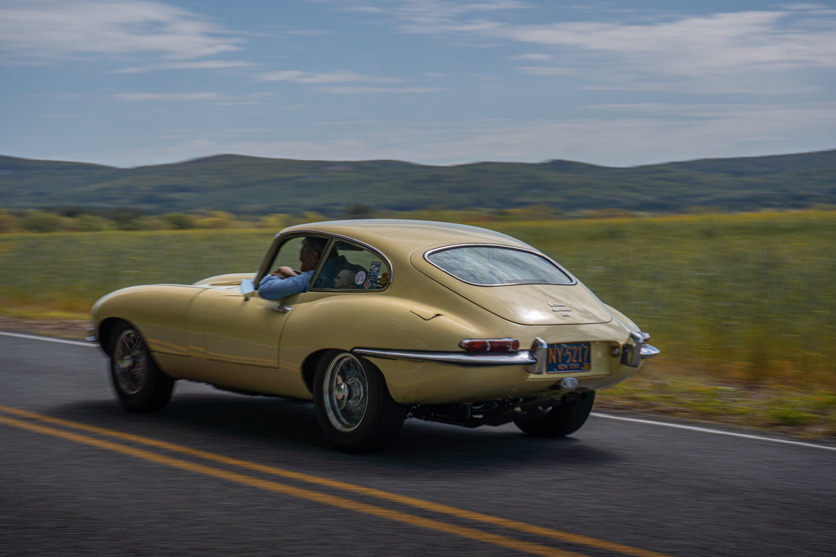

Post by gtjoey » Sun Oct 23, 2022 9:44 am
Yes
The ride height is now standard height
The reproduction coil springs from all the majors are sitting too high
I have 9,000 miles in a year and they still did not come down.

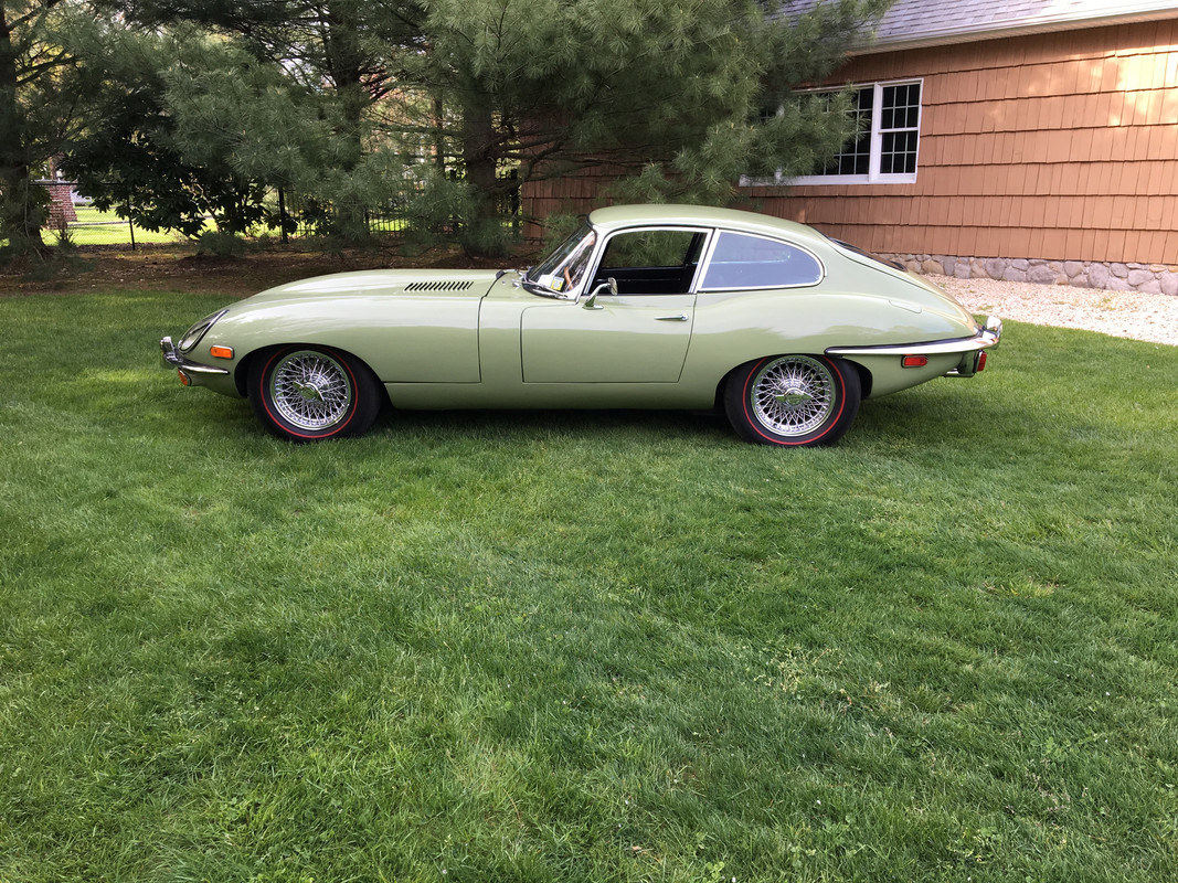

Here is my OLD series 2 with a complete rebuild with NOS springs from Johnny Farrell back in the day
They sat perfect

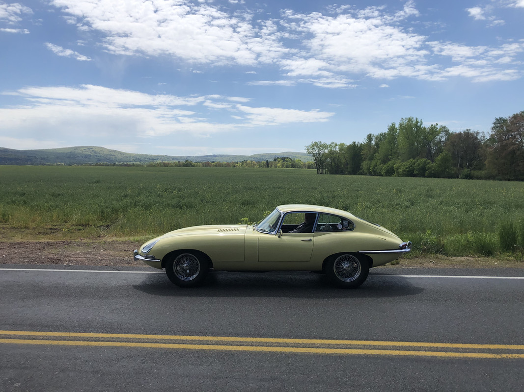

Here is my car 5 months ago
It looks good but that’s with a full tank and Gerry Duff at a cool 245😀
It’s way to high

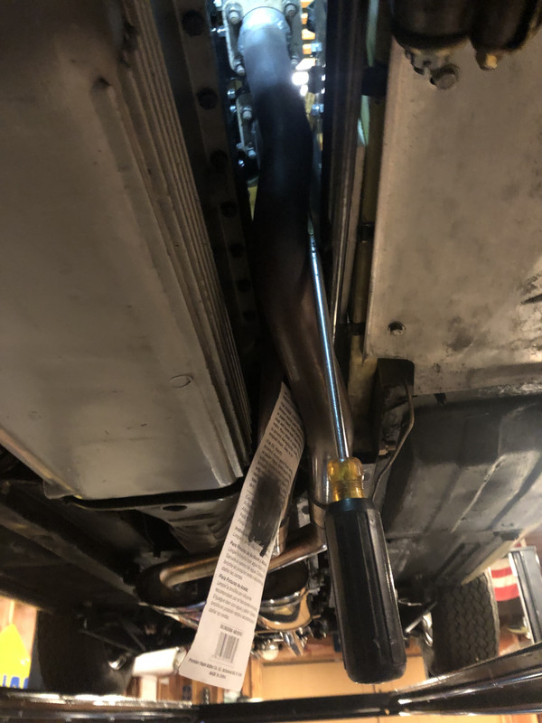

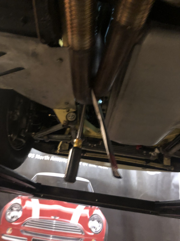

It’s very complicated but after I’d say 150 miles the pipes started hitting the new upgrade sway bar
So with my trusty tool gauge , cardboard and a screw driver
I loosened the exhaust nuts and moved the pipes a hair.
