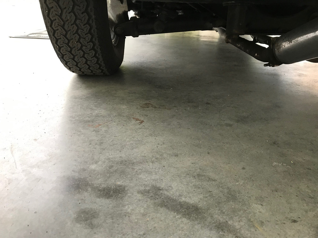

Concours with rain today. Judging under cover and I managed to get photos of 6 car rear suspension lower arms. One photo shown as all are about the same. Note the cars were without driver or other items like luggage or passenger and I did not check fuel level.
I extended the photo horizontal and axle lines out to obtain an accurate reading with my angle gauge. All were 4.8 to 5.5 with the average 5.2 degrees with the diff end higher than the hub end.

As per post 42:Geoff Green wrote: ↑Sat May 18, 2019 11:27 pmAll were 4.8 to 5.5 with the average 5.2 degrees with the diff end higher than the hub end.
"Had that drawing in mind when I posted Stu. Trouble is, I’ve driven too many miles behind many Es and in my mind’s eye I see only wishbones sloping down by varying degrees."
By the time you see one with horizontal wishbones you're usually looking at a heavily laden car, often a V12 2+2, not your average mid-laden day tripper.
