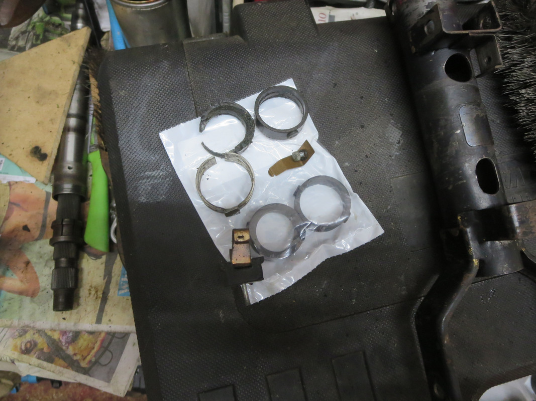

I found a need to strip and repair the upper steering column this week. The lower bush had finally and completely given up, leaving a line of dust in the under dash shelf and a steering wheel that had over an inch of up down movement. Simple job, nothing was rusted in place, but I did find several other items that need to be replaced in addition to the top and bottom bushes. The striker ring that resets the indicator was showing signs of previous damage and repair, and both horn contacts were severely worn.
My 67 S1 column sleeve (and the various worn parts) looks like this. I assume this is original to my car, even though a lot of other things are not. There was no plastic ring with the indicator striker.
The horn contact on this column faces up towards the driver, not down to the footwell.
My car is a driver so just the bushes were replaced. The other parts will be replaced over the winter. One other thing I might do at that time (purists please avert your gaze now) is to convert the indicator to left hand working. If noting else it will stop me indicating right with the wipers on my other daily drivers.
