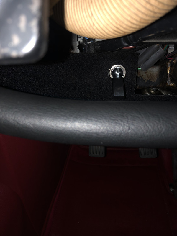

Post by RobertGrieve » Sat Jan 19, 2019 5:26 pm
I have just fitted the twin coolcat fans and they are absolutely brilliant. With previous original fans my cars temp would be fine on the move but would creep up in traffic or parking up/traffic lights. I have also fitted an override and (quite neatly I think) tucked a toggle switch under the dash. With the new fans on the cars temp can creep to 90 and drop right back to 75 or so with the fans within a couple mins. Very pleased.
