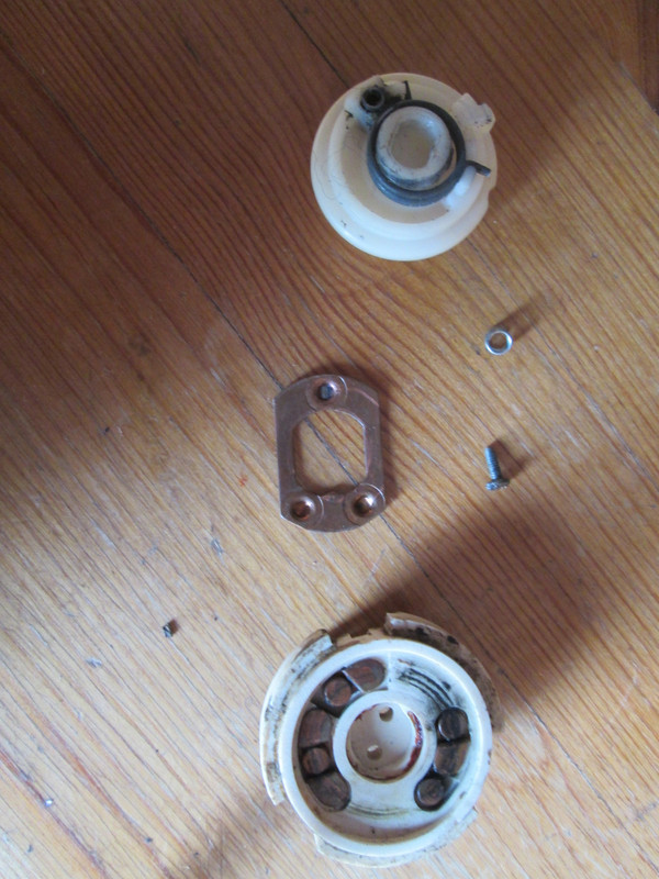

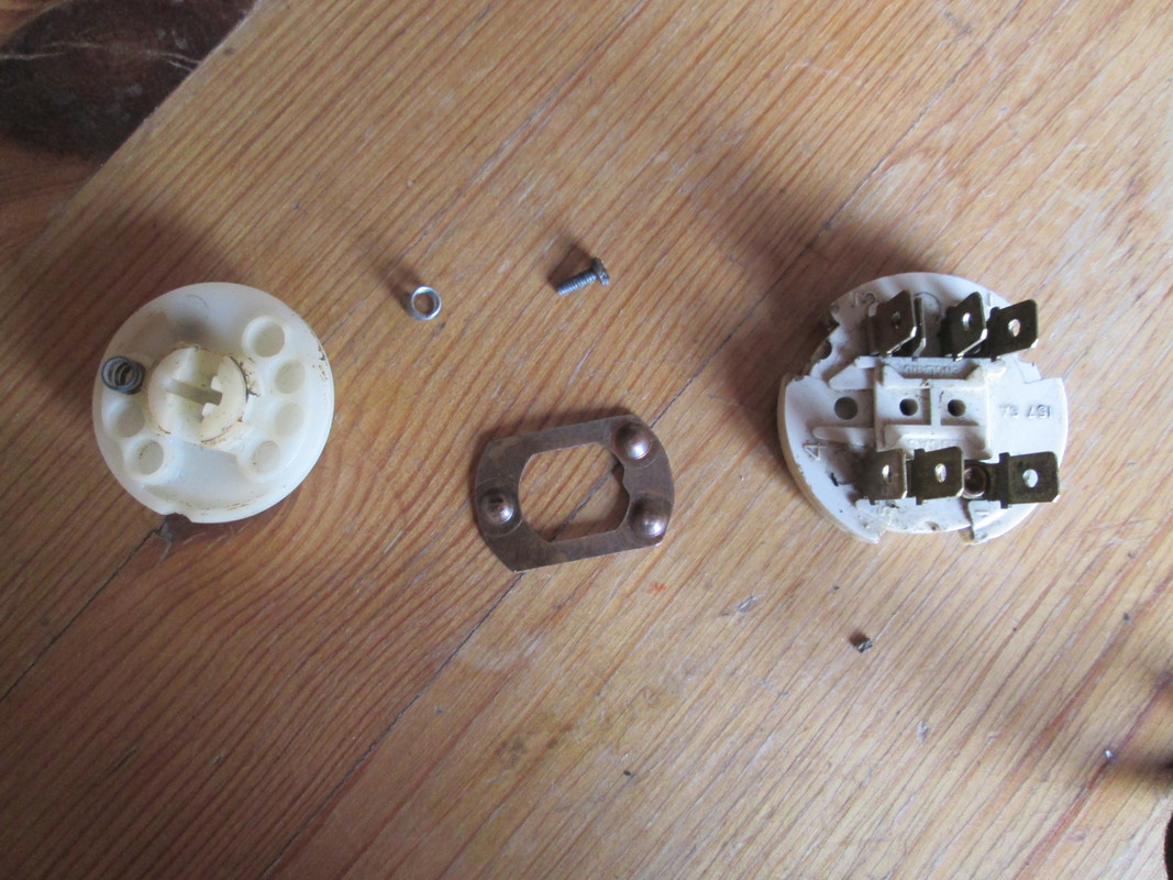

Thank you all. I found the (very) tiny screw, extracted said and the ignition barrel fell out in pieces when I pulled it (gently) - two plastic discs, a couple of tiny springs and a brass contact plate. I'm assuming that the barrel shouldn't fall to bits and so hopefully a complete replacement will do the trick.

Any chance you could post a couple of photos of the lid thingie that holds the actual switch in place. I'm going to have to fabricate one.

As requested, I've attached some photographs of the bits that comprise my ignition barrel.
As suggested, replacements don't currently exist - I'm hoping a local auto-electrician can 'put' my bits back together as a working unit. In the meantime I've rigged up a Heath Robinson ignition bypass that will need to surfice till then!!
Cheers, John

Post by abowie » Tue Apr 02, 2019 11:23 pm
What I'd really like to see is a couple of shots of the cover that holds the switch in place.

Post by JC » Wed Apr 03, 2019 9:01 am
The penny is dropping.
My barrel was held in place by a couple of plastic ties. I'd presumed that this had been 'bodged' as the plastic components no longer 'clicked' together tightly. Clearly the previous owner had lost or damaged the cover component.
I now have a fuller understanding of my problem, but I'm afraid it doesn't help you!!
