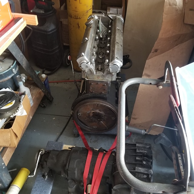

Are e type 4.2 engines interchangeable with 420 engines? Whats the same and whats different

Thank you so much! that answered all my questions. I have a deal I can't pass up on this 1967 engine, runs with 67,000 original miles. I'm guessing it came out of a 420 but being as my E has pitted cams and probably a pitted crank this will get us flying sooner than later. :wavegreatbritain:

Good choice. I have one of those tucked away as a spare. And yours should be a short stud block which is preferable. Check its engine number here http://www.jag-lovers.org/xk-lovers/lib ... umbers.htm

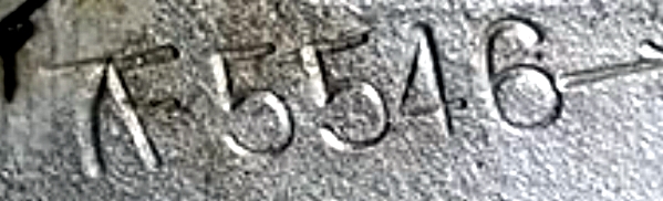

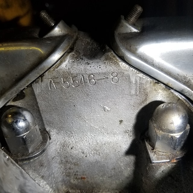

Wow, according to that link I may have done better than I thought. This appears to be a Series 1-1.5 E-type engine. Came with an automatic gearbox

Looks like a 7F to me meaning it came from a 420.
Thanks for the image enhancement! my eyes must be getting terrible :thankyouyellow: Now we know definitively! I'm always greatful for your help and insight :bigrin:
