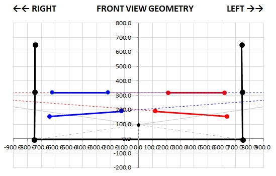

Its not really complicated- you get pictures, like the one I posted, and take dimensions and angles.
Im posting my diagrams of how I worked out the X308 Jaguar roll centres
The 280 mm number for the front of the E type is just so far out of the norm. However you can see how I arrived at it, if you project/extend the LCA arm lines and do the same for the UCA toward the centre of the car, and then project where these lines come together. Its at this projected point where it comes together, where you extend ANOTHER line to the vertical centreline of the car. Its where this line meets the centreline that is the point of the roll centre.
I do think that the roll centre importance is sometimes over stated and also bear in mind that the E type was designed when cross ply tyres were commonplace.

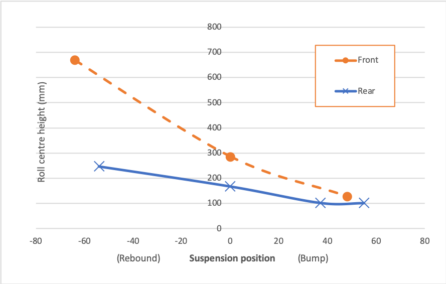

First, thanks to Geoff, I've sent a email to Rex hoping to get some of that precious K&C data.
Following that I feel I owe some explanation since I appear to have started the discussion going again. The project I'm working on started, as so many do, with musing on what we might do to upgrade a car that needed major rebuild work. My partner in crime, the car's owner, shipped it from the US to Australia and is very much open to modifications to update the performance to match the appearance. I spent my entire working life as a car development engineer so while I respect history I generally feel compelled to find the weak performance areas and improve them. (I have serious plans for my old TR5, not relevant here). To get to the point, after a bit of study we're going to fit new suspension front and rear. While acknowledging the efforts the Jaguar engineers made to fit reasonable systems under that beautiful body, there really are better ways if we relax the cost constraints and allow modern parts and systems. One example has already been covered in this forum - the front roll centre. As Rex mentioned, it's very high. More significant, it moves a lot as the suspension rises and falls. Undesirable in itself as it will tend to give a lack of certainty or connection in steering feel; even more so when compared with the relative stability of the rear roll centre. I estimated the roll centres very crudely from the drawings posted on this forum, I've attached the plot to show how roll centre heights vary as the suspension moves up and down. My figure agrees quite well with the figure of 280mm mentioned by Rex, at "kerb" loading condition, but it drops severely as the car moves into a bump situation - under braking for example. Ignoring all the other variables for the moment, a high front roll centre will tend to give understeer so conversely the car will tend to move towards an oversteer balance as it pitches under braking. If the rear of the car is rising at the same time, the graph shows us the rear roll centre rises giving another cue towards oversteer. None of these is a guaranteed spin, they're indicators of a tendency. I believe we can do better with current tools and materials. For illustration, I recall the hours it took a designer at Triumph to produce a plot like the attached, with ruler and pencil. It was impossible for them to explore the full range of possibilities in all the parameters we can study in minutes with very affordable software. I don't think it's immodest to say we can do better.

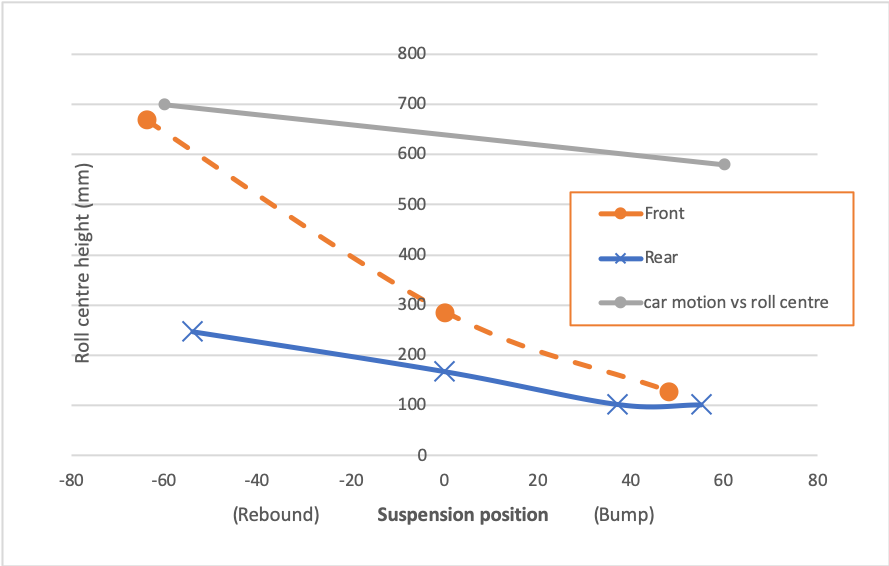

To answer Geoff's point, after a minimal amount of study I suggest you might try lowering the front of the car. That's a pretty obvious response but I can support it with a chart! According to my chart this will not only lower the front roll centre, it will bring it closer to the rear. The significance of that is the roll axis will not be so steeply sloped. When the roll axis slopes steeply the car can feel as if it's rolling in a conical manner (wider at one end than the other), which in turn gives a disturbing feeling that you're not quite sure where it's heading. These are subtle factors that depend on other factors, damping being a major one. By my experience you don't need to identify the feeling to find it unsettling, you just feel life got better if it goes away. Like noisy kids. That indirectly addresses Geoff's point - personally I don't get a lot of pleasure from struggling to direct a car, I get the enjoyment from identifying the engineering root cause, fixing it and enjoying the result. I've worked with hundreds of design and development engineers on four continents and never known one who chose to make a car hard to drive in order to give the customer more challenge.
With all of that said, I recognise my views and activities will raise some eyebrows among this fraternity. i hope you can tolerate a range of views, I will try to contribute in a positive manner and be sensitive to those with greater reverence for originality.
Moving along, I've updated the roll centre chart I posted earlier to be more informative. I've added the grey line at the top to show the suspension moving 120mm, with the roll centres also moving 120mm to suit. In other words, the roll centres move with the suspension. Ideal? Not necessarily, but somewhere between that and zero movement (imagine the grey line horizontal) would be pretty good. It's obvious the rear suspension comes a lot closer to that than the front, so I would address the front first to get a more precise feel. Ten minutes doodling suggested you could get the roll centre down appreciably by moving the inboard upper wishbone pickup but I didn't go as far as checking the slope of the curve, which is what really matters. Moving the lower wishbone would be a lot more effective but there's that sort-of-torsion bar complicating matters. This is where we came in, how we moved to major mods.
I hope some of this is helpful.
RC chart 2.png (51.42 KiB) Viewed 10770 times
