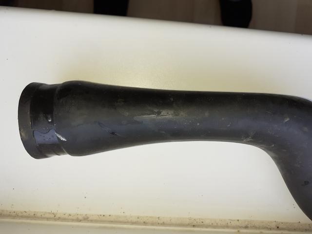

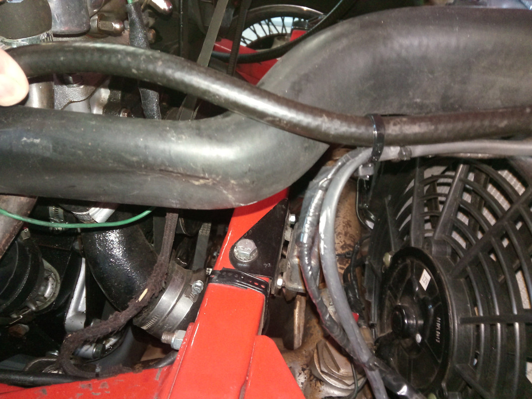

Just done my usual daily checks of fluids and noticed that the top radiator hose has collapsed, the picture does not show the problem too well but it is now nearly flat. I have had no over heating issues and the system is full of coolant.
Has anyone come across this before, or is it just a failure of the hose?

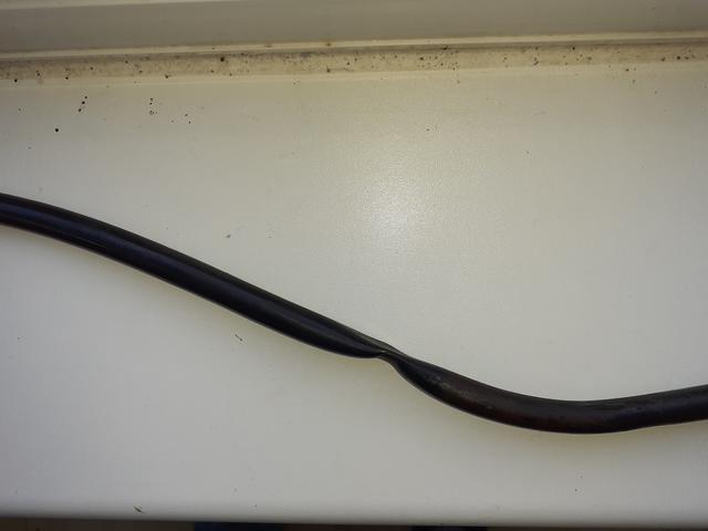

Checked everything, have 7lb cap and plain cap, the hose has not sprung back so will be replacing. The only thing I have found is the overflow pipe from the expansion tank is crimped and as result would be severely restricting the flow, I will be replacing this and the caps. Also the expansion tank coolant level was near the top, normally its 2/3 thirds down. I will replace the parts, test and report back.

Final got round to replacing the top hose and overflow pipe and all now appears OK. As can be seen from the photos the overflow pipe was badly crimped and the top hose deformed. Thanks for all the help.
