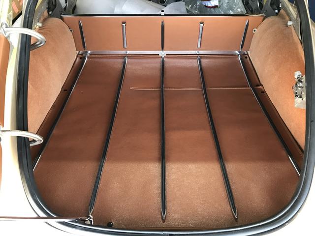

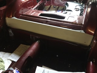

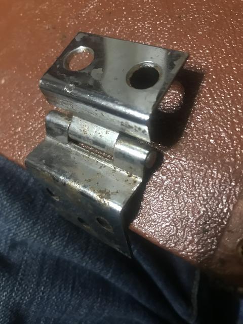

The interior panel pictured is still in primer, but I'm wondering if any of it will be visible once the interior is trimmed, and therefore do I need to paint it? If it is covered, what is it covered in, vinyl or hardura? I don't have the forward section of boot board [the one that folds up] so I don't really know what this arrangement looks like. I think it's hinged but it's not obvious to me where these hinges attach. I assume that there are 2 spigots either end of the board that locate into the spring latches that can be seen either end of the grey panel. A couple of pictures would be very helpful.

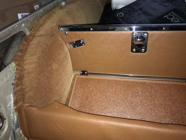

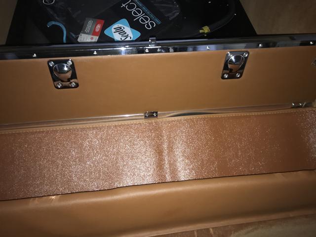

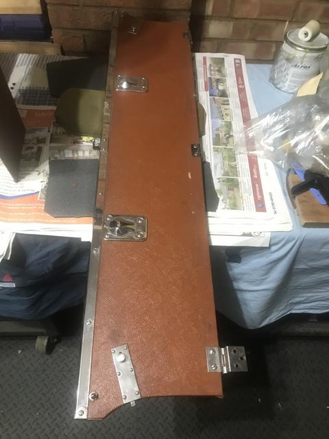

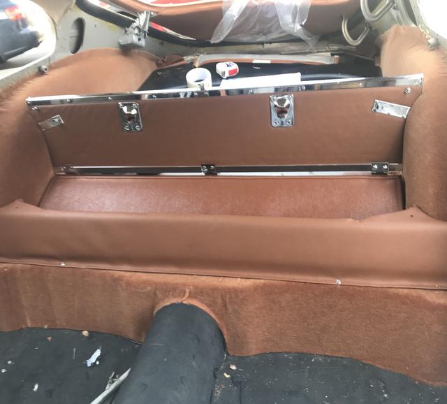

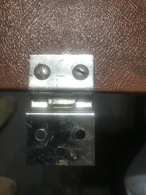

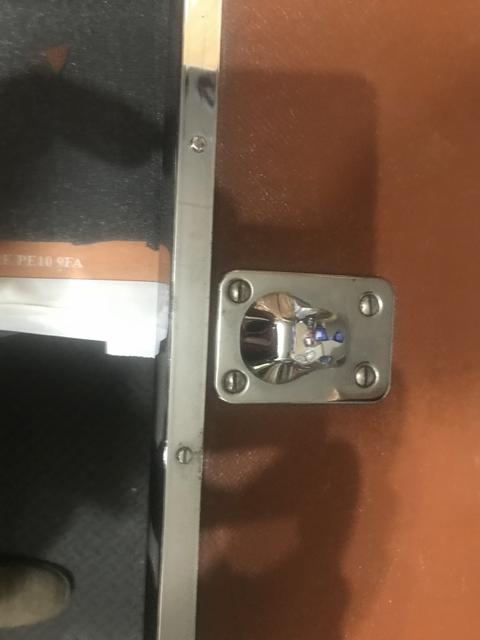

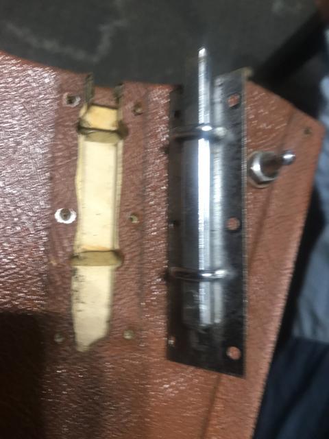

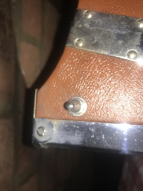

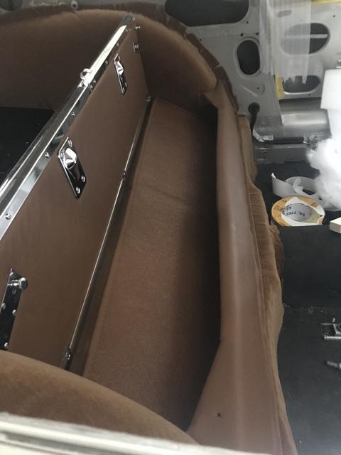

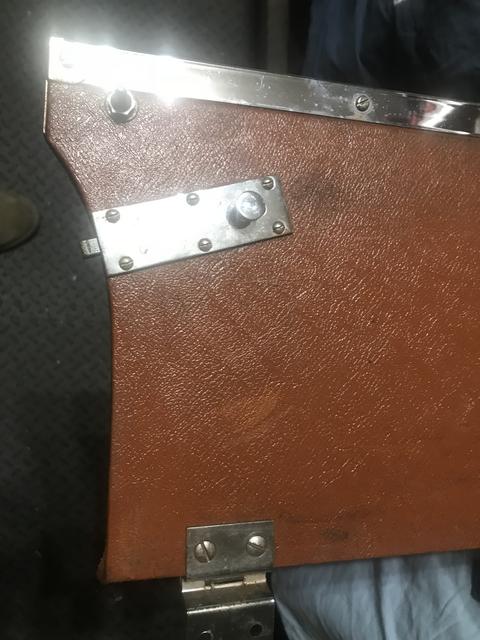

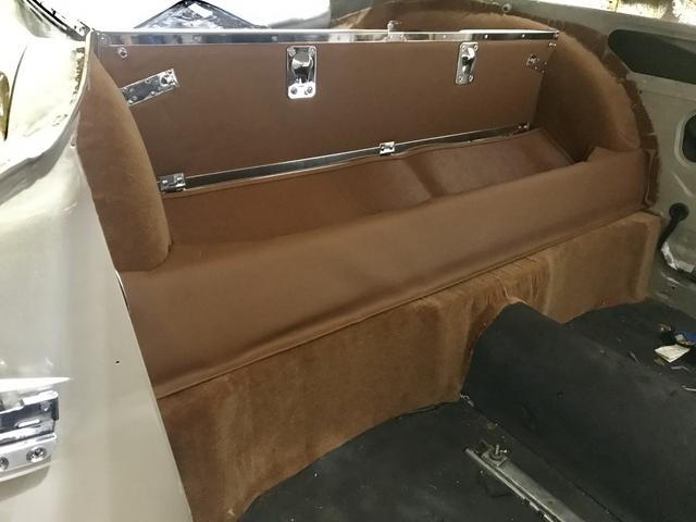

With my S1 3.8, I etch primed it and then glued a thin foam scrim on the outer face that ‘shows’ followed by vinyl as per the original.
I’ve included some pics of the finished item in situ (didn’t take pics of the recovering) and also of the folding cubby lid, before and after so you can hopefully see the hinges and other hardware. I retained all the original hardware, but added a chrome strip along the bottom edge of the hinged lid, to provide support as the original was splitting and looked like had had water damage.

Brilliant. As is often the case, a picture tells a thousand stories. I assume that the smaller boot board that sits widthwise above the IRS is fixed in position rather than liftable as the 2 rear boards are?
