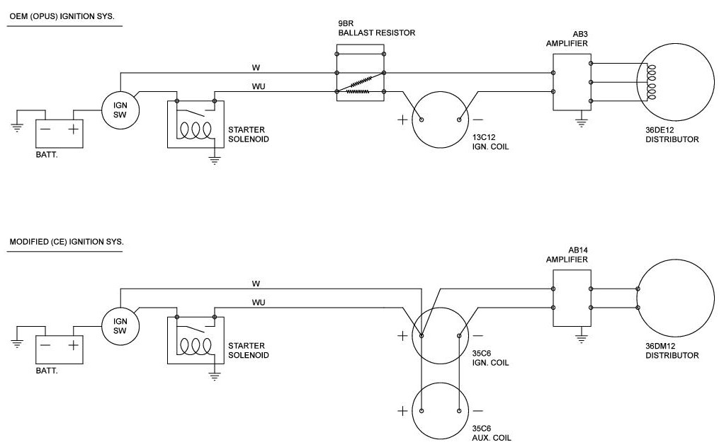

Opus ignition systems on pre-HE engines used Lucas 36DE12 distributors, with mechanical (centrifugal) advance and vacuum retard. There are 3 wires connecting to the amplifier and the vacuum connection faces forwards. The vacuum must be taken from under a carburettor (throttle bottom-edge tapping), where there is vacuum only when the car is idling (throttle closed). This was mainly to improve idling smoothness; during normal driving there should be no vacuum and therefore no retarding beyond a small transition stage (as u r taking off). A common practice, if idling smoothness is adequate, is to permanently disable the idling vacuum retard.
CEI ignition systems on HE engines used Lucas 36DM12 distributors, with both mechanical and vacuum advance. There are 2 wires connecting to the amplifier and the vacuum connection faces rearwards. The OEM vacuum system was sophisticated (complicated), now some components are NLA (no longer available). Common practice is to take vacuum directly from a top throttle edge tapping or, if such is not available, to use any available inlet manifold vacuum tapping and to adjust idle speed accordingly.
I have used both types of ignition system, the CEI system feels more responsive and enables ~3 mpg improvement in fuel economy, with no apparent disadvantage. Wired up as follows; duel coils not necessary for a pre-HE but, since I had them, what the heck:

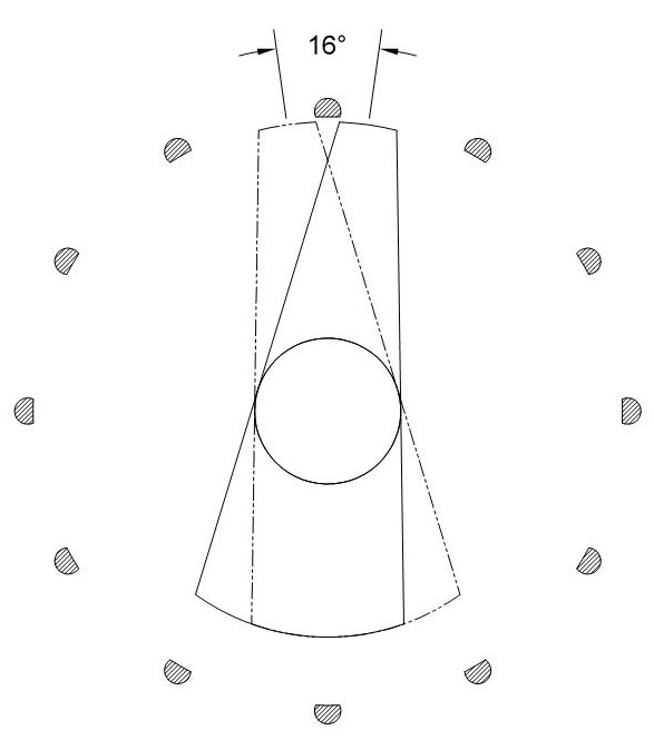

For multiple coil ignition the distributor rotor and cap are not used, replaced with a smooth low-profile cover. For single coil ignition through the distributor, timing control by the ECU relies on the width of the rotor tip (11 mm) and the width of the cap terminals (5 mm), providing 16 distributor degrees (= 32 crankshaft degrees) of timing sweep when a point on the rotor is adjacent a point on a terminal, i.e.:
Phasing the rotor at 20 deg. BTDC then allows ECU controlled timing of between 4 to 36 degrees BTDC, (+/- 16 degrees from the centre 20 deg. phasing point). Claims are that it works quite well …
