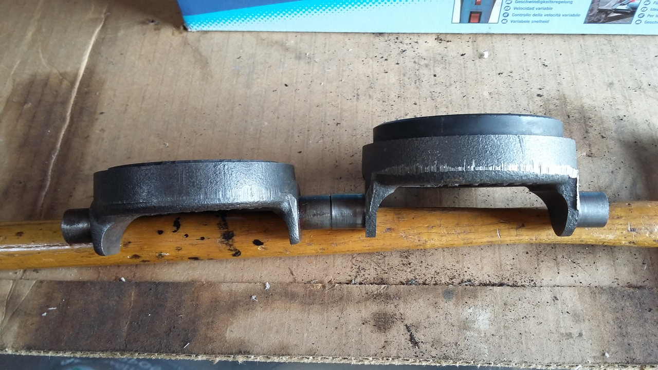

Also ensure you fit the correct release bearing there are several different types..the photo shows just 2 types the one on the left has well worn carbon but note the different body shape....Steve

Just beware of release bearing part number.....i have seen both of the ones in my photo above sold under the same part number as James quoted above......so ensure a replacement is the shape you need and do not just rely on the part number you order....Steve

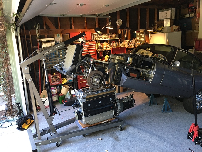

Removing the engine from the bottom can be done without an engine crane, using only a floor jack.
I've never removed an E engine out the top, and have only done two out/in the bottom, both without a crane, so I can't provide a comparison of time or complexity.
You are right that more needs removed when the engine comes out the bottom, but all of the removed bits are probably ready for a good clean and new gaskets anyway. For a pro shop you are paying by the hour maybe out the top is more efficient, but for a DIY job, the bottom route takes less heavy equipment, though likely more time.
So not saying the way I did it is the right way, but here's the brief overview;
Once the bonnet is off, engine ancillaries, exhaust, driveshaft, reaction plate, etc are removed, remove the front wheels and lower the car until the oil pan is resting on a low and sturdy wheeled dolly (I used an inexpensive moving dolly with a reinforcing plate of 3/4" plywood on top). Support the engine frames with the floor jack and remove all the engine attaching hardware and then the engine mounts from the front sides of the engine block. To lift the chassis up and 'over' the engine takes two people if the suspension is still in place, but it's manageably light. (I'm 165lbs, so not a big guy). Lift the body/chassis slowly and roll it fore/aft as required on the rear wheels to clear the subframes and roll the body/chassis back from the engine and set the font end on previously prepared stands. Alternatively, if you have access to some sort of hoist you could use that to lift the chassis.
The second time I did this, I did the reinstall totally solo, but the front of the car was stripped down to the bare subframes so it was very light indeed.

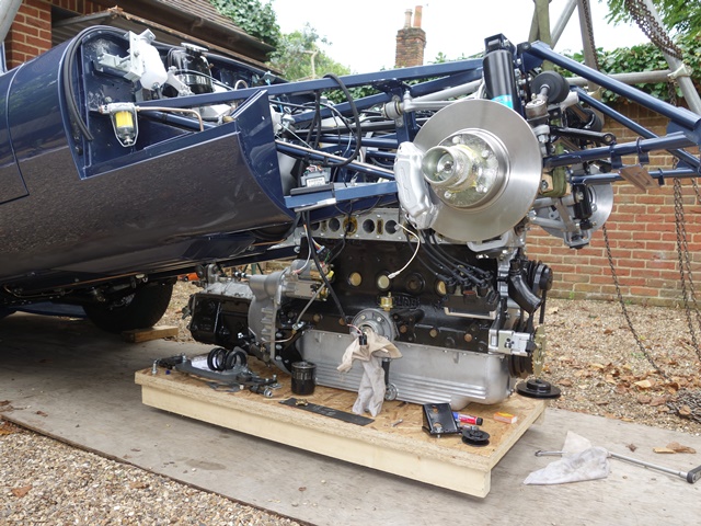

Or you can disconnect the exhaust, prop, brake pipes, bonnet etc , unbolt the engine frames at the bulkhead and split the car in two - wheel the lot out with a trolly jack under the gearbox.
