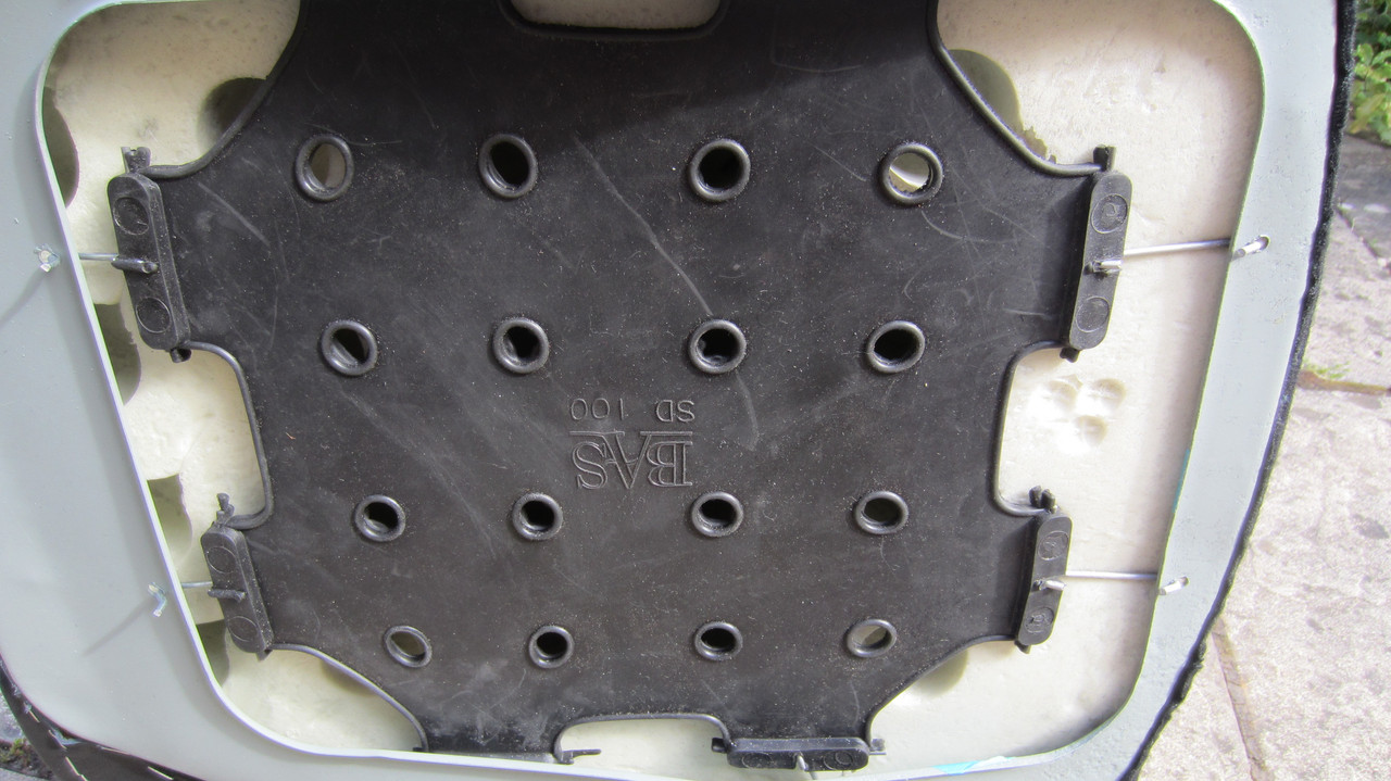

I am planning to replace the seat base foam and rubber support on my S1 4.2 FHC 1965, but can't see how the base is fixed to bottom seat frame?
Posts: 9172
#2 Re: S1 4.2 FHC Seat Base Refurb.
Post by mgcjag » Mon May 25, 2020 3:30 pm
The rubber diaphram is attached to the seat base with clips front rear and sides...the foam then sits on top

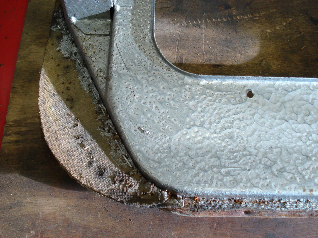

Posts: 9172
#5 Re: S1 4.2 FHC Seat Base Refurb.
Post by mgcjag » Mon May 25, 2020 7:23 pm
And the cover is stapled to the seat base which has a chanel filled with a rope like material to staple into.. as can be seen in the photo above...Steve

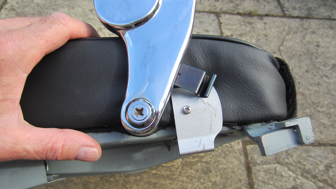

If your '65 is the same as my '65 there isn't really much holding the squab upright, except for body weight.
There should be a metal clip on the l/h side of the base, as in this photo:
These clips don't have a part number and I don't think they are available anywhere.
Then on the l/h hinge arm there is a metal spring hanging down. This is supposed to hook into base's clip and provide a level of resistance. Over time most of them have broken or disappeared.
The part number is BD27383 "Spring, on L.H. Hinge Arms, retaining squab in raised position". I think I managed to get a pair from Richard Smith. No-one else seems to have them.

Re the tacking trim you staple the seat base covers to, here's a photo showing the "rope"y stuff in its channel at the lower right of the picture.
1965 Series 1 4.2 FHC

I'm doing my seats at the moment and have come across several problems on the way.
The coverings and the seat frames in places had been modified, so I had a similar voyage of discovery.
A couple of points to mention: if you are replace the rubber diaphragm, you may find as I did that the spring clips on the rear and sides at the rear are shorter than the originals and if fitted stretch the rubber diaphragm to extreme. I replaced these clips with the originals.
These are the seat back spring clips; I don’t know the size of the screws, I just happened to have some to hand.
I bought the clip that is screwed to the base from Richard Smith.
