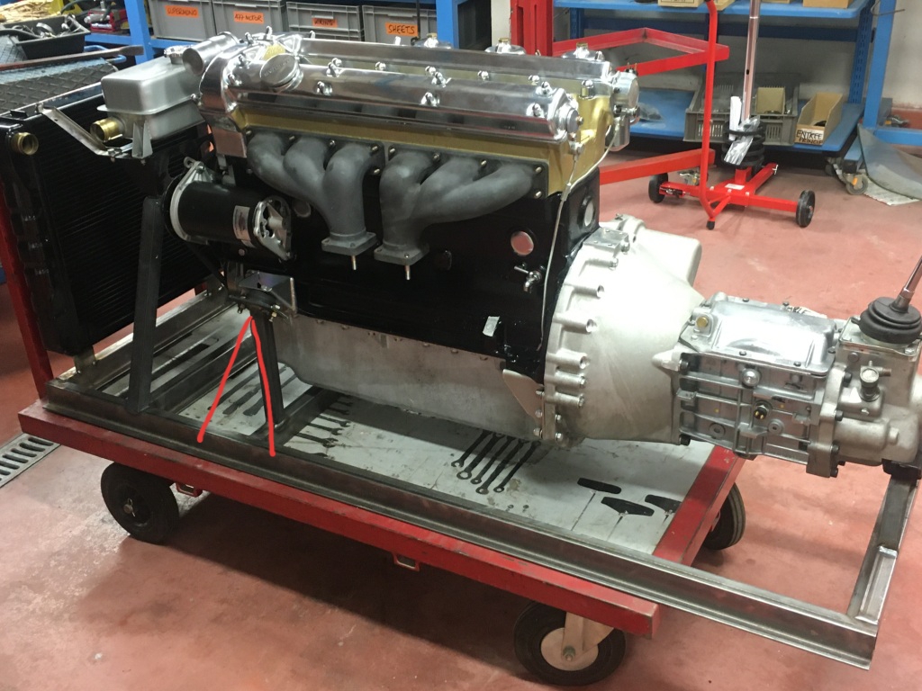

Here's where I'm up to, and maybe others (Michel ?) can chip in with pitfalls and advice.

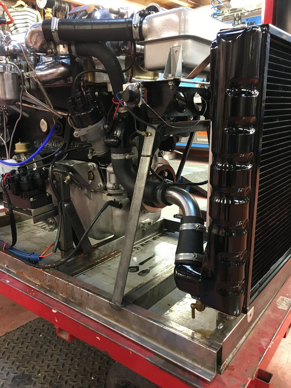

My goal is to be able to run the engine for about an hour in all, be able to set up the carbs, the timing, check for leaks, fit and test the Megajolt system, and generally make the most of having everything so accessible.
So a proper and almost complete (no heater circuit) cooling system, with the electric fan, is included.

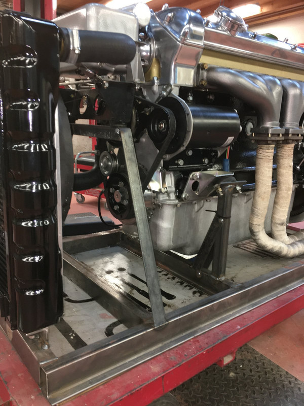

I'm using the general-purpose workshop donkey-trolley as a base, which conditions slightly some of the decisions.
The engine suports are 30 x 30mm tube, I'll be adding a triangulation somewhere as they're a bit weedy at the root, to the eye anyway.
I determined the overall length from radiator mountings back to gearbox tail-support, and dropped heights down from the front chassis tube assemblies including the picture-frame and the bonnet/radiator support frame to give me the requisite mounting heights for the radiator, header tank, engine-mountings, and gearbox tail support.
The tubing is 50 x 30 door-frame stuff, simply because I had fair bits left over from other projects, so it was essentially free.
I think my first cock-up is that I hadn't focussed on how low the exhaust headers went as they make their first bend (I intend to run this with a complete exhaust system), but first measurements suggest that at worst I'll just have to raise the base rails about 50mm to get the pipes to clear the trolley - the major length of the exhaust system will be carried independantly, suspended from trestles.
I'll keep updating this as it goes along, and might put the dimensions and heights into a drawing as these were tricky to calculate and I'd have enjoyed having someone else's work to compare with my own conclusions regarding position/separation etc.

When I read the title, I knew it was probably you Rory. Great idea, It was definitely reassuring to know Guy had run my complete engine and gearbox on his test bed before I fitted it into the car.
Back to your question, the only thing I can see is maybe add a bit of triangulation to the front engine mounts.
Now stating the obvious, and even the best of us can overlook things :yellow:
Music stand style control panel for guages water temp, oil, revs. starter button, battery isolator, fuses, diagnostic ports, etc?
If a laptop is to be used, provisions for this?
Mini loom and its routing / attachment to the frame?
Battery tray and clamp?
Fans, sender and override?
Fuel tank, pump, filter and cut off?
Suitable go pro mount for video of first fire up. :bigrin: :bouncyyellow:

For the two engine supports I did them removable and adjustable for the width of the engine. Also I did the head seperate with an axle so that I would necessarily have the right angle when I put the engine on its supports.
The tube was 40x40, 30x30 is a bit thin.
I also buit an arch to use the third point of the engine. I used this arch to fix the choke in line with the SUs.

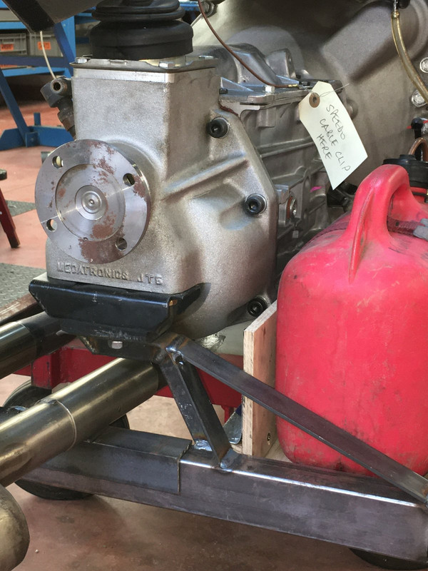

It's not easy to see on the photo but the rear mount at the back of the gearbox is rubber too, like the front?
Just thinking they all need to be either solid or flexible, but not a mixture.

Rear is rubber block on the Tremec 5 speed.
Easy to over engineer this thing, as there’s no torque reaction bar inertial reactions of the block to changes in crankshaft speed.

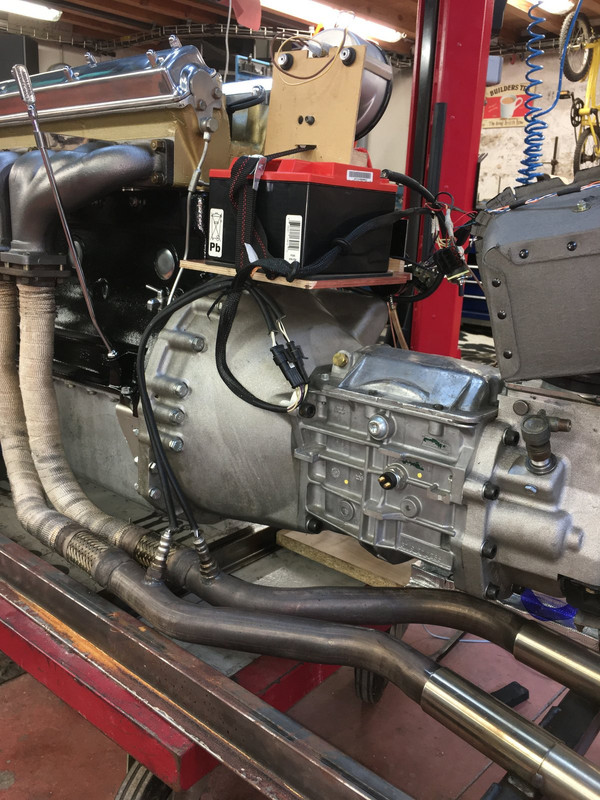

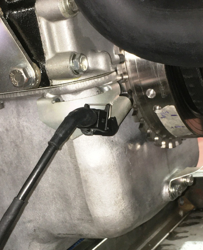

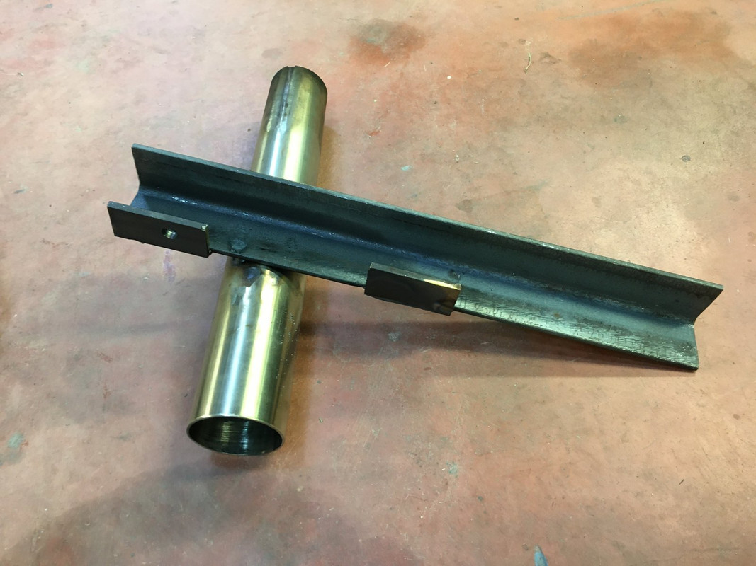

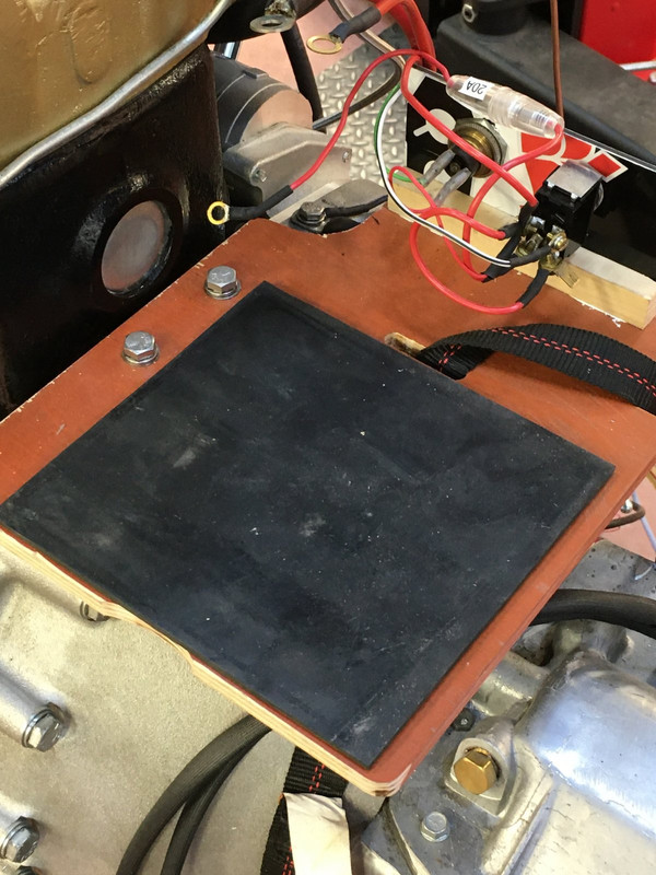

Post by rfs1957 » Sun Jan 24, 2021 10:21 am
Tests now completed - it's ready for your white-van-man to collect, Angus.
I took these pictures before I dismantled it all, hoping they may help others make a similar thing, and avoid some of the pitfalls.
My main motivation was to see whether my MegaJolt installation (which is very different) worked, and to get to grips with the programming.
I was also able to check that the clutch-release fork behaved correctly following my tweaks.
It was never my intention to set up the original dashboard, or make a "cockpit".

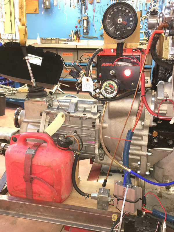

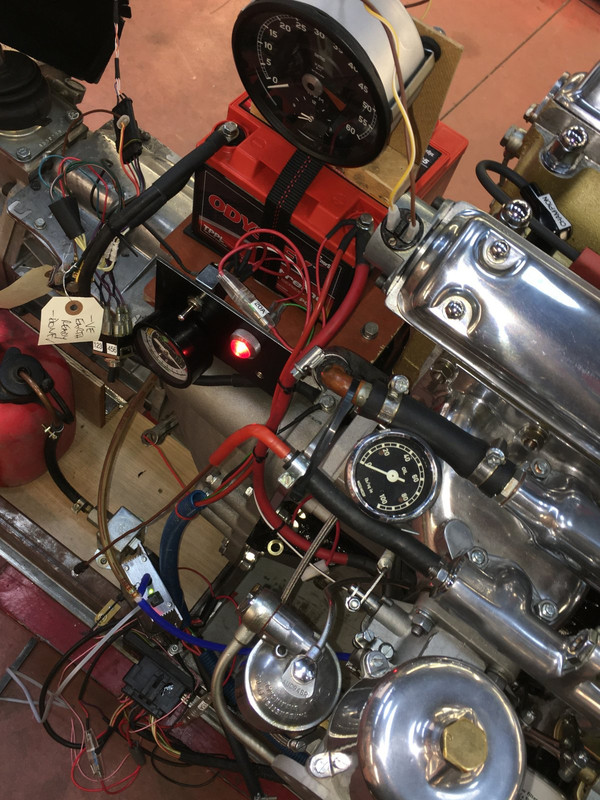

I used a mechanical oil guage plumbed into the lower oil rail to give me pressure, a pressure guage on the temperature-sender fitting to enable me to check tank-cap functions, the rev-counter to compare the digital MegaJolt screen with the original readings, and a vacuum guage to try to understand ported vs manifold suck.
I should have wired up the Jag-Club oil pressure guage to see a) whether polarity matters (am moving to -ve earth) and b) compare the readings, obviously, and now regret it.
I only just put the engine high enough to enable the exhaust headers to clear the frame, and this is definitely one of the key parameters you should incorporate very early on in your design.
I had also completely ignored where the exhaust lay in relation to the gearbox rear mounting, so had to modify the very elegant original bracket with a flying truss / botch, which worked perfectly but could have been improved on if were to do it again.
(Note to David - note the 1-2 MJ map switch on the lower frame !)
I used the twin-Lambda readouts that are hidden (because hinged) in the LH cubby-hole, to reassure me about what was happening in the carburettor department.
Of course, you could do all this and ignore the gearbox, in which case it would be easy to make rear supports that pick up near the triangulations at the bell-housing / block interface ; but despite the smooth-running I think it would be a good idea to use a pair of big Silentbloc-type rubbers somewhere.

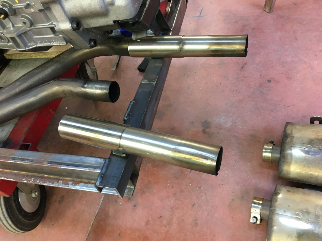

Mounting the exhausts is a potential pain, as it's vital to get them outside which can mean umpteen disconnects.
I supported them simply hung off a trestle at the rear, but made a pair of intermediate tubes, slightly conical to facilitate connection.
One is mounted to a piece of angle that simply slotted, loose and QD, over the rear frame, the other free-floating, just resting on the first, and this made hook-up much less tricky, less orientation-critical - and also got the silencer boxes further back ; I again hadn't focussed enough on where the exhaust would lie in relation to the test-bed.
Using the bell-housing to carry the battery freed-up the space in the lower frame, of which there wasn't a lot in my design, and I should have considered the petrol-tank earlier in the design - but got away with it, just.
Yes, it took quite a bit of time to knock this up and tweak it, but having run it for a total of a couple of hours in all, and been able to address leaks, check all manner of potential engine-out issues, and - for example - test and judge that the cams I had been sold were crap for road-use, and switch them back to standard, overall I think it's been a most useful intermediate step.
