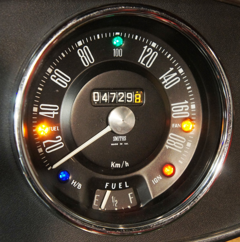

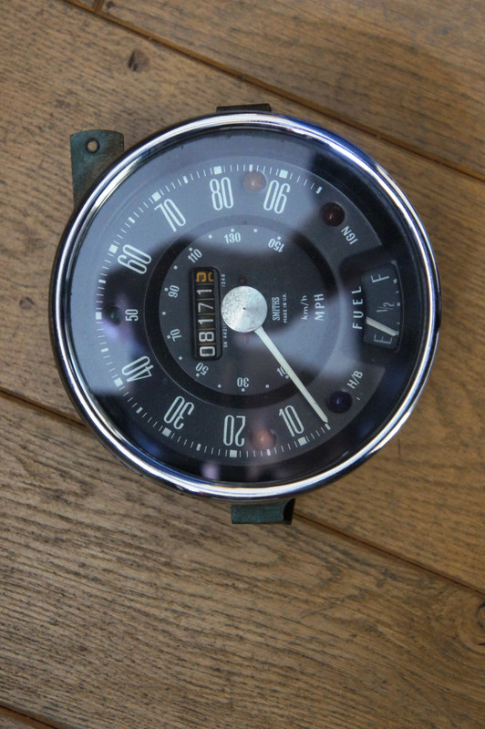

They recalibrated my 1380cc Mini Van speedo, which couldn't cope with 105mph as standard, and they added various warning lights and titles, very clever - and indescernible to the untrained eye.
Same sepeedo, Before :
and After :
And they recalibrated the Jag speedo now come to think of it.
