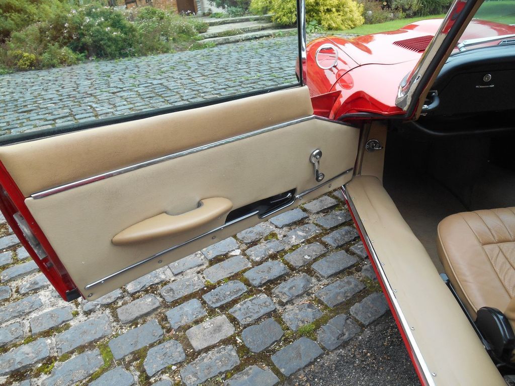

It appears that my ex.US Series 2 2+2 may have been fitted with Series 3 doors, at some time during it's life, as the fixing centres for the armrests/door pulls is 166mm, ie. considerably more than the Series 2 armrest fixings. Can anyone who owns a Series 3 please confirm that this measurement is correct?

Hi Tim...as far as im aware the S2 & S3 armrests are the same.....Steve

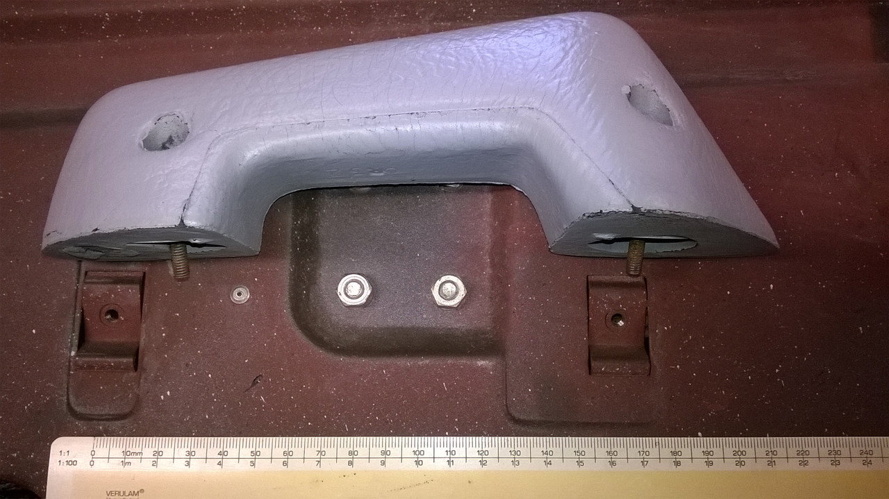

Hi Tim,
Part numbers for S3 and S2 armrests and 2+2 door skins are the same.
Pictures are from my S3. Fixing centres are 5.5ins.
Bob

Hi Tim..they may be refering to the S1 2+2 armrests...possibly torpedo shaped...who knows what previous owners have fitted in the past...but your car a 1970 S3 should have the type that me and Bob have shown....Steve

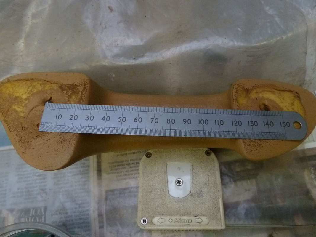

S2 2+2 had no armrests until around the middle of August 1969 when the moulded type were introduced and then carried on into S3 production.
This is a S1 2+2 armrest but I have no dimensions for the mounting points:

Looking back at pictures of my S3 doors, I see they have an unused mounting nut which could accomodate a longer armrest but I have not yet seen an original S3 with anything other than the standard moulded one fitted.

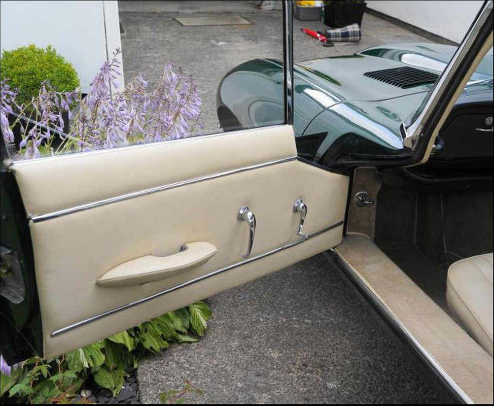

Found a pic of the longer "pointy" armrest fitted to a Series 2 2+2, identical to mine.
Anyone have any idea where I can get a pair?

Have also included a pic showing a standard armrest (from Aldridge Trimming) showing how much shorter it is than my fixing bolt holes.

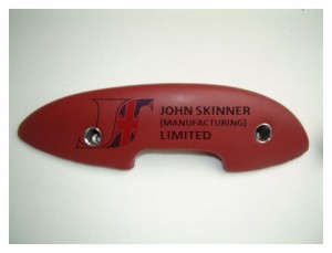

As i posted in a post above....Skinners on the photo. ....possibly BAS also sell them
