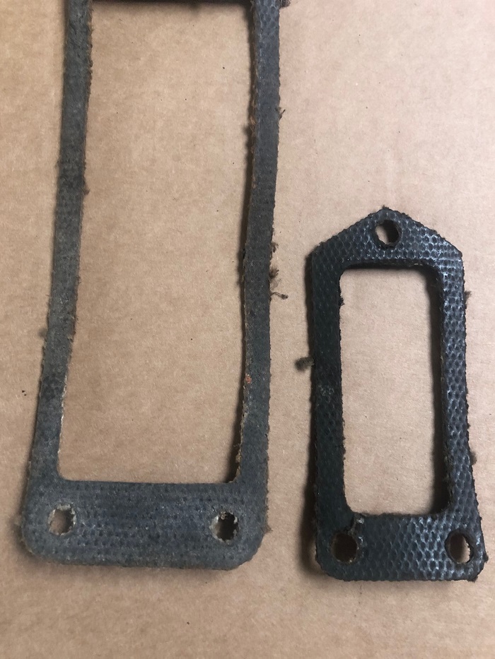

Did anyone ever have any success in sourcing a material that replicates the original composite / matirx / fabric style gaskets used as gasket material for example for the bulkhead mounted pedal boxes and blanking plates, and the bulkhead mounted bonnet alignment pin receiving catch brackets.
I don't want to fit the rubber parts which are all I can seem to find.

I think the basic material to built them could be thin flat belt
Mich

I believe the gaskets were produced by Stephens Gaskets Ltd, an associated company of Stephens Belting Co, 94 Snow Hill, Birmingham. The latter also owned Thor Hammers and as Mich says, the gaskets were made from the similar materials as the belts. Stephens Gaskets Ltd are still in operation but no idea if they will be prepared to cut gaskets for you or supply the correct sheet material: https://www.stephensgaskets.co.uk/gaskets.php
"Stephens Gaskets Limited produces gaskets and shim washers for many manufacturers, both in the UK and outside. Customers range from Classic/Vintage Motor Car and Bikes Clubs, to Diesel Engine manufacturers. As well as, 1st & 2nd tier automotive suppliers and OEMs."
