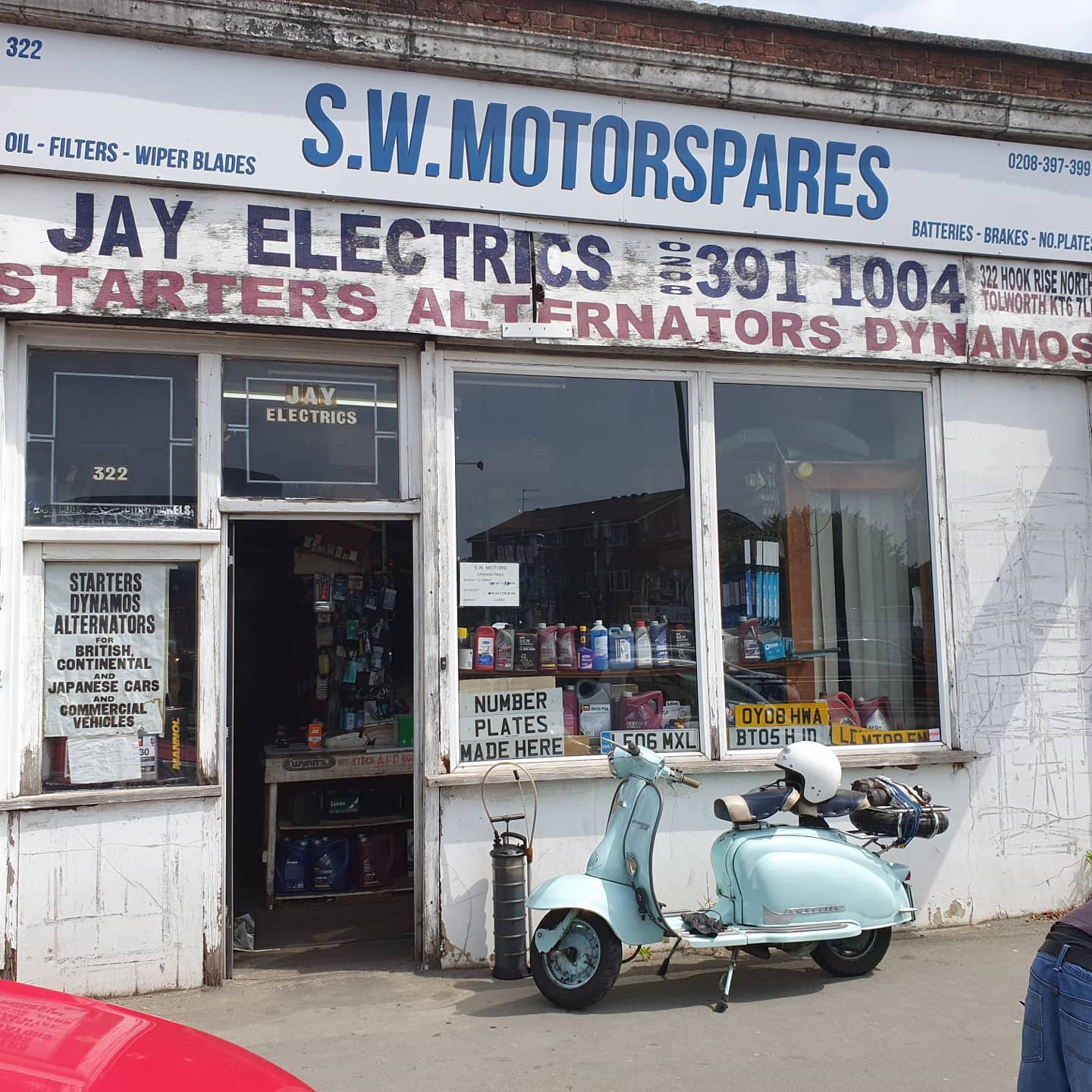

Ha, after 42 years of ownership my starter failed. I took it to the last remaining Lucas rebuild shop Jay Electrics Surrey outer London. Windings were shot. They rebuilt mine. I specifically did not want the knock off Hi Torque motors as I've heard they can get stuck and catch fire.
What a difference the rebuilt starter made. Cranks like a billeo, car starts better. Age old problem that as things deteririte you don't notice. As mentioned SNG do a rebuild service also, I have no experience but this I would go for if I didn't have my local guy.
