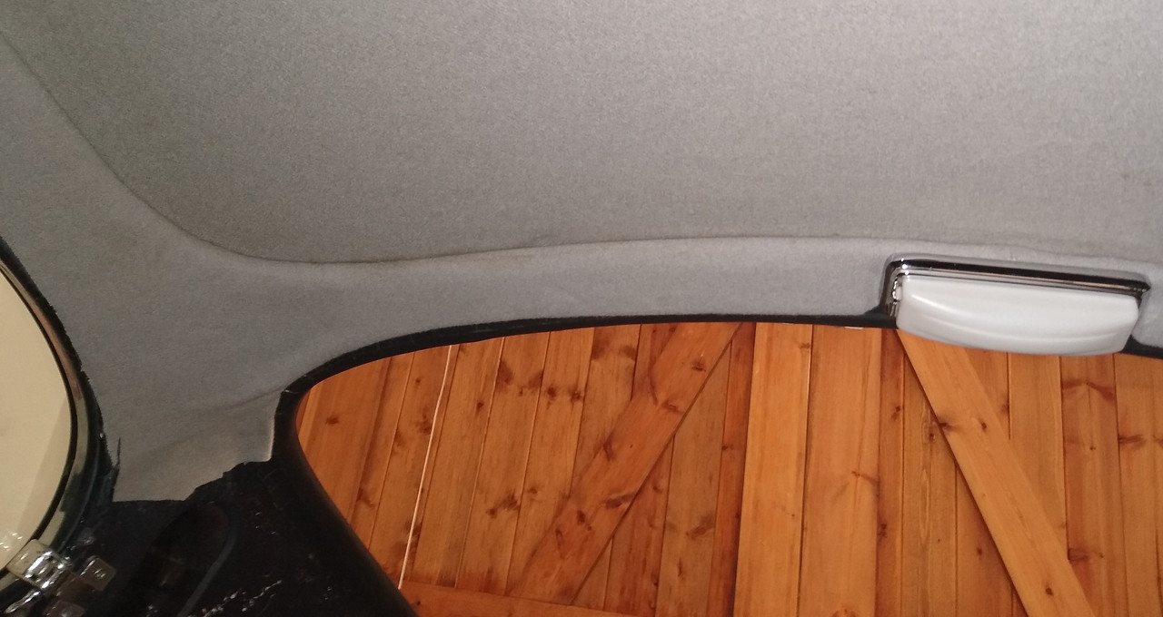

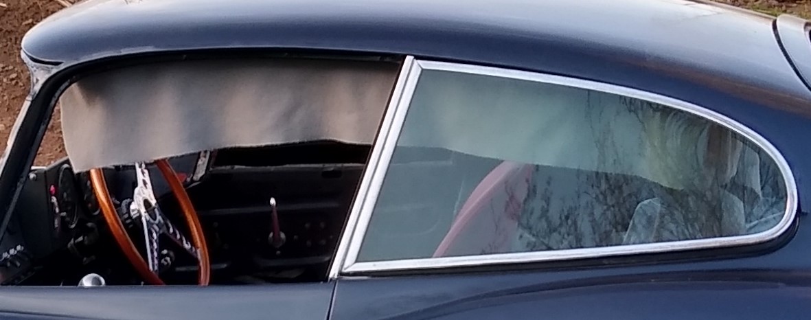

Hi Bryan
I think you are referring to the side curtains, which are fitted as shown in the photos below. The rubber tube is squeezed behind the cantrail panels and the cloth glued onto the cantrails. I found this to be an awful job but after a weekend's work it turned out half decent.
I think the parts that you refer to are correctly called the cantrail crash padding assemblies and these are fitted to the cantrails after the cloth trim has been fitted. After these are fitted you can then fit the quarterlight hinge pillars, seals and quarterlights etc.
You will note in my photos that I have incorrectly fitted the quarterlights before the crash paddings have gone in. Requiring a bit of re-work.:banghead:
