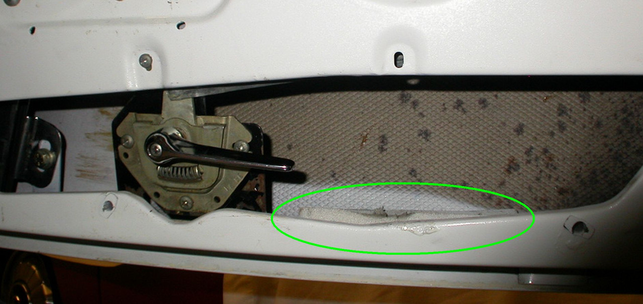

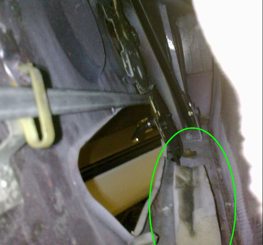

#4 Re: Mystery window regulator part
Hi Mark
A couple of images which may help. If you enlarge the first it shows what looks like a foam block (hopefully closed cell). The second suggests that it is of square section. You can scale the length from the door lock handle but it looks about 4"-5"x1"x1" overall.
