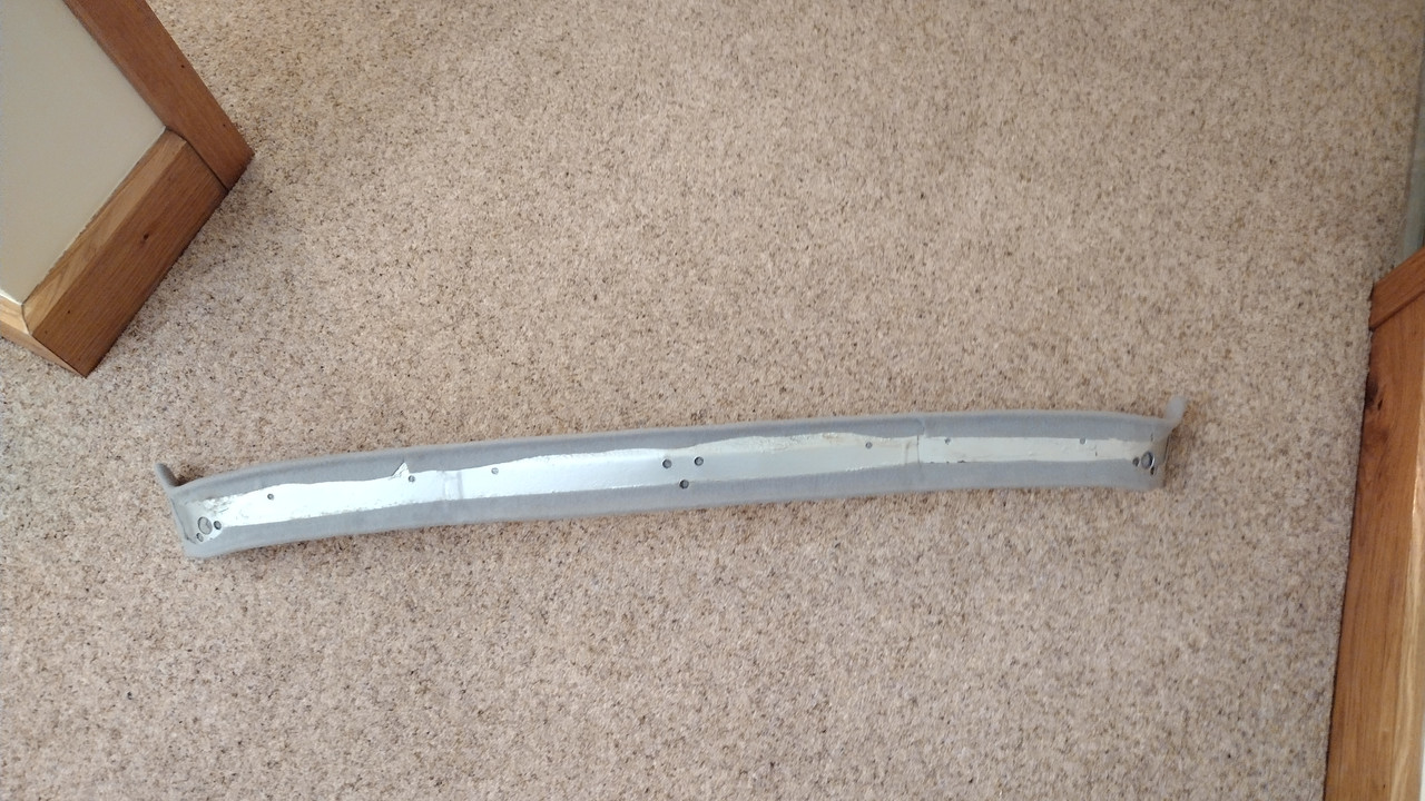

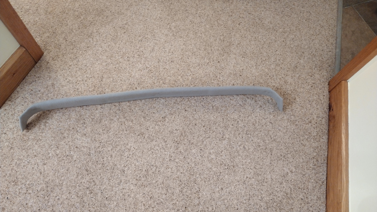

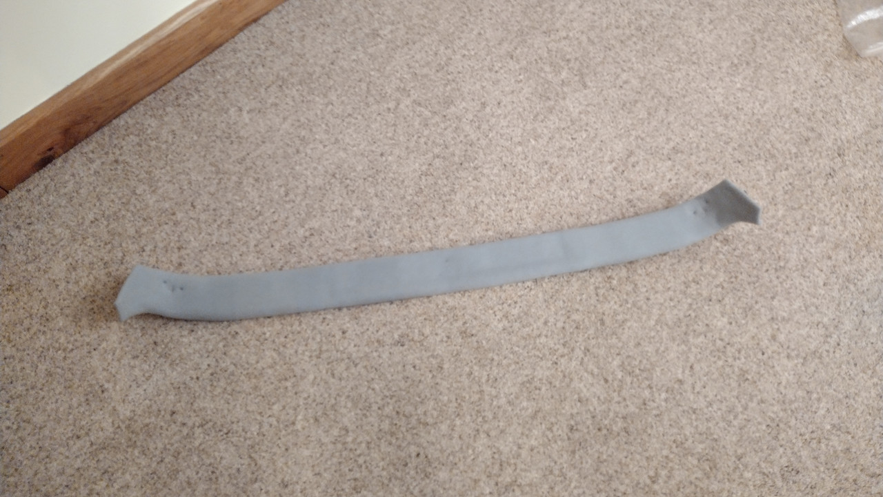

Do you think this is what you are after?
This one is mine ready to go in to my 3.8 coupe.
I'm pretty sure they are no longer available, although you could check with Richard Smith to see if he is aware of any availability. I got mine from Ken Verity a few years ago.

my thanks for going to the trouble to display the pictures, ....off the top of my head I'd say yes, that looks like the part, certainly from the (small) image on the SNG Barratt spares page.

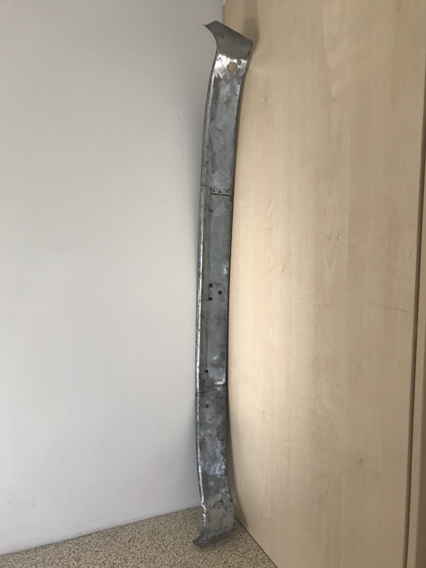

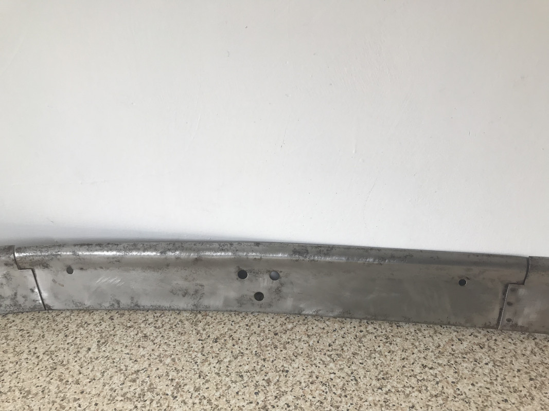

I think I might have some photos of the un-trimmed panel. I'll have a look tomorrow.
Posts: 1778
#5 Re: 2+2 headlining installation
Post by Series1 Stu » Mon May 09, 2022 4:51 pm

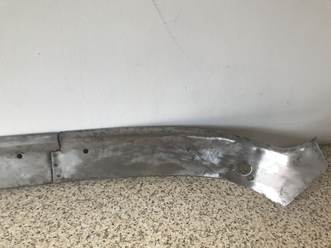

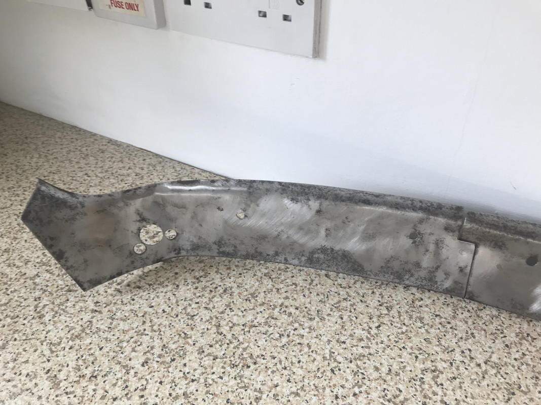

Hi John
See attached for some images of the panel before it was stripped, painted and re-trimmed.

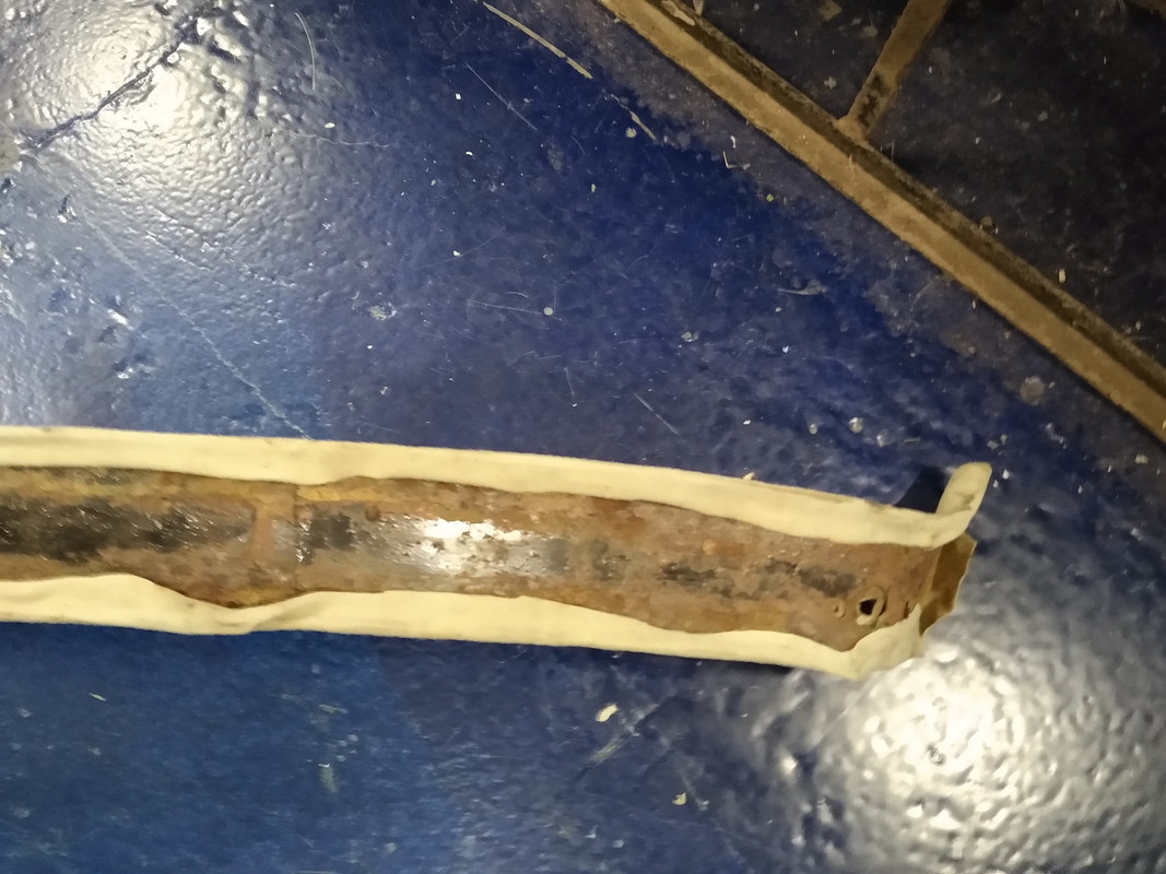

You've slightly confused me here. The pictures I posted are of a pressed steel panel that is covered in headlining material and is fitted above the windscreen and held in place by the rear view mirror and the sun visors.
I thought I had some pictures of the panel without the material attached but I can't find them. I would have thought that your car would be the same but others here might know differently. I only know what is relevant to the series 1 coupe.
I hope you manage to find what you need.

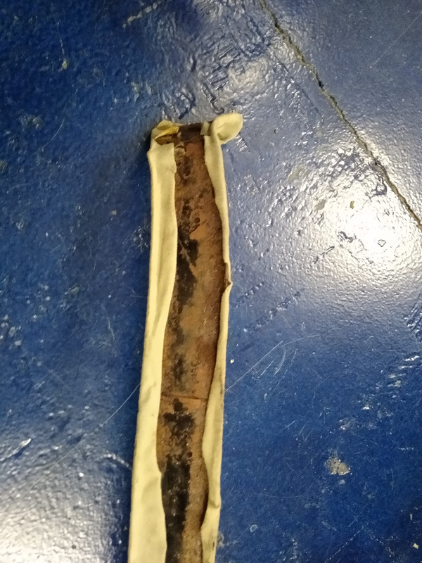

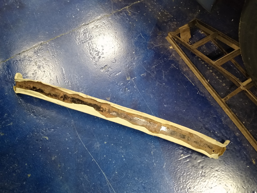

If it helps, from my ‘63 fhc…
Posts: 1778
#10 Re: 2+2 headlining installation
Post by Series1 Stu » Wed May 11, 2022 2:35 pm
That's the fella!

again, thanks for your input both,
these images give my restorer the chance to fabricate what's needed.
I've asked around the usual places and checked out Chuck, however knowing as we do, they'll probably be found at the Jaguar Spares Day. Unfortunately that'll be too late as we're almost 98% complete.
hence we'll fabricate based on these photo's
