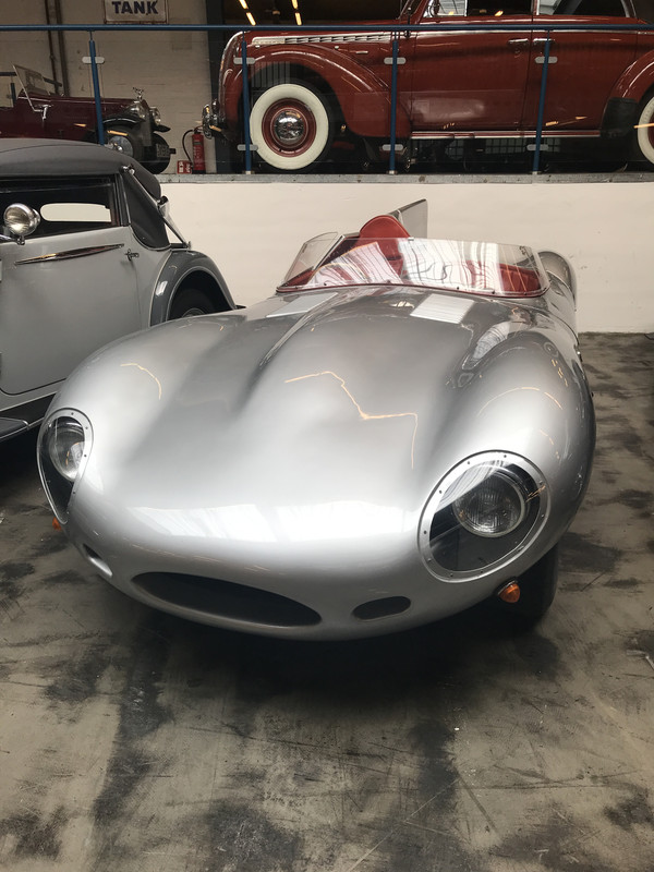

Thats interesting. I will get pictures of their installation. The car belongs to PS Speicher, Europe‘s biggest vehicle collection. Its basically a Lynx I think, was an E- Type S2 coupe former in its life, and has an alloy body. We talked about it ages ago I think. Did I not upload pictures of it ?

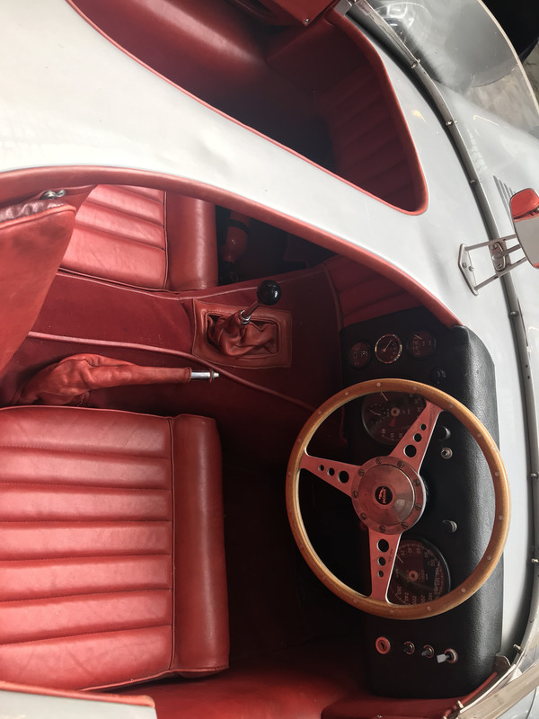

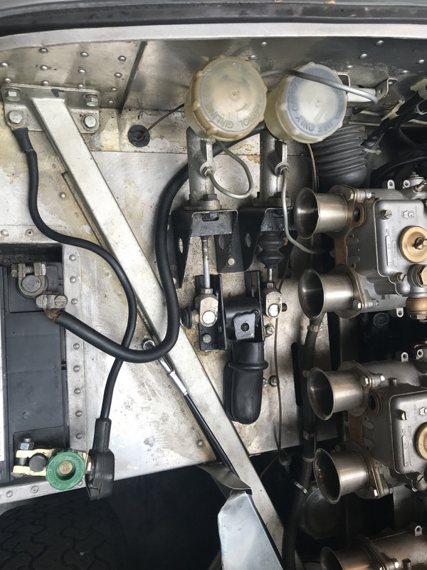

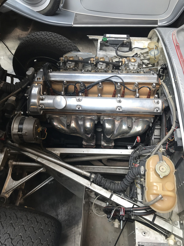

Here are some pictures- as you can see, your feet are in some kind of tunnel, where the pedals are. On top of the tunnel there is an arm which actuates a cylinder which actuates 2 cylinders, and that setup can be adjusted. Hard to describe, easy to recognize how it works when you look at it.
From the 2 brake cylinders, there are metal pipes going to the LH sill front edge, where the 2 power units sat.
I see no way to fit an E unit.
This D Type is completely made from alloy.
