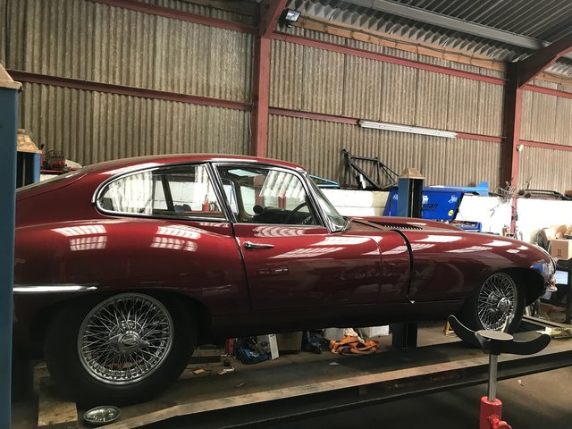

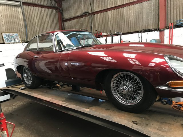

I fitted Girlings recently but can’t tell you how they ride as the car hasn’t moved since. I’ve got a couple of pics that might give a clue on ride height (maybe I’m the one you consider too high?). Hopefully the car will be finished in the next month and i can give them a try :smile:
Thank you , in fact it was your car that looked too high to me, but that was another photograph. This photo looks more like it, perhaps they have settled since you fitted them? I restored a US series One and powder coated the original springs and it sat just perfectly. Why reproduction cannot get it right is beyond me. Everyone seems to make stiffer and think that is better. Stiffer by definition means they will sit up higher with same body weight. Anyway perhaps someone is actually running these??

Here’s what it looked like before changing to Girlings - at this ride height the exhaust was scrap. I would expect the current height to settle a bit after use.

The "before" picture of the maroon car definitely looks too low to me . Most springs sag with age, and I think the result is that we have come to see cars with such springs as the norm, and therefore( incorrectly ) regard new springs as being wrong

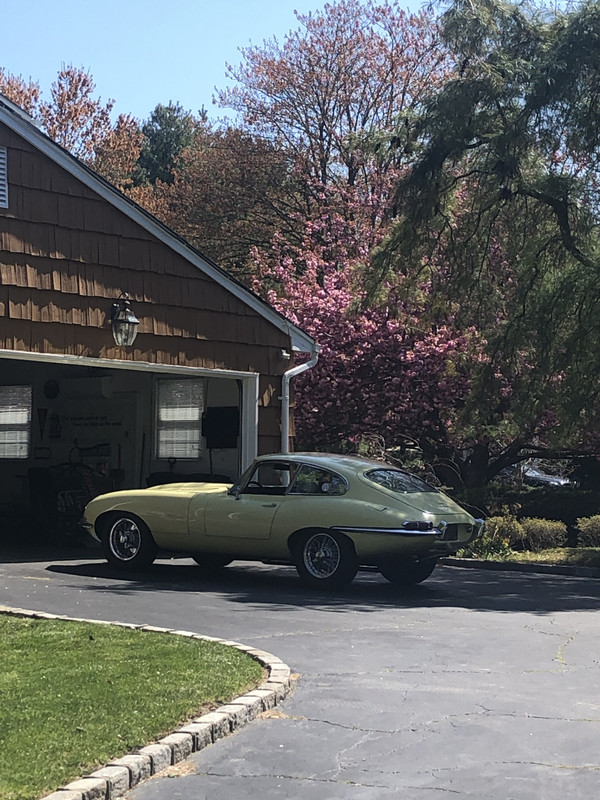

I used the SNg total set up.
Our cars are 55 years old.
When first installed without gas you thought I purchased a Chevy 4 x4 blazer !
Now 1 years later and 8,000 glorious miles it sits puuuuurfect!

She looks good. I reckon pretty much like factory spec. Thanks for the reply
