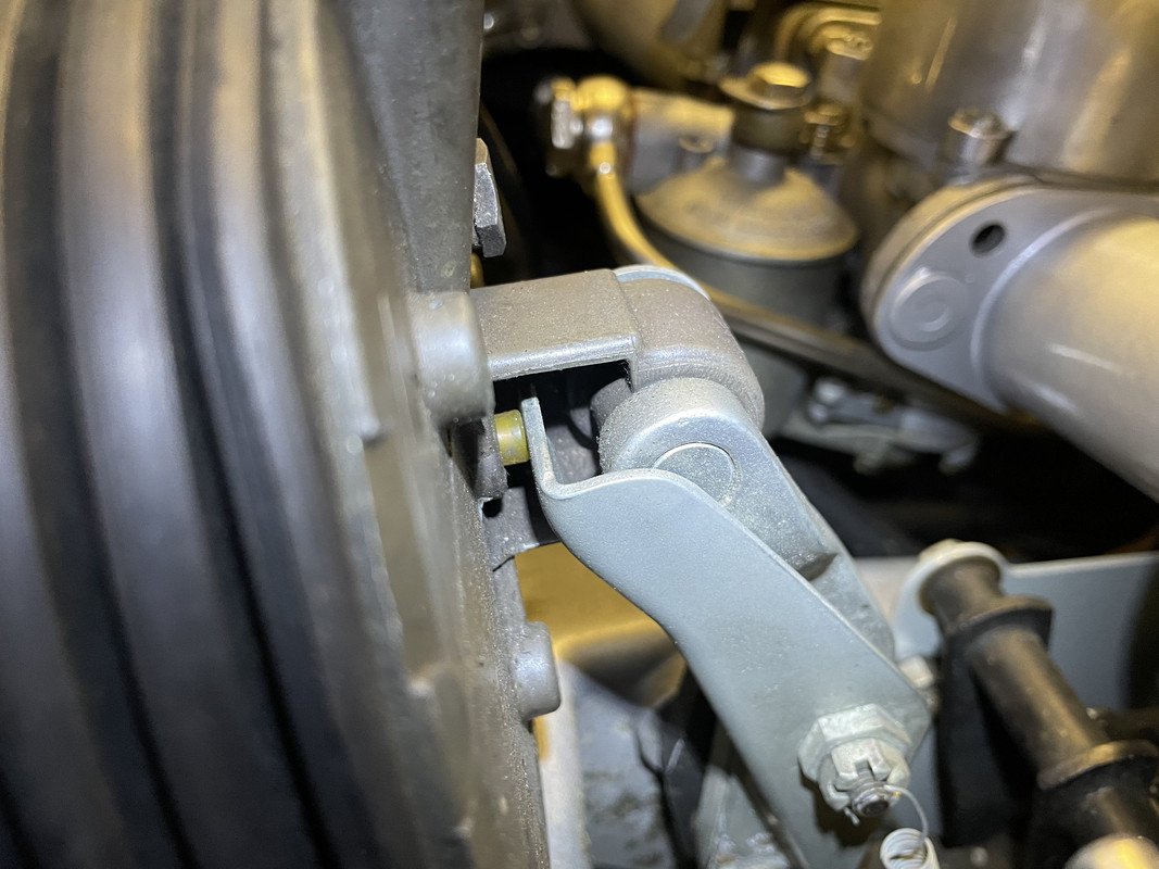

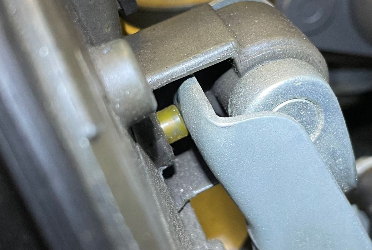

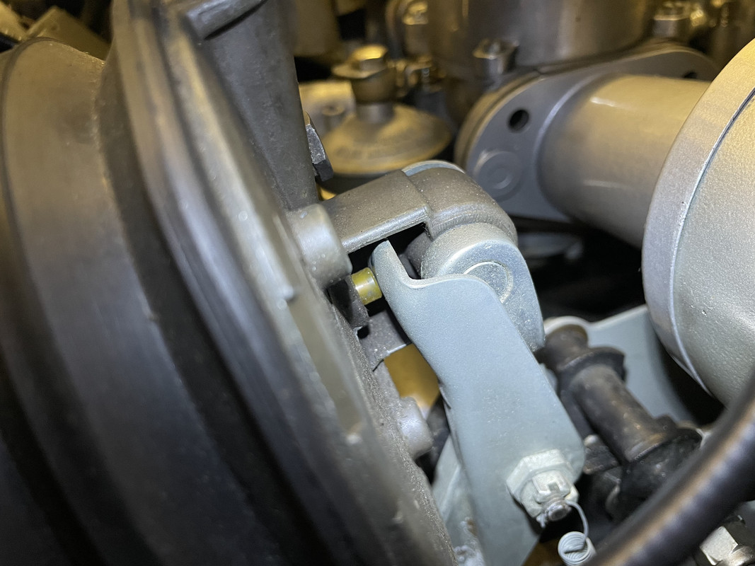

Having a look at the little valve in the front face of the bellows cover plate. I took these two pictures as I was interested to see what happened to this thing as soon as the brake pedal was depressed… It doesn’t really look like it’s doing terribly much moving which makes me wonder have I got the adjusting arm in the wrong place completely….and it isn’t allowing a vacuum to build up at all….?
Do these pictures look how it should all do I need to be adjusting the lever ….?….the first picture is at rest….the second is with the pedal fully depressed

Well, it does look like that valve isn’t being activated.
A couple of observations;
Firstly, there is a setup procedure in the service manual which is pretty straight forward to get it correctly set up. You just need to loosen that castellated nut (with the spring attached) and adjust accordingly.
However, I doubt that has changed overnight causing your problem.
Secondly, it is quite easy to test - just use a thin screwdriver and activate that button and (with the engine running) the bellows should be easy to just push in.

Looking at the picture, I wonder if the valve in the bellows is always actuated and so there is a constant slow vac leak.
There should be a gap between the arm and the button.
