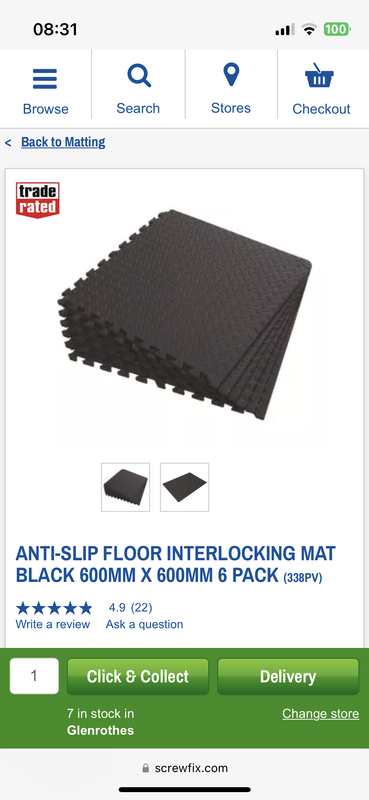

Thanks everyone for your responses. I’m fortunate in having a brand new, uncluttered floor which is level. I have decided to go for these tiles:-
They get great reviews and are very hard wearing.

Interesting, and a decent price (these days). But:-
How do you cover a whole floor when they are only slotted on two sides?
They would have to be laid in double width strips with no interlocking between them.

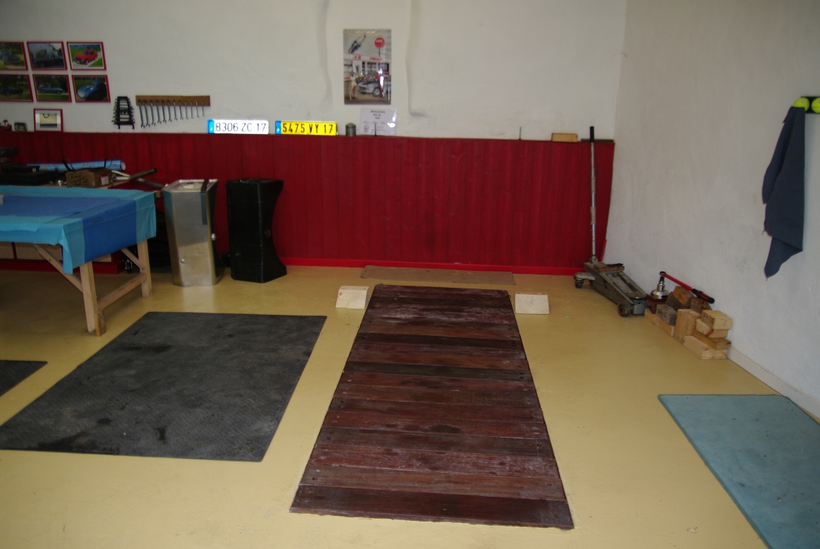

Hi Alan i have done what you expect : Epoxy on a flat concrete and some paths with smooth tiles , the one you have on your last post.
But BIG WARNING : the Epoxy is VERY slippery..... when wet ( ask me why...!)

Alan - have you checked these? They look exactly like the packs that I have previously bought from Costco, which come with removable edge finishing strips. Whilst they are great as a cushioned floor for standing or kneeling, they are not suitable for heavy loads, and will certainly squash under an axle stand etc. Just suggesting you check them before leaving Screwfix...

They're marketed as garage floor tiles in the blurb so should be OK. The tiles are also marketed as non slip and have the checker plate relief on them for enhanced grip.
I checked the reviews and several people were singing there praises as garage floor coverings.
Only time will tell I suppose.

I tried these tiles,, of the appropriate industrial grade, on my new floor. They were quite pretty and pleasant to walk on but to work on they were less than optimal!
They moved easily when rolled over by a laden trolley jack, which became much harder to move itself. Anything that sits on them in one place for more than a few hours leaves a mark. Unless your axle stands have big feet, you will probably find the matting ends up “incised”.
If you want a surface that stands up to the usual garage environment, avoid any tiles of ant sort of foamed neoprene, if you use thinner tougher “vinyl” type interlocking tiles glue these down. Better still, I.M.O is to buy industrial machine shop flooring on the roll and stick it down.
