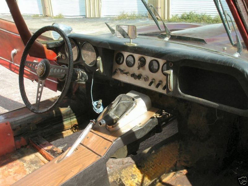

I'm not 100% going for originality, but almost all my center console has been butchered by the once American owners, so I have to do something to it anyway. I have the alu for gauge panel and shifter surround, but the vertical part on the radio stack and all the alu on the center console is gone. Look at the plastic wood that has been riveted in instead! Wonder if they just threw the alu in the bin? Also, my interior is red, but everything on center console is black.
So what should it be? Red material? All alu? From reading now maybe 10 E-Type books, some on originality, I see that it changed during 3.8 production, but also that it changed gradually(?). So what would be right for my March 63, 888409?
The picture is from when it was for sale in the US 15+ years ago

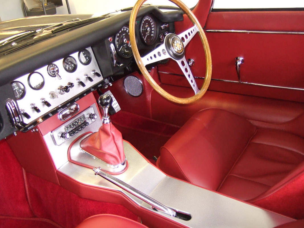

Your tunnel cover should have a matching aluminium top cover and red vinyl sides. Similarly, the missing radio console should also have a matching front cover and red vinyl sides (where the speaker grills are, but are a total waste of time - but that’s a whole other conversation!). The gear lever cover is correct with aluminium and trimmed with red leather up to the gear lever. All the aluminium panels are ‘framed’ with red vinyl piping.
That mirror on your dash is incorrect though!

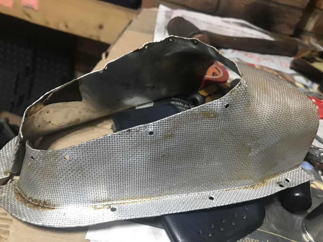

A March 63 car should also have the cross-hatched alloy trim, rather than the earlier polka dot version. Sadly, the cross hatch trim is no longer produced for the E-Type, just the polka dot. There have been posts on here regarding the use of a similar alloy trim that some modern Aston Martin cars use for sill trim, but that is a whole heap of work!
E-bay etc sometimes throws up som bits of cross-hatch trim but it’s quite rare now.
This is an example of the cross hatch trim found under the vinyl in my November 63 car. I couldn’t get all the remaining pieces so had to replace with polka-dot.

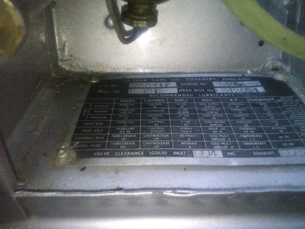

I have a 3.8L OTS 07/01/1964, my center console, the radio panel and the instrument panel are black is it correct?

For a '64 the instrument panel & the speaker grill panels should be black. The radio panel, console centre top & sides should be leather, same colour as other interior trim.

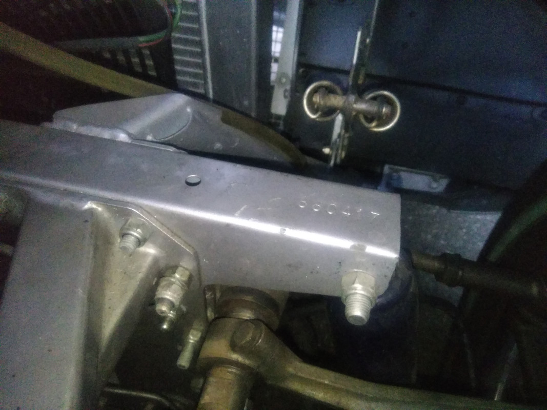

That's strange, Pierre. Have you misquoted your chassis number? A LHD OTS should have a chassis number starting 87****, with the earliest being 875001. LHD FHCs started at 885001, making an 880*** number incorrect.

It is correct: http://www.xkedata.com/cars/detail/?car=880417
Late 1963 OTS had numbers starting 880, the FHC's had 889. Bit of a heart stopping moment for you there Pierre
