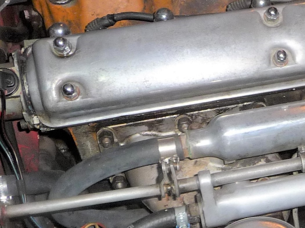

It seems that indeed the intake side of the cylinder head was also painted although not easily visible.
Here is a detail picture on my car whith traces of paint on the rear part of the side.
P1240728 (3) détail.JPG (181.95 KiB) Viewed 37349 times

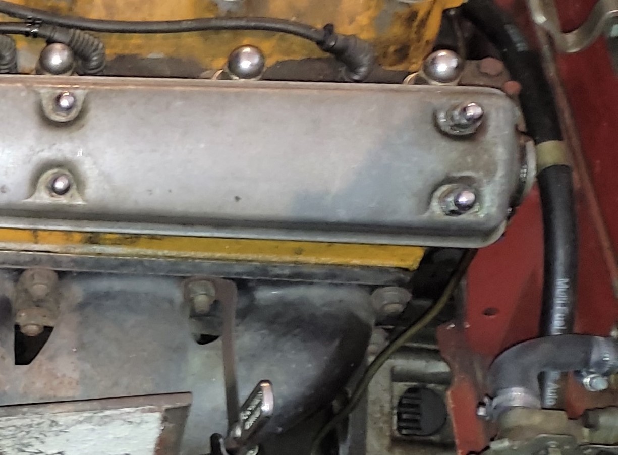

On the exhaust side the paint is well all around.
I believe that it is still the original paint.
IMG_20220221_141338 (3) detail.jpg (187.89 KiB) Viewed 37349 times
