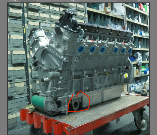

#1 What connects to both sides of the images attached?
Post by MGB911 » Thu Feb 06, 2025 5:31 pm
:fingerscrossed: Hi can someone tell me what connects to both sides of the v12 where I have circled please
MarekH
Posts: 1752
#2 Re: What connects to both sides of the images attached?
Post by MarekH » Thu Feb 06, 2025 6:58 pm
Buy a copy of the 1974 Parts Manual and all will be clear. This is how the water pump sources its cool water from the bottom of the radiator.
MGB911
Posts: 5
Joined: Wed Jan 29, 2025 4:41 am
#3 Re: What connects to both sides of the images attached?
Post by MGB911 » Fri Feb 07, 2025 7:43 am
Thanks Marek I have that and got it two water elbows that’s great thanks

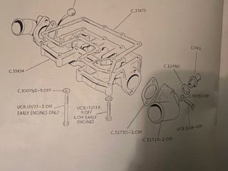

deano1968
Posts: 6
Joined: Tue Feb 04, 2025 8:34 pm
#4 Re: What connects to both sides of the images attached?
Post by deano1968 » Fri Feb 07, 2025 5:36 pm
Hope this helps?
