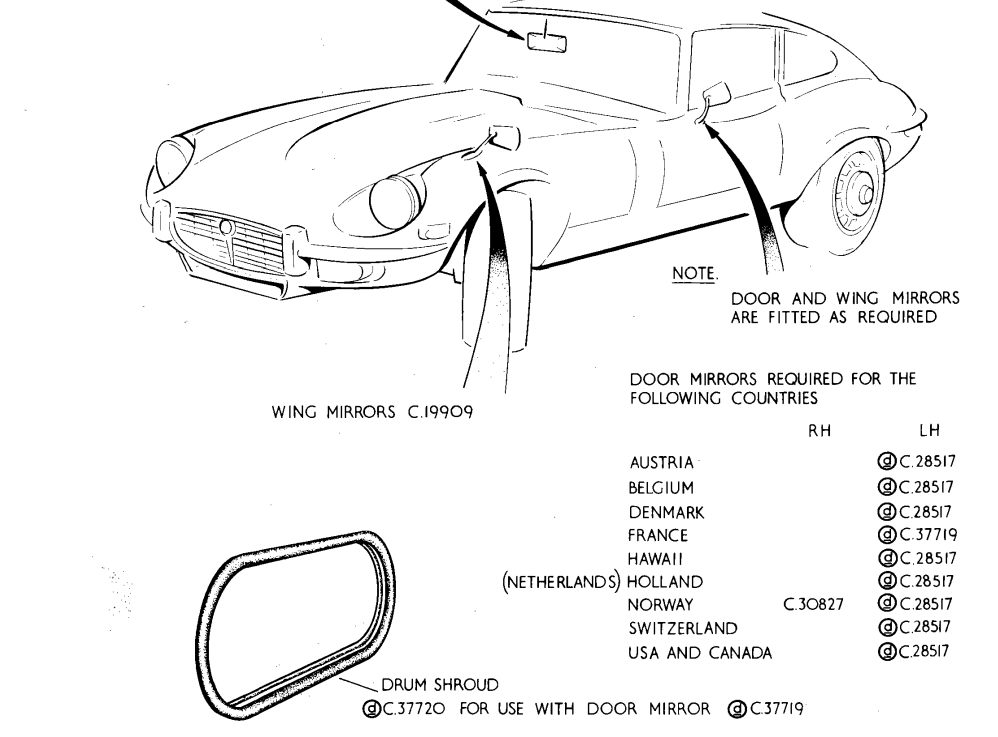

I think those are going to be all of the standard "Tex" mirrors. The remote control mirror was an optional extra so ought to appear in the final two pages of the 1974 Parts Manual. It's shown on the index microfiche page, but when you follow that up and look at the actual page.....it's missing. Perhaps it might be worth looking in the Technical Service bulletins.

I checked the SPB and there is no mention of mirrors. The illustrated SPC is all there is on mirrors, the options page does not mention remote mirrors. I think you are correct, these were probably XJ remote operated mirrors fitted retrospectively to the S3.

After much digging, I found "SERVICE INFORMATION" VOL 1 NO. 4 dated June, 1972, item 49, subject Remote Controlled Mirror. This document lists part number BD.40822, Assembly door mirror remote control.
So, now it's official, this is the part number I'll be looking for and since SNG lists an improved version of this, I've just placed an order for one. We'll see how this works out! :fingerscrossed:
