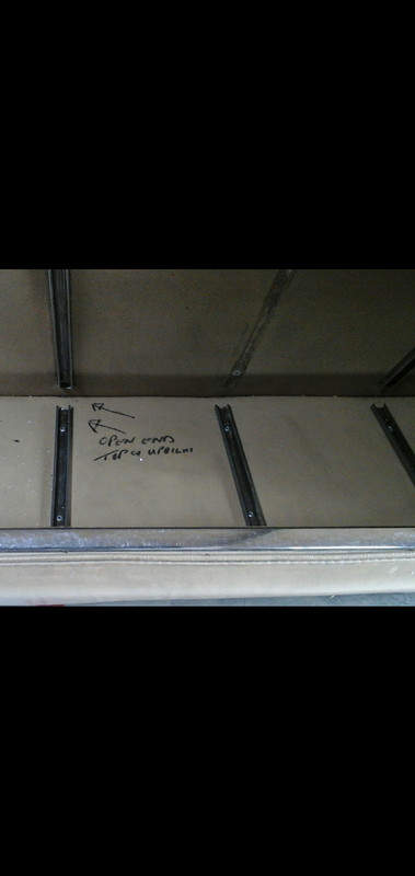

A couple of the chrome/rubber rails in the boot of my 1966 2+2 had come loose, so I investigated trying to refix them today.
Looks like they are held with rivets that had corroded and given way. I have drilled the old ones out, but can't figure a way to refix them. The head of my rivet gun is too large to fit inside the chrome channel. I tried to make a small brass extension for the rivet head, but the rivet doesn't seem to go in far enough to grip. Using 3.2mm pop rivets.
What were the original fixings/tool used, or is there an alternative? Thanks!

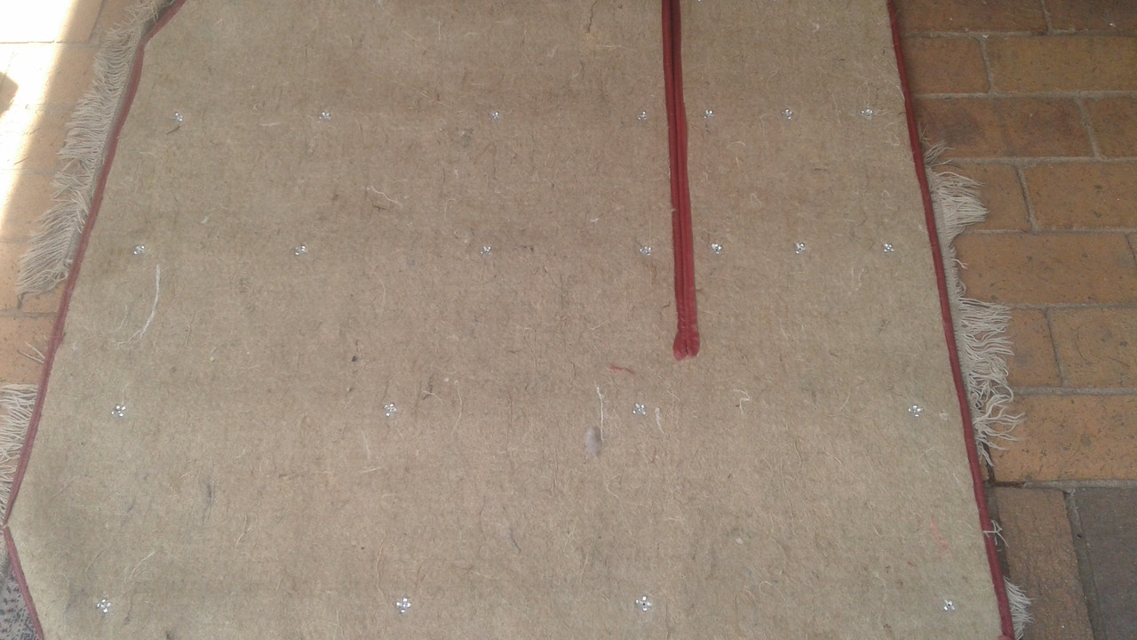

The original items are no longer available, but I bought something close where the solid section was slightly longer and used washers under the rubber rails to take up the difference in height.
I think I used a brass drift to flatten the rivets over. Then came the fun of fitting the rubber rails.

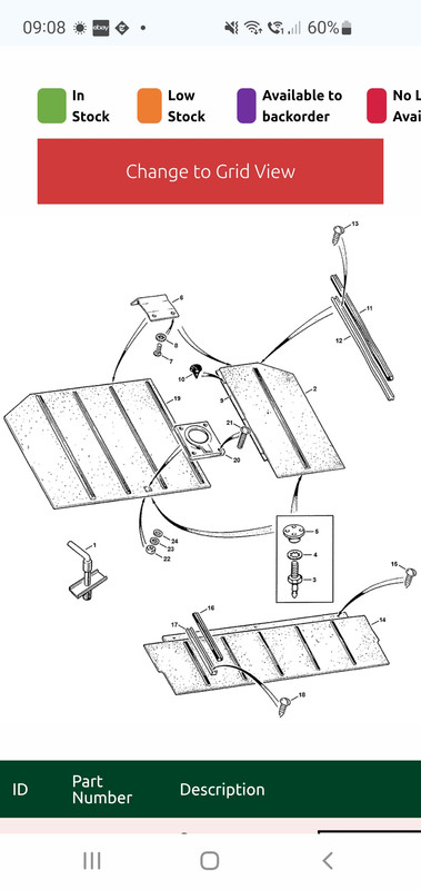

Looking at the parts catalogue in the Knowledge base it lists self tap screws holding the retainers.....later S3 cars used staples....Steve..PS Robey drawing

Self tappers wont work on the hardura mats, which is what the early cars used.

The original poster has a 66..2+2...I think he has boards?..Steve

#12 Re: Boot luggage rail fixings
Thanks all. I tried a small nut/piece of metal but couldn't get the rivets to grip - may just be about too short.
As per above - car is using boards so I may resort to self tappers...
