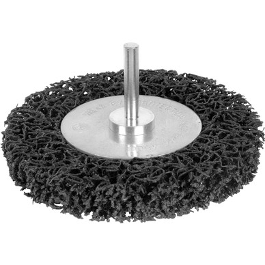

If as you state in your post you want to get it back to bare metal, I've found these work well. They will remove seam sealer, paint, filler, glue and surface rust.They are available from Toolstation for about ?5.00 each. Poly Abrasive Wheel
