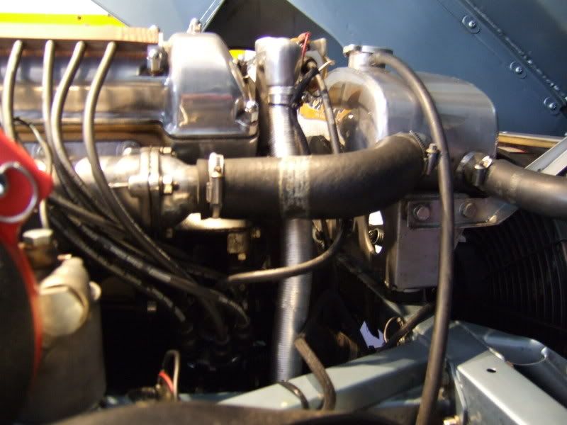

I have a curved alloy tank from here: http://www.cambridgemotorsport.com/Cool ... ader-Tanks
Absolutely gorgeous to look at and I think the curved top seems more in keeping with the cam covers and bonnet. They do conventional square ones as well if you want to be more original. Easy to fit once you have drained down the system.

The aluminum tanks by Cambridge motorsports are the first ones I've seen that look correct (the rectangular ones anyway). The round tank is very much a matter of taste. However 225 pounds is a lot of money!!
Other companies make really squared off aluminum tanks. They are less expensive but really ugly in my opinion.
The steel ones available today seem to rust pretty quickly. I regret having replaced my original one with a steel one (it is the cheapest option however).
The next time around I'll buy brass. The cost is between the other two. It won't rust. I have heard of a couple that developed leaks at the seam after a couple decades..but they can be resoldered.
