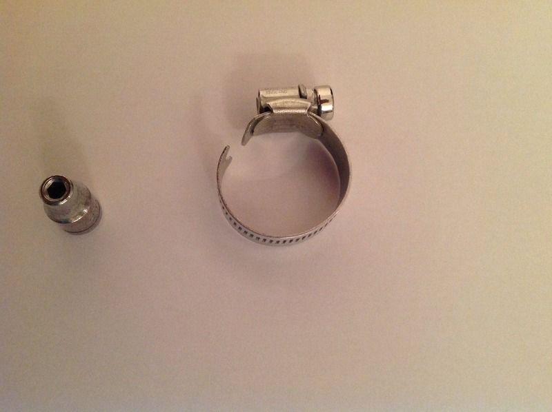

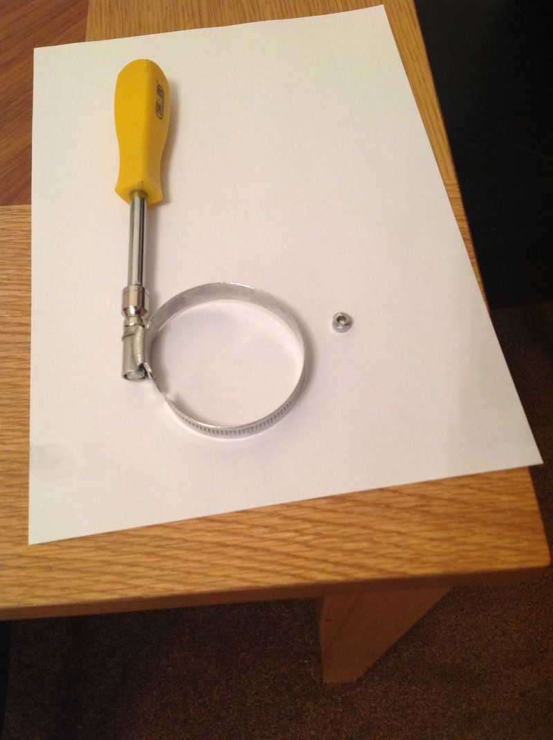

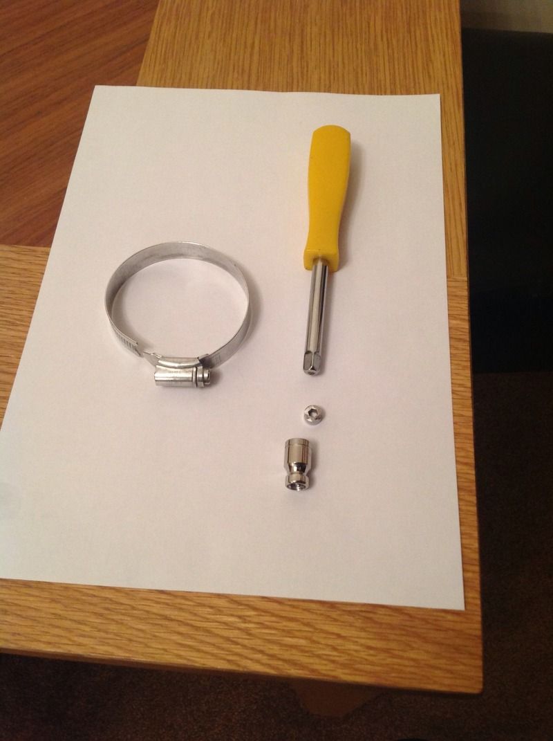

Having read the threads about the Cheney clips, I decided to see if I could make myself a special tool to make it easier to tighten them up, without ruining the heads.
Here's what I came up with....
I made the small part using the lost wax technique to fit the screw head in cobalt chrome (metal denture material) -
Fitted to the clip
Decided to cut the end off a 1/4" socket and laser welded the cast chrome section on to it, to make my 'special socket'

I didn't know they made one. It was easy to make and works well.
Adam

Hi, first you have to make a wax pattern of the part then make a refractory mould then place mould into a burn out furnace to remove wax, melt metal and cast. I have to explain that i'm a dental technician so its what I do day in day out! Luckily I'm able to make and repair some parts.

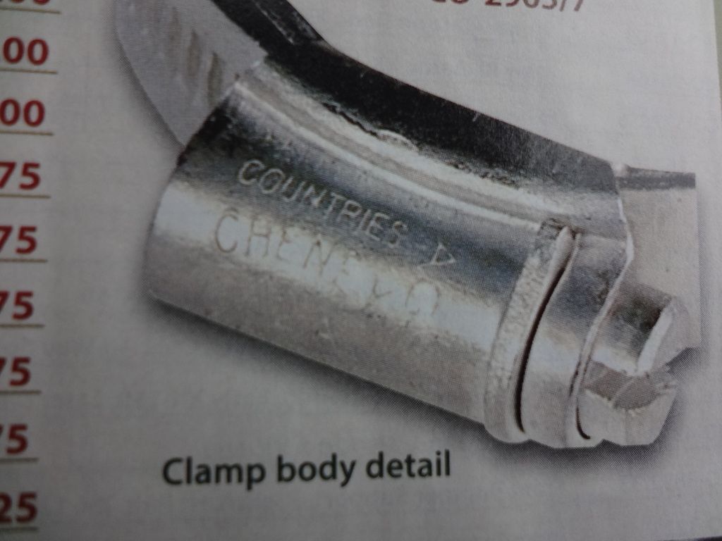

This is really clever and constructive, but don't forget you can just order Cheney style clips from XKs Unlimited in the USA.
This the recent page from their Spring 2015 "Coventry Quarterly" that I get sent from them.
