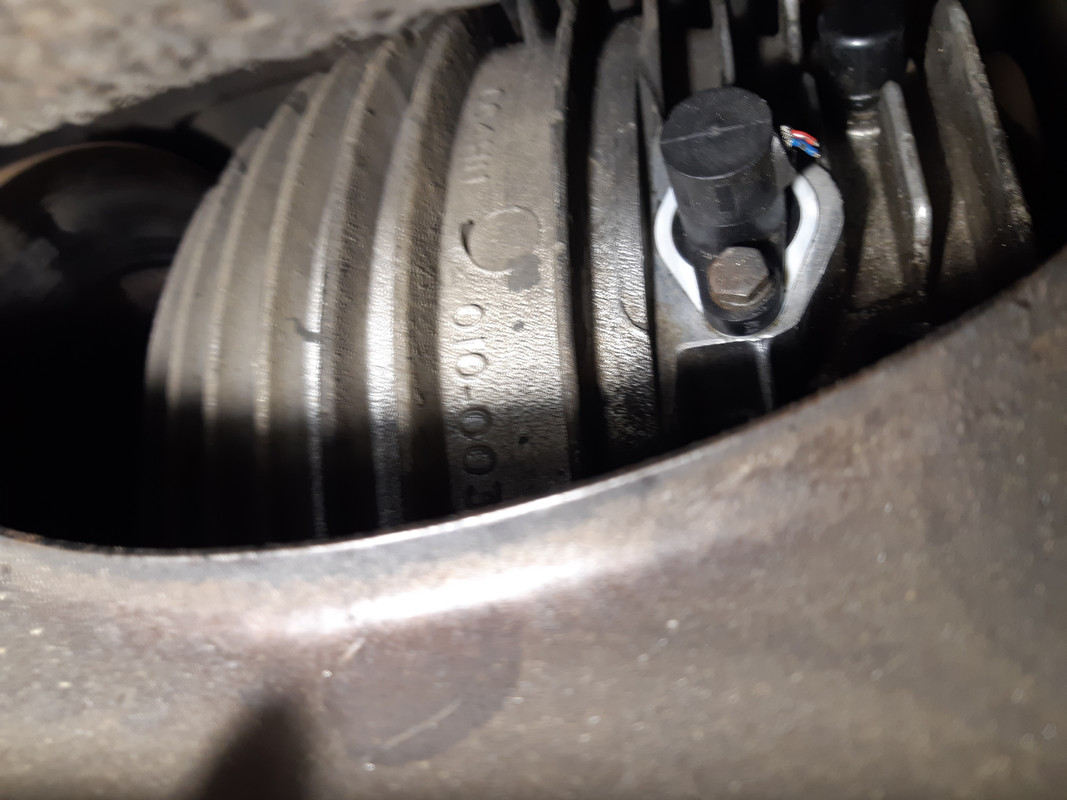

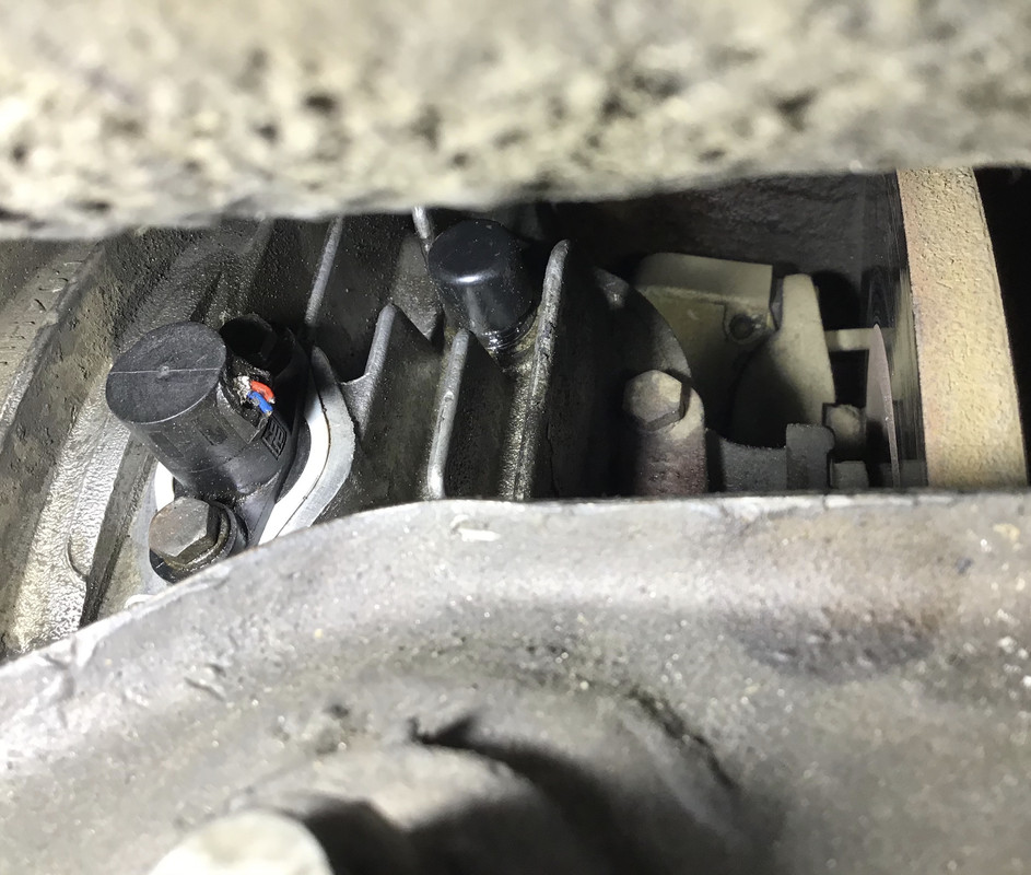

Hello. -73 e type series 3 differential.
Anyone know what this is? Was going to change diffoil on my newly aquired S3. And found a diff cover obviously not a standard part. It is a forged aluminum part with cooling fins. Were I expected to find level/ filler plug there is some kind of sensor with two cut off electrical wires, red and blue. Hold in place with two hold down bolts, one above and one below. The breather is capped off with a plastic cup cover. There is a forged in number btween cooling fins: 004H11 010-003
An after market «upgrade» with a temp sensor? Oil level sensor? Something from another model?
See photos.
Rgds Harald.

Post by dxke38 » Tue Nov 24, 2020 4:01 pm
Looks like a later diff has been fitted, probably from an XJS. The plastic sender unit is for the speedo. Not needed on an E Type.
Derek

#13 Re: Diff filler/level plug Thread and alternatives
Post by Norton » Tue Nov 24, 2020 5:27 pm
Thanks. A couple more questions arises. Is it possible that it is just the the diff cover that come from a later car, or would it be the complete diff?
Could I use the output from sensor to a XJS speedo? Guess that would be independent of actual final ratio. ( if complete diff is from xjs with internal side of sensor is present ) My speedo is very unaccurate, and speed indication is not consistent with odometer.
Final ratio have been changed at some point, probable from 3.51 ( us car w manual ) to 2,88.
Harald

#14 Re: Diff filler/level plug Thread and alternatives
Post by dxke38 » Tue Nov 24, 2020 8:18 pm
If it is 2.88 then I would think it's a complete DANA diff from an XJS. I'm sure someone would be clever enough to fit an XJS electronic speedo but I think it's easier to get the original speedo overhauled and recalibrated.

Post by Norton » Wed Nov 25, 2020 8:52 pm
Thanks. You are right about the speedo. And probable also about the diff itself. PO claims he had the crown and pinion gear changed to give a 2.88 ratio about 8 years ago. There is an old looking metal plate with 2.88 attached under one of the cover bolts. Maybe someone swopped the whole unit. It does have a drain bolt. Bolt pattern on cover looks similar to original, but does someone know if cover from a DANA diff actually fit an original diff? ( -73 e type s3 )
Harald.

Post by dxke38 » Thu Nov 26, 2020 6:57 pm
If the diff has a drain plug I don't think it can be a DANA diff. I can't confirm whether a DANA cover will fit an original diff but it looks like someone did it on your car.

#18 Re: Diff filler/level plug Thread and alternatives
Post by Norton » Thu Nov 26, 2020 10:33 pm
Thanks.
swindler, nice tip.
Found tech info on jag-lovers saying that the DANA diff have three bolts holding bearing in place on the output shaft. Judging the boltpattern on the bolts I actually can see, there have to be more than three. Other diffs have five. ( same source )
Harald
Posts: 4561
#19 Re: Diff filler/level plug Thread and alternatives
Post by PeterCrespin » Fri Nov 27, 2020 12:52 am
Dana cover bolts are a different size as I recall. I have one of those XJS covers but ran into problems swapping a nice steel cover onto a tatty steel cover Dana diff. Threads were different so to bigger Dana bolts wouldn’t fit the earlier cover. Don’t recall if the size difference went the other way.
