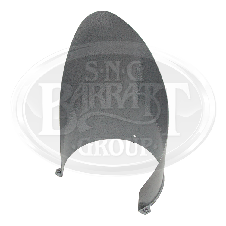

I am looking to freshen up my headlamps and the scoops behind the glass covers look a little bit grubby etc. I've got 2 options, get my local bodyshop to paint them or buy a new set.
Can someone tell me if I buy a new set will they need painting or should they just be inserted as they come? Also is there any trimming etc required to get them to fit? Looking to get them from SNG Barratt

Should you decide to buy new from SNGB, they come painted (hammertone finish) ready to install.

A quick wire brush down, and a can of steel wheels, and you're away for another 50 years !

There is a rubber U section strip that goes all the way around the front of the scoop. This is best glued in place with Superglue prior to fitting.
Pay attention to the positioning of spacers etc on the 3 bolts when you remove them.

And despite what you may think the bolts are attached to the captive nuts on the scoop and then pass through the diaphragm. Nuts are fitted on the wheel well side.

I used hammerite grey or was it hammerite silver.

Originally they were a straight silver-grey metallic, NOT hammertone, unless it's a flat-floor car in which case they are body colour.

As I said in my earlier post, I find a paint called Steel Wheels as close as one can get to the original, and it is very convenient to use, needing no primer
