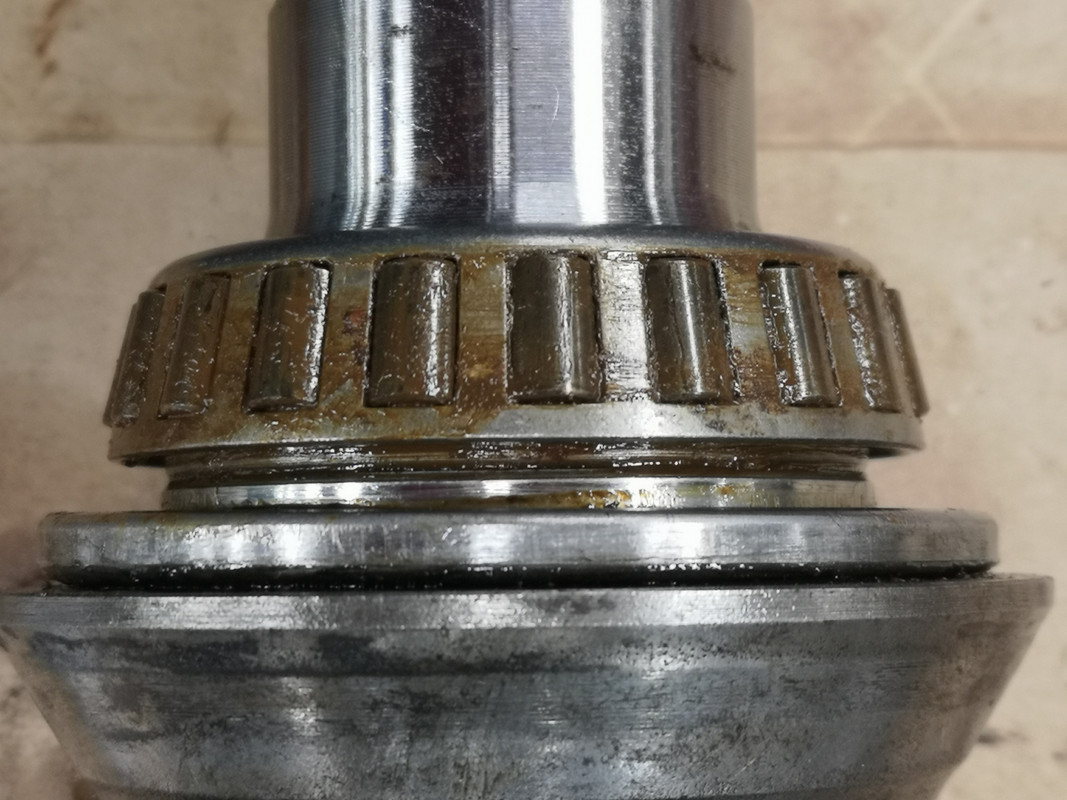

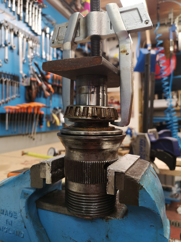

The links on these previous posts are down, so I thought I'd re-float the question.
I'm faced with removing the outer race (closest to the splines) and there is virtually no lip available to go for.
I have in the past resorted to breaking off cages and MIG-welding a couple of blobs onto the inner race so that a drift can get a grip, the immediate heat from the MIG helping recalcitrant separation, BUT it's a bit nasty and it's about time I had a proper clamp-wedge puller like Mich shows.
Everyone seems to sell the same crap sets for under £50, different boxes but same contents, do they actually work or can I spend £150 and find something more professionnal ?
https://www.google.com/search?q=bearing ... 1&dpr=1.25
Could anyone suggest suitable tools they've used for this job ?
There is virtually nothing to get a bite on with my current pairing of bearing and hub.

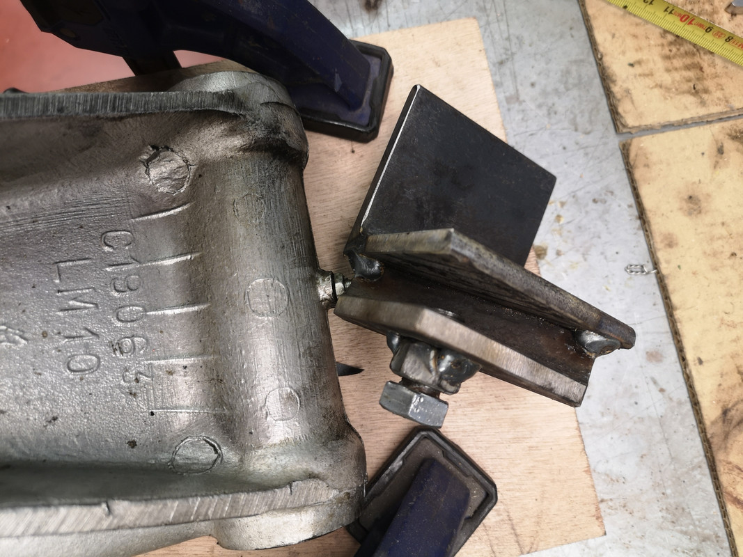

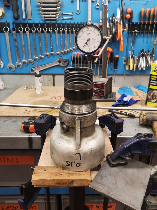

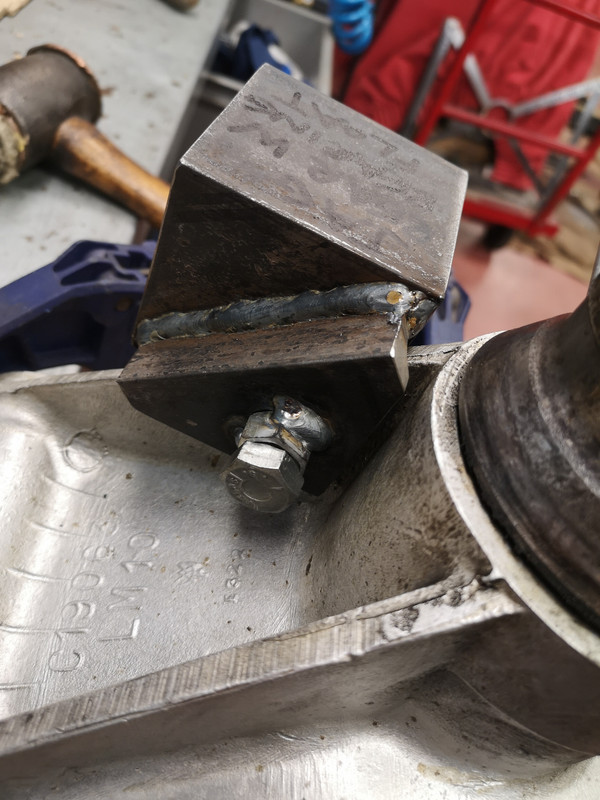

Thought I'd also post some shots of what I've been meaning to do for years, which is make a proper jig to carry the end-float dial-guage, plus a decent slab of marine-ply to make everything more stable
Writing what the stuff does is getting more and more necessary as I'm increasingly faced with tools that were made for reasons that escape me :-)))

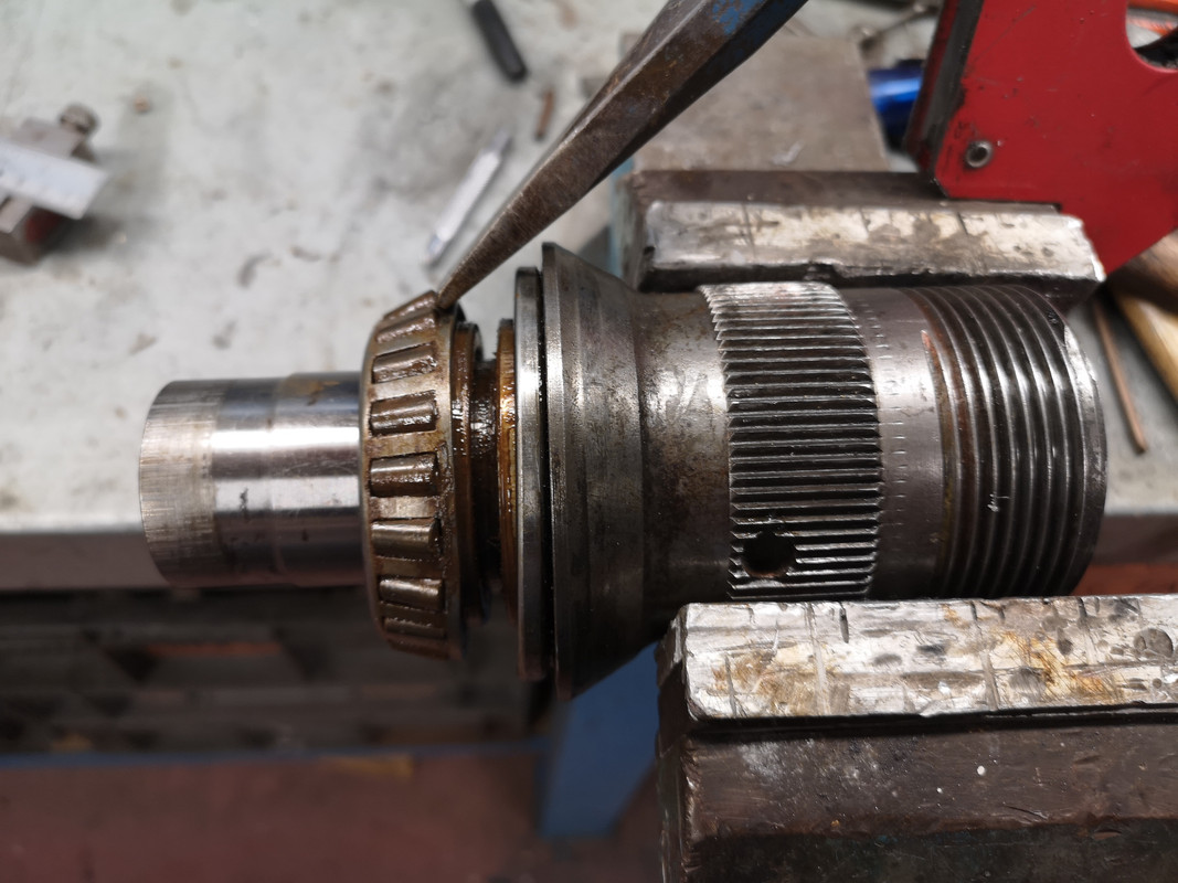

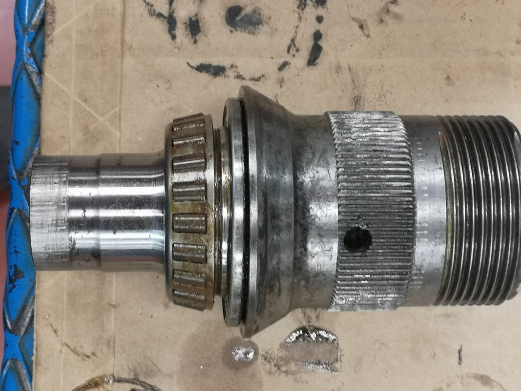

No, the original poster is indeed talking about the complete taper race that sits on the hub shaft, and not the two bearing tracks that sit in the alloy hub, which are indeed relatively easy to remove, as he refers to grinding it off - which is (en passant) quite unnecessary.
Steve's use of the bearing splitter appears to vindicate the cheap stuff on offer, which I will buy as it's about time I had these for other jobs.
However, I believe that even with a splitter it is a better idea to get an initial gap, using a chisel (seen in the picture) on the still-in-place rollers, or failing that - having removed the cage and rollers - directly on the lip, as the bearing splitter then has some meat to get hold of.
With my parts there was not even a vestige of a taper or bevel to help a bearing splitter start a gap.
Once you've got a gap, a simply two-legged puller will get the inner track off - for the efforts required, which you could probably measure in 100's of kilos in my case, it didn't seem worth using the press.
