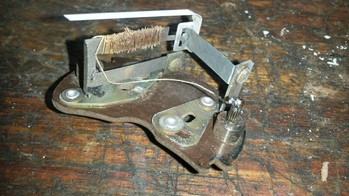

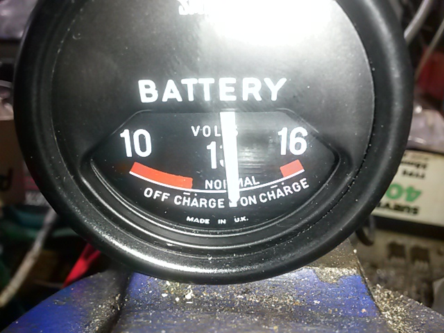

#2 Re: Lying "Battery Condition" / Volt meter
Having opened the Battery Condition gauge, and cleaned the lens, I now have to do the same for the remaining instruments....
BTW: The position of the needle is where it sits after a cold start and having tapped the lens. The voltage was 14.4V on the battery at this time. As the alternator warms up, the voltage does drop back to around 14V and then the needle sits on the "N" of "ON CHARGE" or between the O and N of On CHARGE.
But at least it now stays there while idling with Aircon, fans and headlights on. Only when I pop it into Drive and RPMS drop to below 500 (on the tacho) does it move lower but then the voltage does drop to below 13V as per the multimeter.

Well I'm amazed!! Our great grandfathers knew a thing or two when it came to building cheap instruments out of a few pieces of metal and wire....
Decided to calibrate the Battery gauge (which is a Volt meter really) and found the meter to be amazingly accurate (where it matters), even after 45 years. My respects (in this regard).
Gentle tapping of the instrument housing was required for the needle to find its true position. Probably taken care of by the vibrations in the car.
12V 13V 14V
So, again, it is not the gauge itself to blame, but the position at which it measures and the effect the gauges' current draw (including this gauge) has on the voltage being measured at that location (12V supply to the voltage stabiliser).
12V 13V 14V
