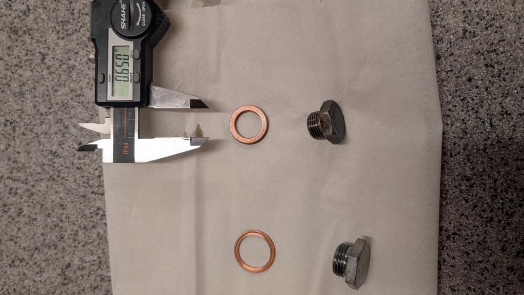

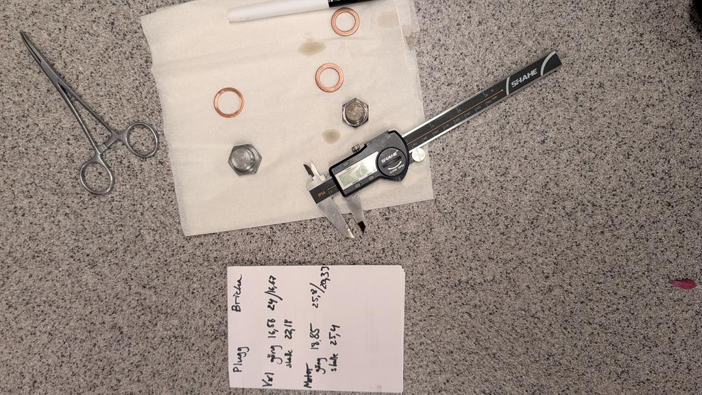

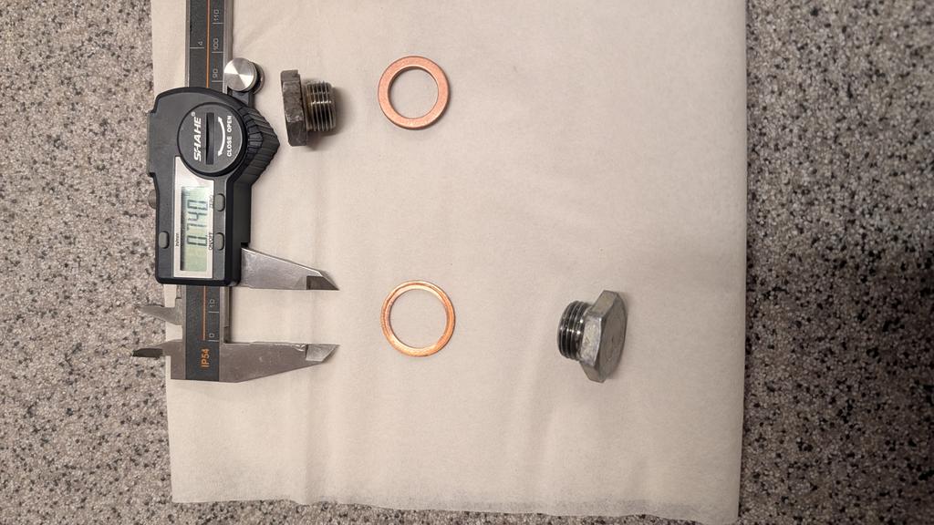

I’ve just commenced step one: changing fluids in the engine (Millers 20W-50), gearbox (Red Line MT-90), and the rear diff (Red Line 75W-90 LS).
Somewhat surprisingly, the copper washers I bought didn't fit the engine sump plug. I assumed it shared the same dimensions as the gearbox drain plug, but my car seems to differ from the workshop manual.
Could it be that a previous mechanic stripped the original sump threads and tapped it for an oversized plug? The head takes a 1" socket and the outer thread diameter measures almost exactly 3/4". (Oh boy, fractional imperial measurements are certainly a learning curve for a metric brain...)
I've attached a couple of photos of the plugs and washers—any thoughts or wisdom on this would be much appreciated!
