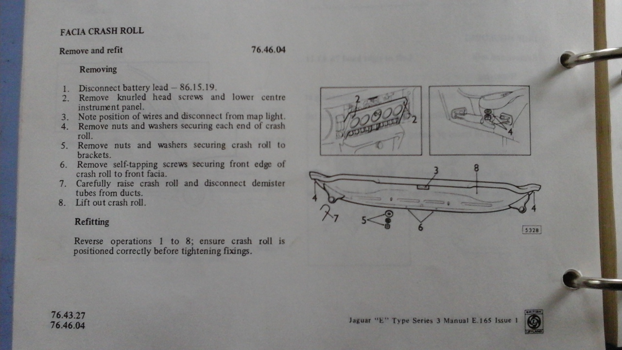

Has anybody removed just the top of the series 3 dashboard as I need access to the flasher units located next to the glovebox on a LHD USA spec with air con blocking access under the glovebox.

Yes you can just remove the dash top.....drop down the center instrument panel to access fixings and far left and right corner there is a fixings....service manual is your friend.....Steve
