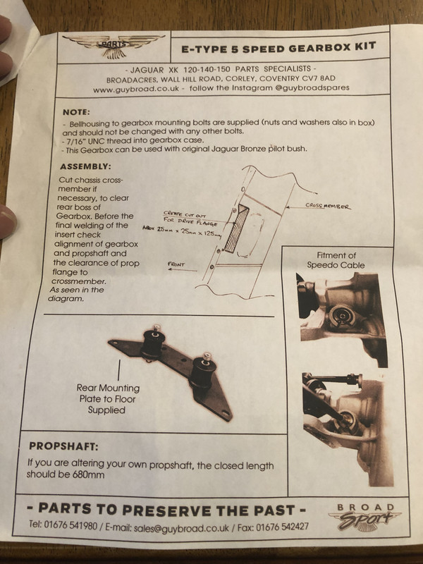

All of you know I can’t sit still so enjoy the instructions!

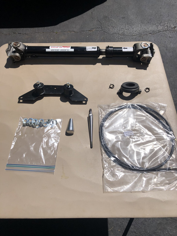

Okay let’s go through the parts that come and DONT come with the kit as we start getting the lift freed up for the E Type!
The pictures include…..
Included…
1.Speedo cable
2.Twin rubber mount tail transmission bracket
3.Brushed shift rod and knob AKA C Type/D Type style
4. Nyloc nuts and washers to hold Bell housing to the gear box.
5. Clutch
Not Included….
1. New driveshaft at shorter length
2. Throw out bearing and clips
3.Pressure plate
4.Transmission fluid sae80w90

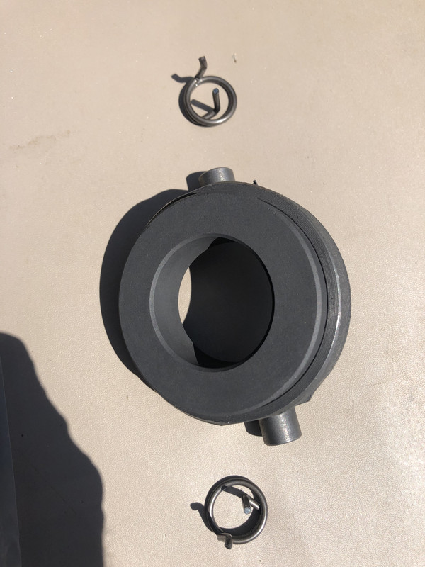

First the Throw out bearing, it’s standard stock jaguar design.
Why I added 3 or 4 pictures is because if you order the same throw out bearing from
5 major suppliers you will get 5 slightly off sizes!
Over the years SNG had the best in overall size and depth.
So in this car we went with the SNG.
I will only say this once…..
E Type repro parts are a huge crap shoot at best no matter who supplies them!
The above part too me gave the best pedal feel and height.
Other suppliers were either to short or too tall creating a funny height pedal and grab. Imho
Gtjoey1314

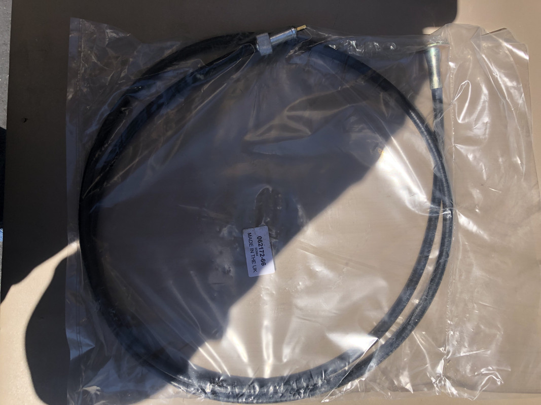

Next , The speedo cable.
Basically standard on the speedo side I will add a dot of clear grease to the cable end.
The other side is completely created for this box .
A stock E Type cable will not work.
Looks trick and clean with the C clip design
Gtjoey1314

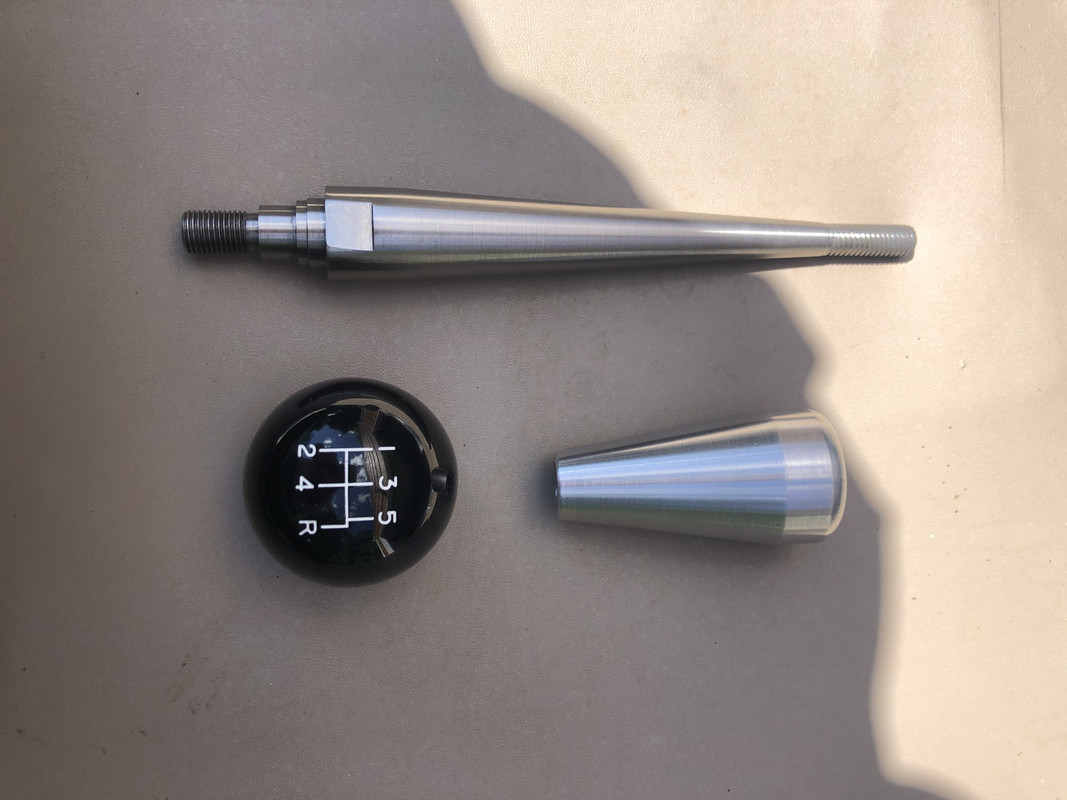

The shifter knob and assembly….
The kit comes with the brushed D Type knob and shaft and It might be a welcome change!
But I had 3 shift balls from
Other applications
The left is too small and the finish is terrible
The large black and white is way too big!
The right one is a hair bigger than stock but really as good as it gets!
That one I think was SNG from years ago
It will be a toss up from stock to brushed pistol
Shifter
Gtjoey13-4

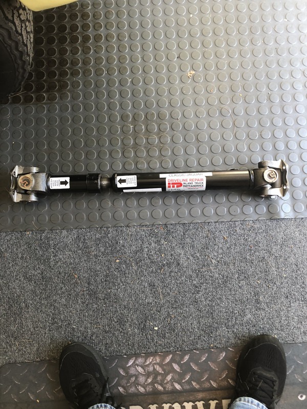

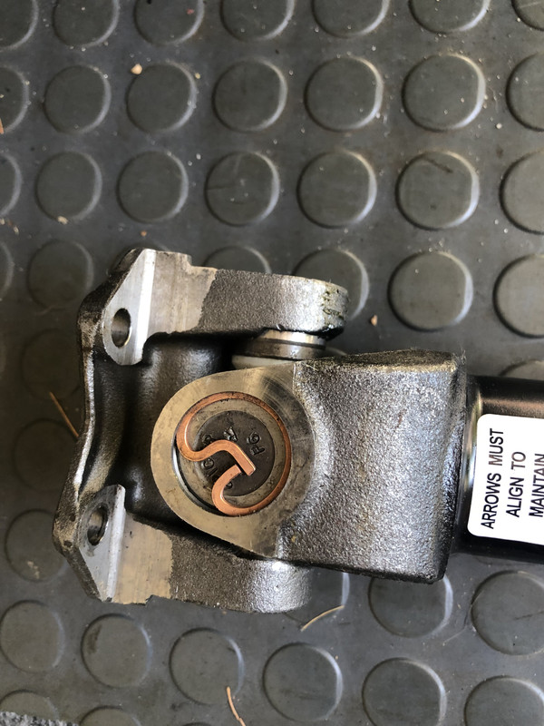

Lastly for today the driveshaft and the Nyloc nuts and washers for the bell housing.
The nuts and washers are self evident but later inspection will reveal 7 studs to the box not 8!
This is due to the fact that the throw out arm needs more room!
The drive shaft is a work of art.
Custom made with new U joints leaving us NO guess work at all!
It’s so heavy duty putting stock to shame.
It all adds up to a much better driving car!
Gtjoey1314
Gtjoey1314
After installation the speedo will require calibration as it will be 10mph out.

Danny , due to the gear in the box?
If so 10 mph faster or slower?
Since I put a 307 rear I didn’t calculate the speedo yet!

1. You may want to go with the D-Type shifter as I found my knuckles hit the radio console with the stock knob because of the way you grab it.
2. You may want to get a standard flywheel balanced at the same time as the lightweight one. I find E-Type's with lightweight flywheels jerky to drive and do not match the smoothness of the 6 cylinder engine.
Look forward to your experiences Joey as are a few people from J-L who are missing you :yellow:

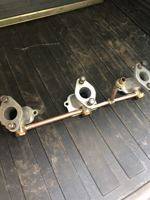

I’m picking up the Carbs for the Aceca today!
Hopefully the Etype is on the rack by early next week😀

On mine it was reading 30mph while real speed was 40mph. That was with a standard S1 3.8 rear diff In fact it had to go back to Guy and took three weeks of waiting for the chap who does calibrations to return the speedo. Also there was a problem with the installation of the alternator on the conversion from Pos to Neg earth that caused the car to chew up belts which they had to fix.

Yes….. it was all cleaned . Beaded and tumbled but we spared the polishing wheel on the top hats and all.
Jets, bushes , needles all new .
Thank you again
Gtjoey1314
