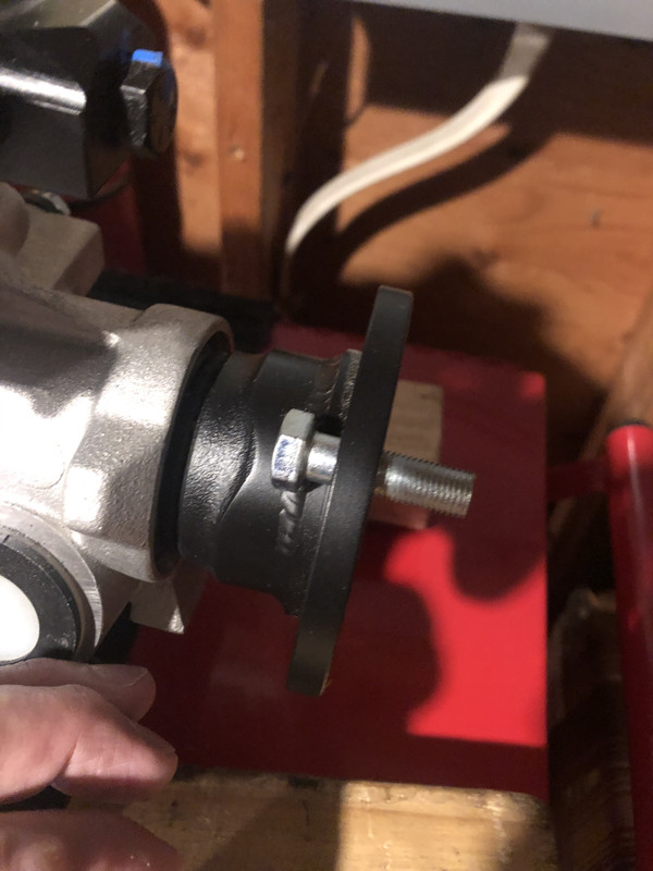

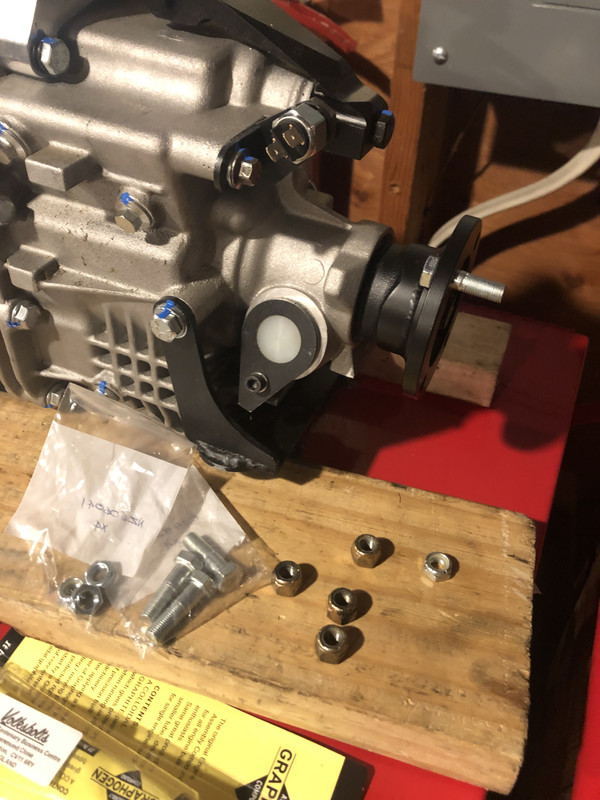

What say you?
The output flange is longer so you can just slide new prop bolts.
The Supplier added nylons but I feel
They are too shallow?
I’m going to use mine , the longer nut with more lock.
I doubt the higher nut will bind
It never has before.

I'd be fitting new bolts with new nylocks, not reused old ones. And I'd keep the nylons for activities inside the car.

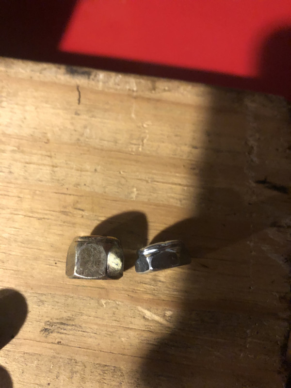

#170 Re: The 5 Speed is here……..
My bad
I’m not using the old nut
I meant the old nut size compared to what came in the mail
The old one is deeper look close
Thanks Chris
Gtjoey1314
Thanks Chris
Gtjoey1314
#171 Re: The 5 Speed is here……..
Agreed. The deeper nut must be better.

I agree that those supplied nuts look too shallow. Not including the nylon insert, how many threads are there? You want at least 5 although any more than that is not particularly beneficial. Are the nuts & bolts the correct 'T' grade?
You can always check for clearance around the nuts when you get it all bolted up.

I agree , Supplied by SNG, I usually go grade 8 but might be overkill.
Im going back to the hardware store today for the longer nut.

Grade 8 is definitely not overkill. Grade 5 is lower strength than British T rating, grade 8 is slightly higher so stick with that - they're doing an extremely important job.
Remember to torque them up properly and don't lubricate them beforehand. I can't remember the size, are they 5/16" UNF or 3/8" UNF?

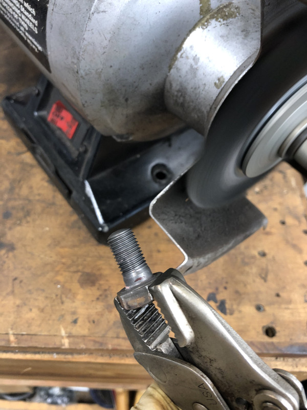

#180 Re: The 5 Speed is here……..

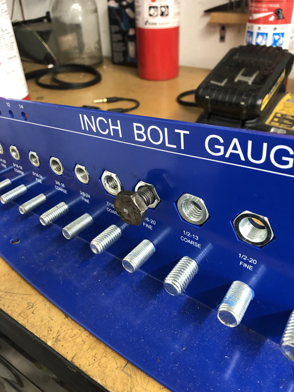

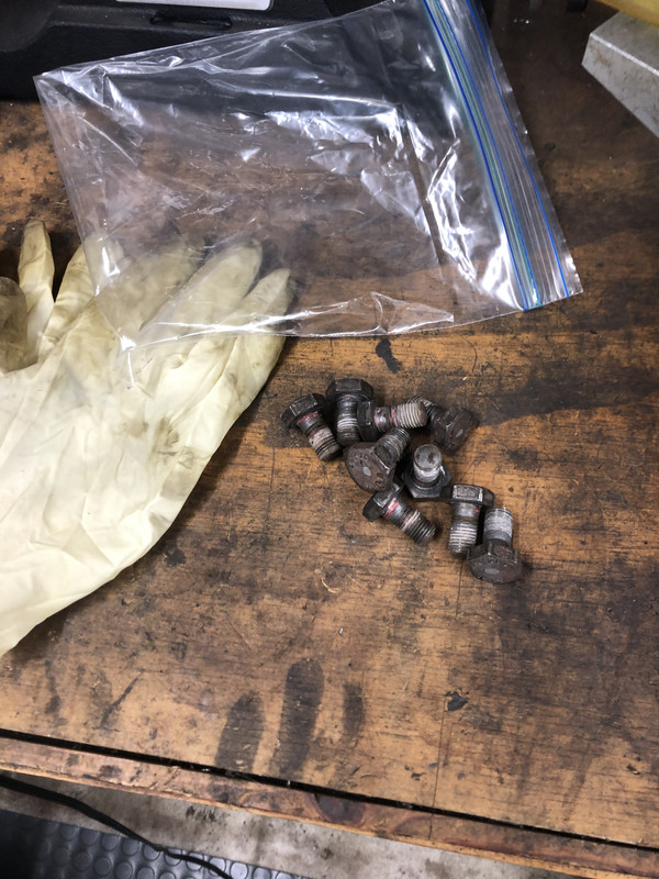

I can’t help the pictures out of order
So we wheel and chase all the threads of old lock tite
The blue standard and metric board were from the hardware store
I asked if I could buy one and they called the dealer!
Great for chasing bolts and knowing what you got!!!!
Then chased the bolts to the crank it’s all very clean and smooth.
A couple of dots of high heat red when assembling and all should be good
The torque is still 67 pounds
We shall see
