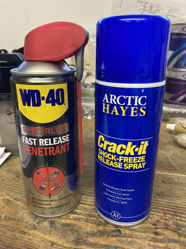

Just picking up on Stuart’s post #10 regarding expansion/contraction, another good “tool” to free stuck rusted items is the “Crack-it” freeze spray which works by shock freezing the items. It also contains a powerful penetrating oil which literally can be heard to crack the seized item’s joint.
There also have been comments about the suitability of WD-40 regarding its penetrating oil ability. I agree with that comment on the “normal” WD-40, but that brand also produces several “Specialist” products - one of which is a fast release penetrant.
I have no allegiance to either, other than being a satisfied user.

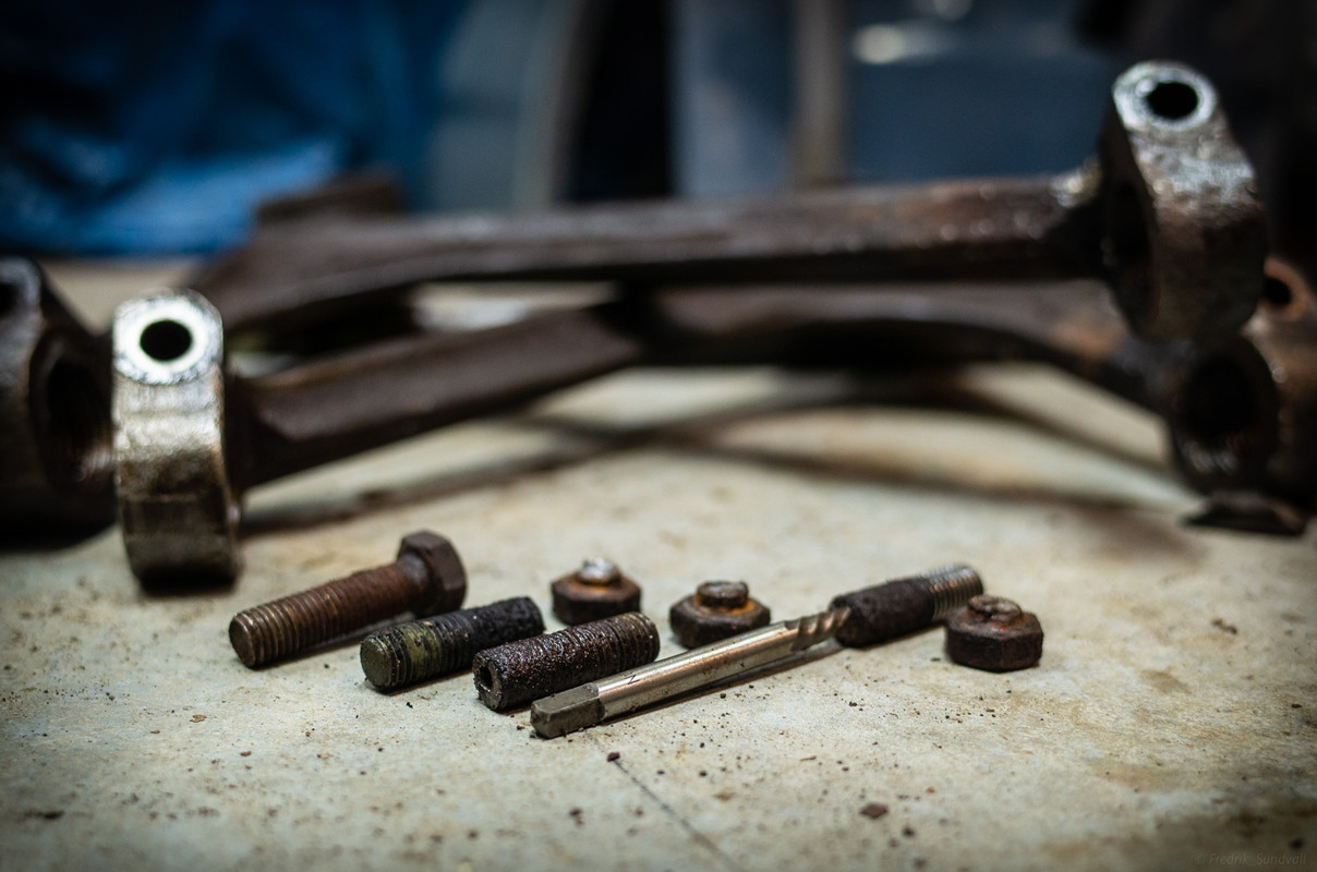

...and the winner is: Autoalain! Many thanks, the vibrations really made the difference. I went overboard and used an air chisel hammer where I blunted one of the tools. As soon as I stopped, the bolts went dead again. This is with heat and proper rust penetrating oil applied over a few days.
Cheers! Happy New Year to you all! May your 2023 be as good as my 2022 just got!

A method I have successfully used is putting a nut over the stub and with an arc welder set highish push the rod down the centre. This has a twofold effect of giving you something to get hold of and getting the shaft extremely hot. This works on cast iron where direct heating is ill advised.
