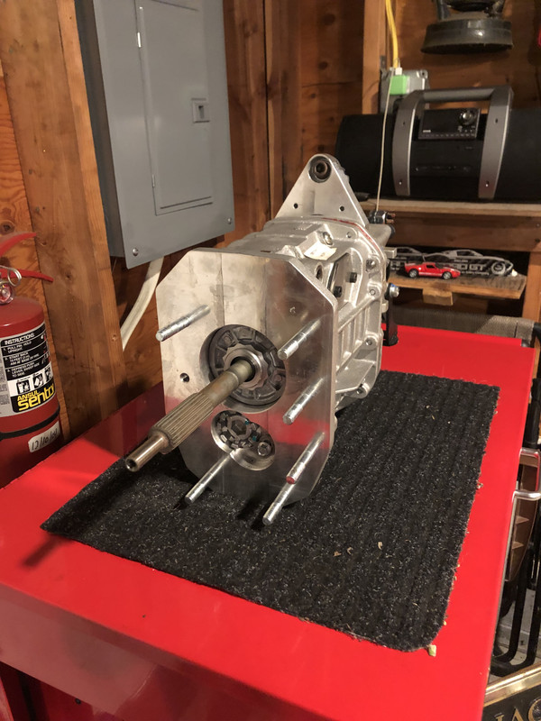

#109 Re: The 5 Speed is here……..

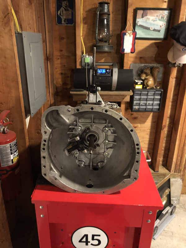

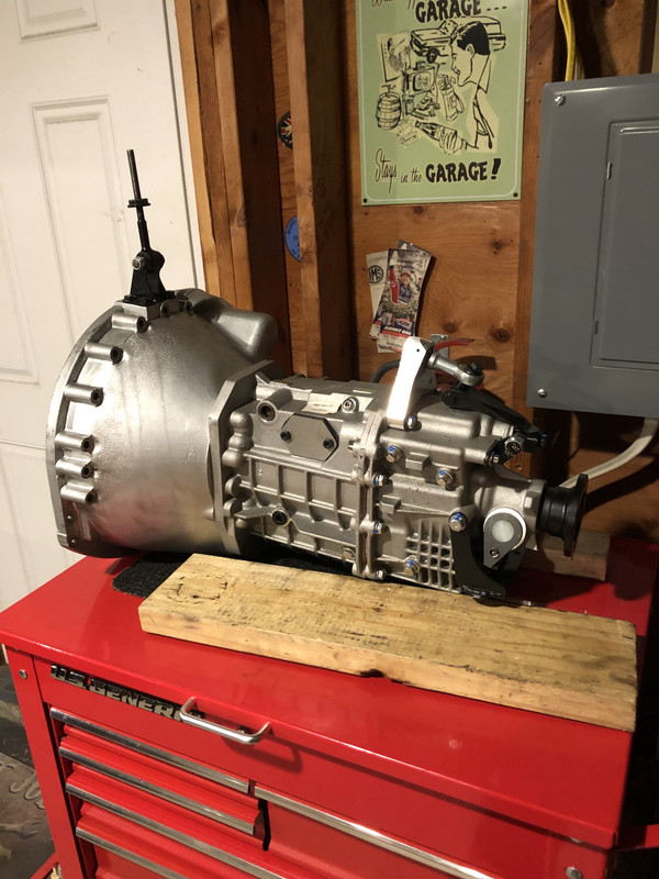

Post by gtjoey » Wed Aug 10, 2022 11:12 am
Let’s do it…..

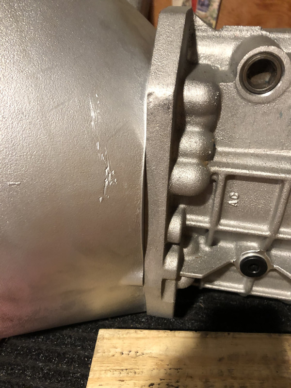

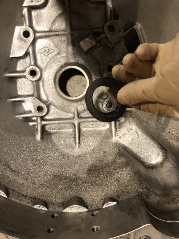

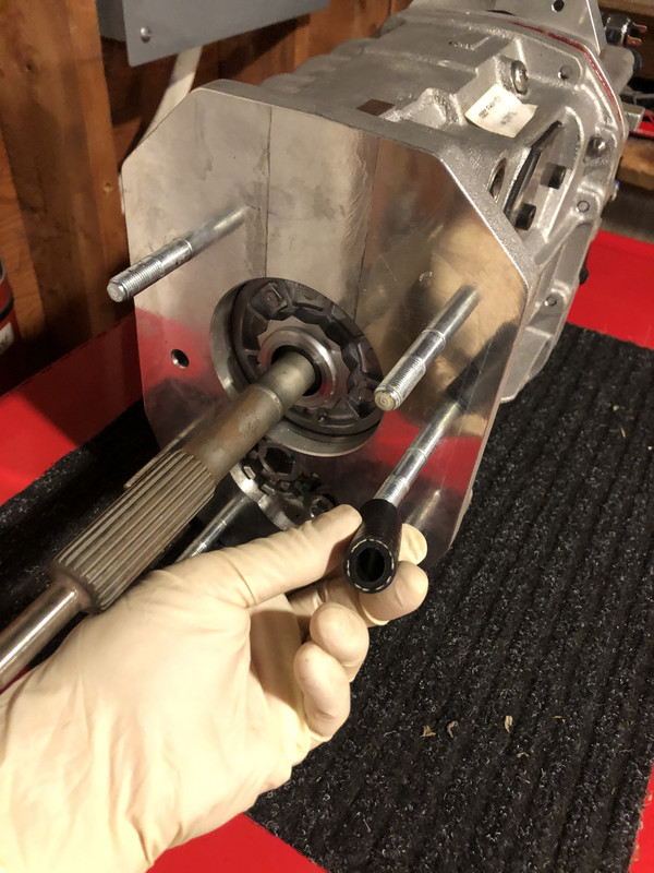

The transmission is completely converted with the exception of fluid.
Let’s review

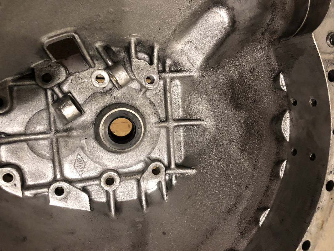

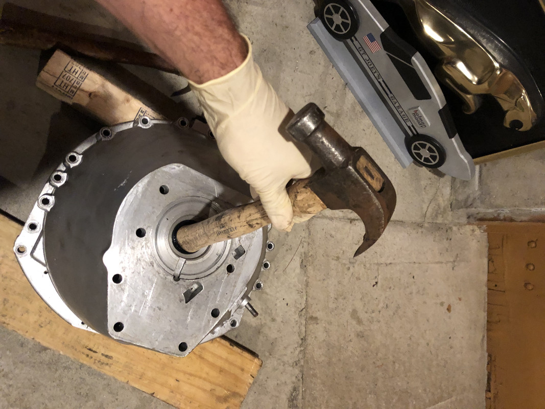

The bell housing is used from my original 4.2.
The inner dust seal is removed as per Guy Broad.
Once punched out , raise the base of the unit and the old bellhousing just slides over the unit which had studs installed.
It’s very clean and neat!
NO in between gasket is needed between the casing and bellhousing because this is a sealed unit.

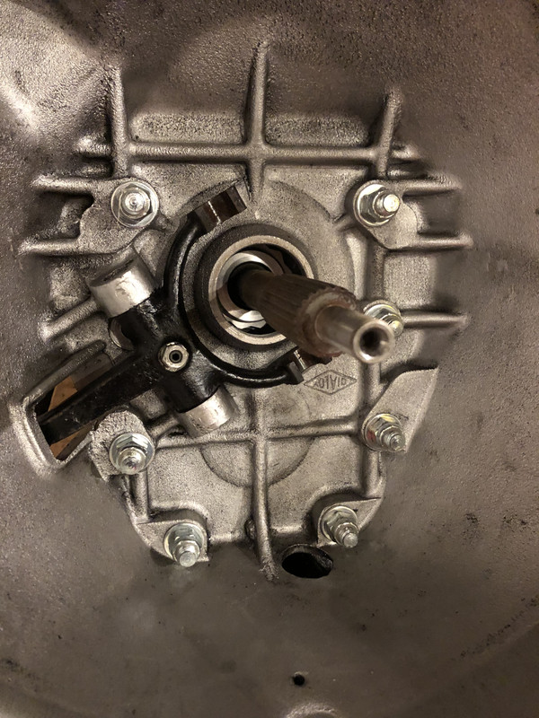

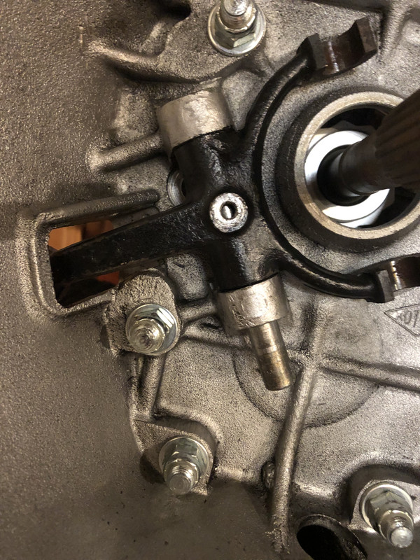

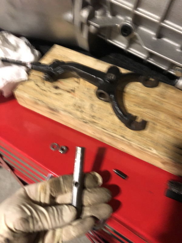

Next comes the clutch fork.

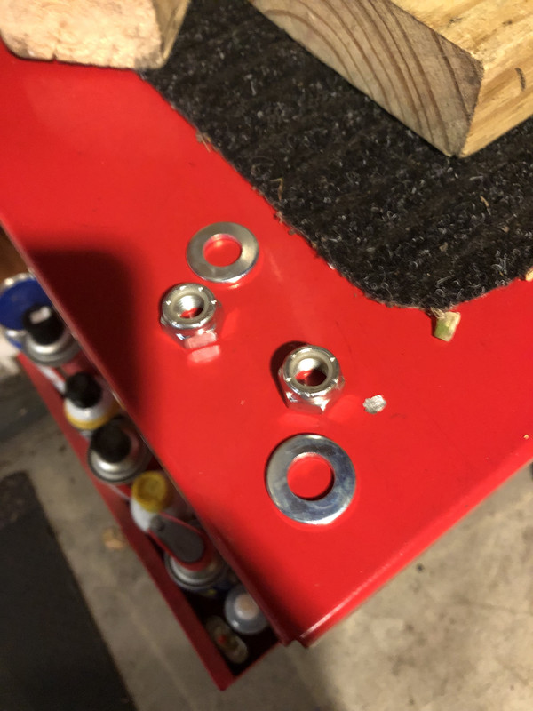

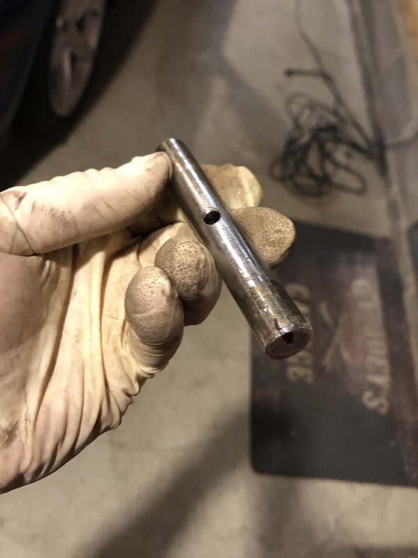

I personally waterproof grease the shaft and mark it so when you tap it back in it lines up with the lock in Allen key stud! It then has a lock nut and washer to keep in place.
Follow the pictures
Any questions just post!

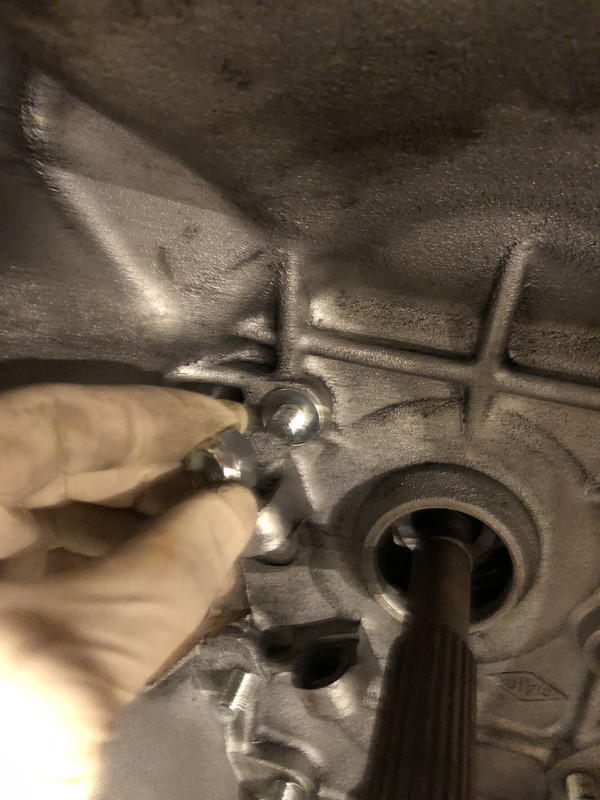

Note eighth hole purposely left out for the amount of fork throw!
I can’t help why pics are out of order but you get it
gtjoey
Posts: 604

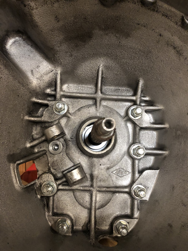

#112 Re: The 5 Speed is here……..
Post by gtjoey » Wed Aug 10, 2022 11:21 am
I took shot of pin NOT lined up look close
You turn the pin till you see the hole
Then the stud will screw into the opening
Then use lock nut and washer!
gtjoey
Posts: 604
#113 Re: The 5 Speed is here……..
Post by gtjoey » Wed Aug 10, 2022 11:23 am
Done!

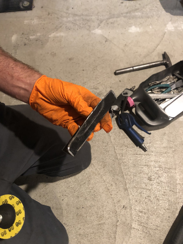

#115 Re: The 5 Speed is here……..

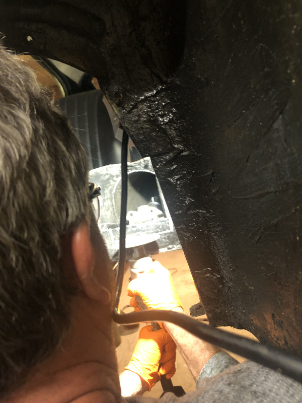

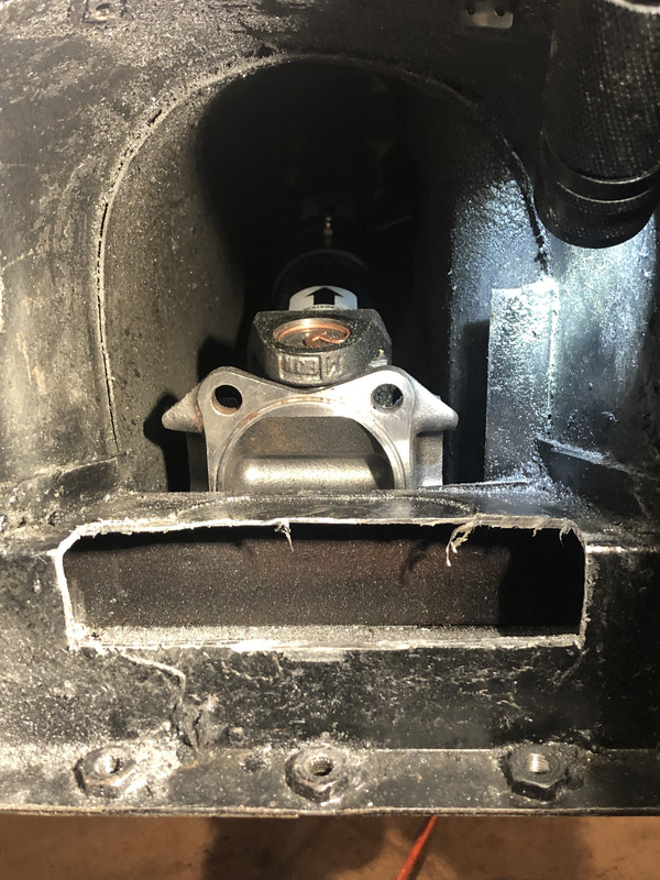

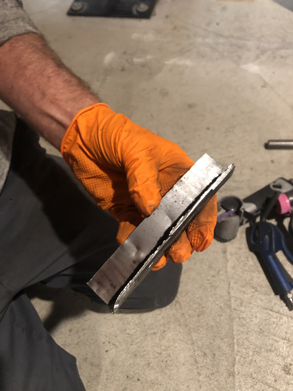

Post by gtjoey » Wed Aug 10, 2022 8:46 pm

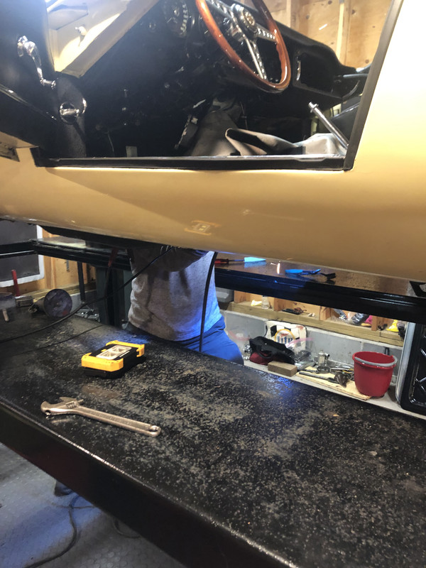

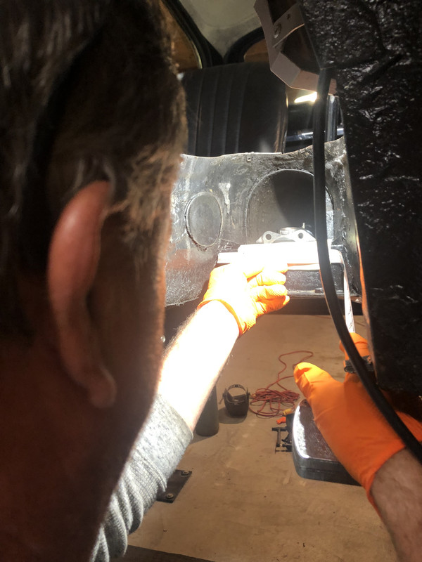

Just got home….

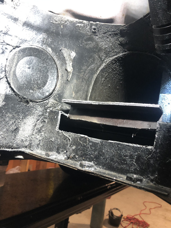

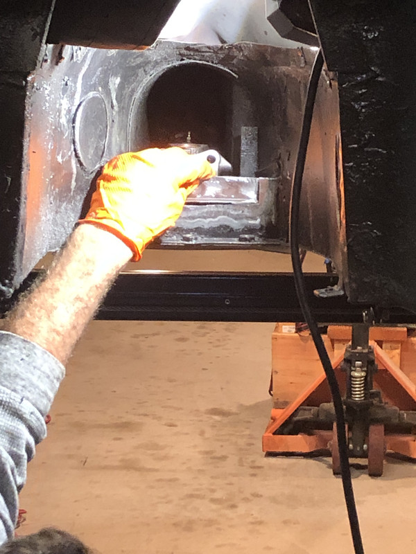

The directions say
5 inches wide, 1 inch down and 1 inch back.
The goal here is to make 1 perfect cut, flip it to invert
Weld it nice then bury it in paint and undercoating!
We shall see …. Give me a bit.
Gtjoey1314

#117 Re: The 5 Speed is here……..
Post by gtjoey » Wed Aug 10, 2022 10:04 pm
Purist cover your eyes!
It’s a double flap layer so if your catholic this cut isn’t so bad😀
