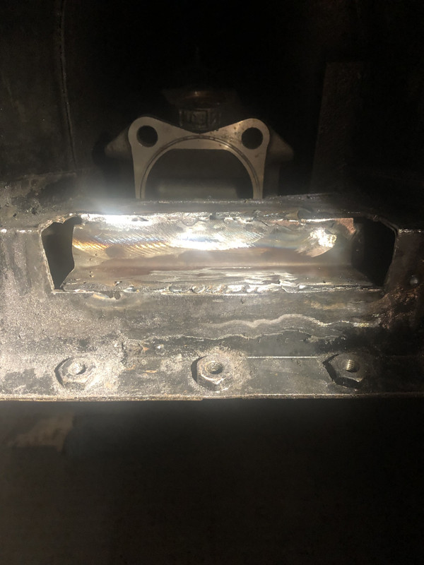

Post by gtjoey » Wed Aug 10, 2022 10:29 pm
Bottom beaded up
Another half hour we should be done

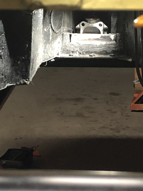

Post by gtjoey » Wed Aug 10, 2022 10:45 pm
Rough weld not bad

#124 Re: The 5 Speed is here……..
Post by Rocknjag » Wed Aug 10, 2022 11:57 pm
Great place for a mouse to make a home
close those two openings up, lol

#125 Re: The 5 Speed is here……..
Post by gtjoey » Thu Aug 11, 2022 12:35 am
All done just for you

Don't worry Joey, most of us here are "stiff upper lipped" Brits. We don't get excited or sycophantic about these things. We just quietly get on with it.
Keep up the good work although your welding has me worried. Well, you did prompt for comments.

#132 Re: The 5 Speed is here……..
Post by gtjoey » Thu Aug 11, 2022 10:15 am
You guys are great!

gtjoey
Posts: 604
#133 Re: The 5 Speed is here……..
Post by gtjoey » Thu Aug 11, 2022 11:22 am
P.S.
The welding was done by my life long friend
Born and raised in England.
He was between pints when he dropped by to do the work😀
I wanted the British touch, if I wanted perfection I’d find a German but that’s too boring😀

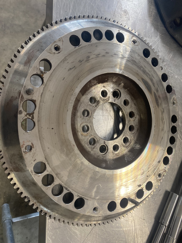

The flywheel is being worked on
Cleaned up, mated to new clutch and pressure plate!
Note Guy Broad box has there own clutch spline set up
C j is letting me use the alignment tool then I will send it back.
Almost all good to go👍🏾

Post by Dal » Sat Aug 13, 2022 2:14 pm
Joey, I read that a lightened flywheel can create some noise, vibration, juddering at idle and in first gear at low revs. I think I saw it on the “Driven man” website. What is your experiences. Love your modifications on a etype that is intended to be driven!
